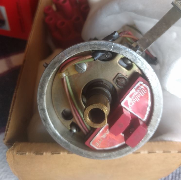

Not every distributor corrodes like my MSD did. Observe here my old Mallory that I ran for like a dozen years. It's been sitting in the same garage, as my car with the MSD, in a cardboard box the remaining 20+ years. That metal never corroded and it hasn't yet....
