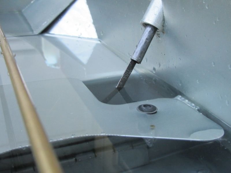

I want to carry as much oil as possible.
This pan is advertised with 6qts.
It will replace my Milodon pan, which is 1" deeper and hangs out under the car.
Had several ground contacts, car is lowered a bit. Now i go for stock dept with this Moroso pan.
In the Milodon pan I could only fill around 5 Liters.
Now this one takes less, 4,5 Liters for a 502 engine sounds to less, doesn´t it?
With the old original oil pan it wasn´t more either. That´s why I thought there could be a wrong dipstick in it.
Here is where the original dip stick comes out.
1" under the lowest point of the gasket is the full marking.
Because this pan come with 1/4NPT thread I had to make a fitting do work with the original pipe.
There is a compressable O-ring inside. I hope it wont leak
I will fill some Water into the pan and see how much it can take, good idea.
I think I can fill the pan until the "L" of the Full marking.

ok, this ist the level with 6 liters in it. So 6qts should come out at the full marking.
Everything alright.
