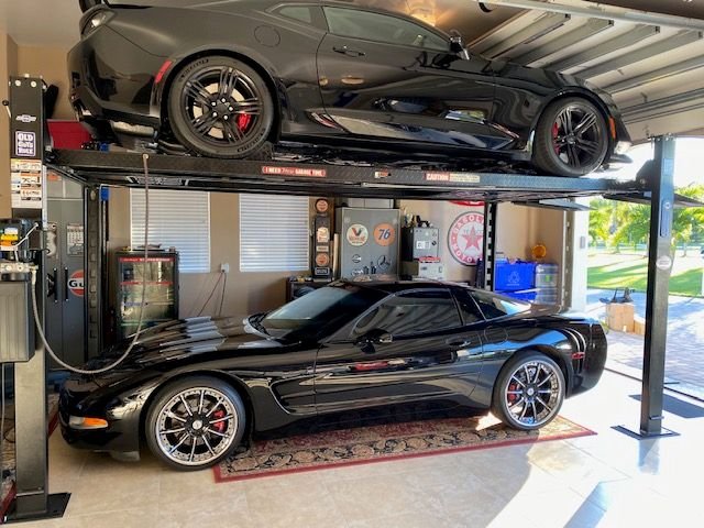

I have that very lift. It is a great product: made well, sturdy, and 'friendly' to use. The gizmos that allow you to roll the lift to wherever you want is certainly a useful feature. Once you go thru that process, it's pretty easy. Don't use that a lot, but it is really important to have it for positioning the lift EXACTLY as you need it...especially if space is at a premium. Also useful when you want to clean the floor.
It's well made, but follow directions closely. The instructions are complete, but 'explanations' as to the importance of some steps is lacking...so don't pass on any steps you think are not necessary.
Lastly, I would tell you that whenever you use a lift, ALWAYS position the lift rails on the positive stops--NEVER do work underneath with the lift being held only with hydraulics. If a hose instantly fails, you are TOAST. If it fails while moving up or down, you can release the lock-lever in your hand & it will [hopefully] lock-up on the next detent down. But at least you are not under it.
Oh, if this unit is thru the same company as mine, you get a couple of 1/8" thick steel drip pans and one 1/4" thick steel pan. You can actually stick a floor jack in the 1/4" one for some extra support help, if you need it. The bridge jack is a MUST. I got just the pump type jack (less money), but would choose the power bridge if I did it again. I also ordered another drip pan, just for grins.

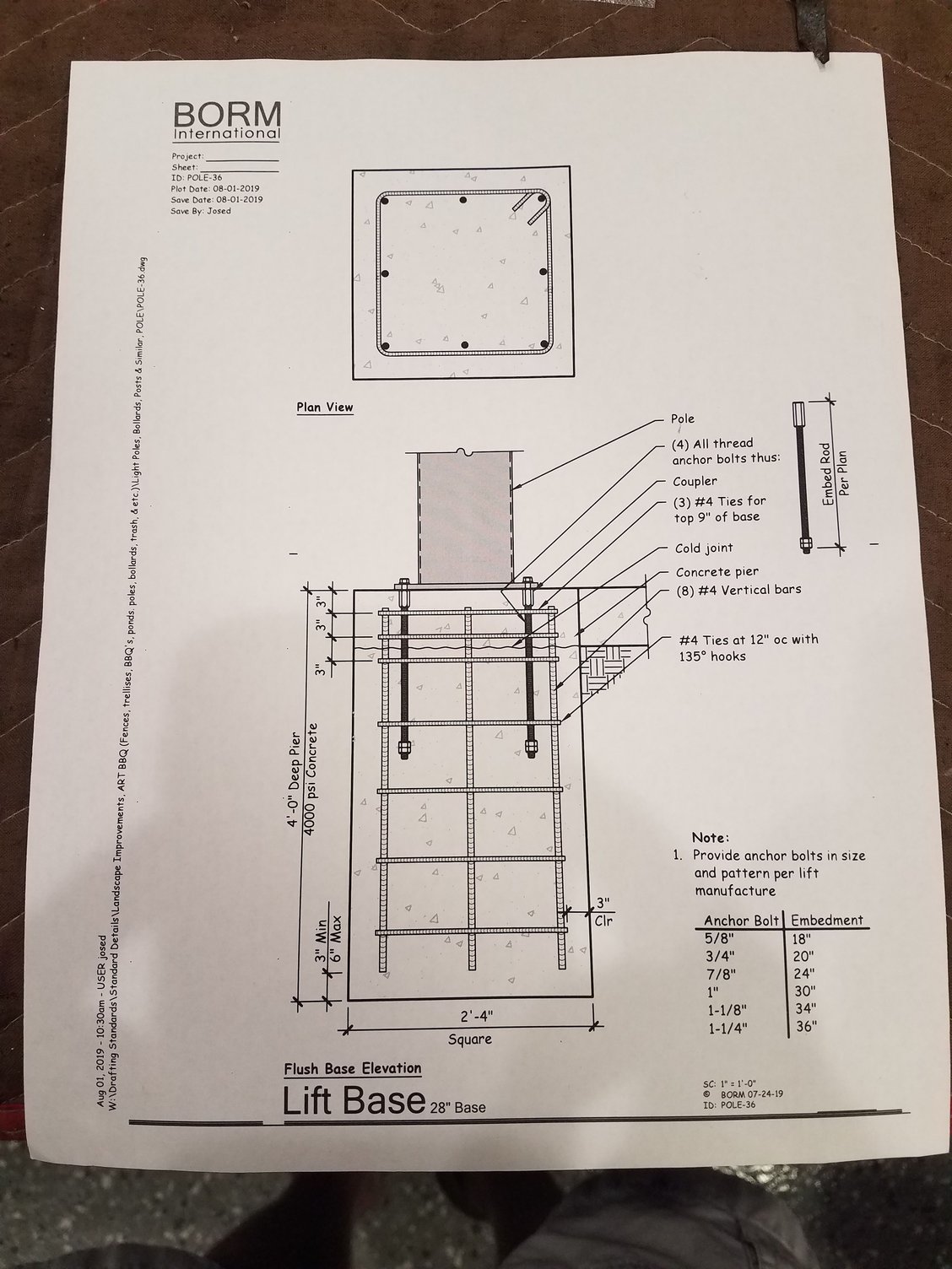

This design was made by a forum member, and works for 5 tons in my earthquake zone.
Two posts need a 6" slab minimum , but if you dont have one Bendpak will hit you $300 for a drawing like this.
