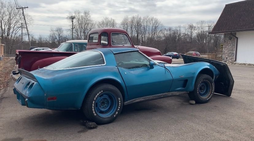

I know, there is a power out difference. Vs. testing an engine on a dyno machine and throttling the choke on the test stand. What are the pros and cons to not performing an engine dyno?
489 big block. The computer numbers say around 550 horsepower.
C3 Corvette I brought off Facebook marketplace. My plan is to put some giddy up in this C3.
