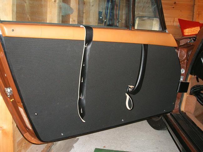

Thanks! That's along the lines of what I was thinking. I've considered lexan side windows but the only company I could find that makes them charges about $400 to $450 for the set. Eventually that's in the works but right now I need that money elsewhere! This is a picture of this kind of setup on a Porsche from the PelicanParts forum:
I'm a big fan of the Colin Chapman "Simplify, then add lightness," philosophy, so this really appeals to me on a lot of levels.
