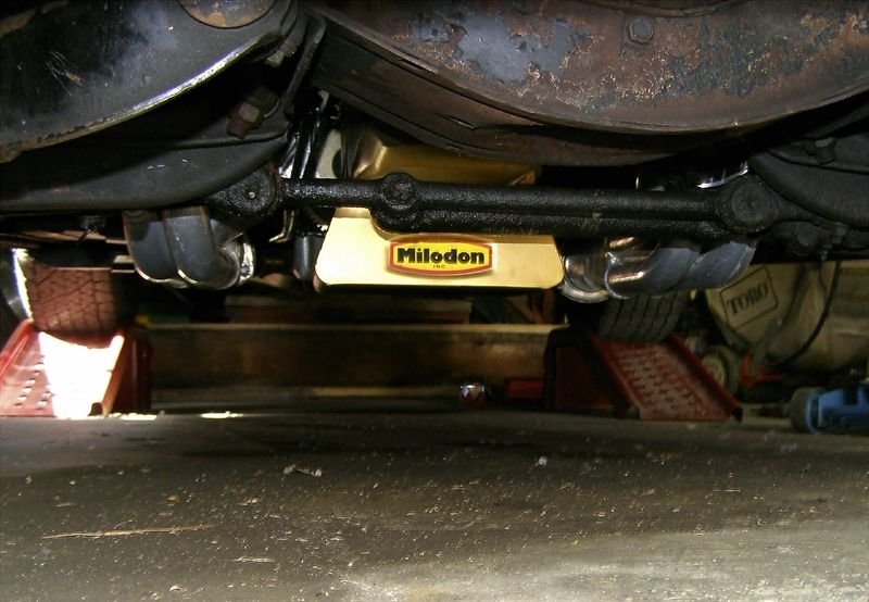

I've run the Milodon #30908 Stroker Low Profile pan.....on a 383 and later on the 427 sb. Extra capacity without the kickouts. This one........https://www.summitracing.com/parts/mil-30908
Pics.......
