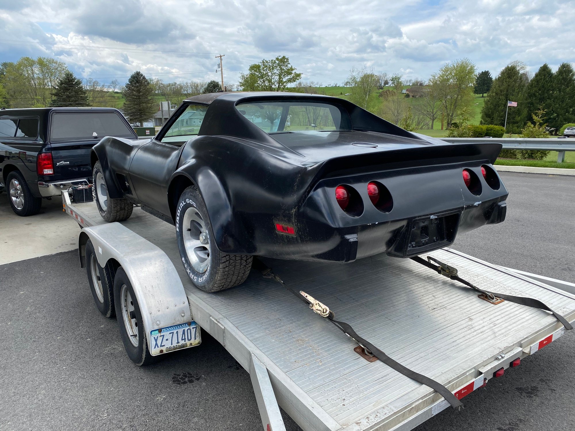

Heres my flares

Yes, those will easily clear the e-brake with no modification. 4" BS means they will stick further out, not in, so you will be fine with inside clearance. I don't know how wide your flares are and if you want the wheel/tire tucked inside or not. That would be the next question for you... and only you can take the measurements to see.
Seeing your pic now... are the wheels on it 8" wide with 4" BS?
i havent checked the wheels currently on the car yet. but i believe they are 8"

i measured the wheels on it in the pic today. they are 9" with a 4" bs. looks like a 12" with a 4" bs will just about make it
