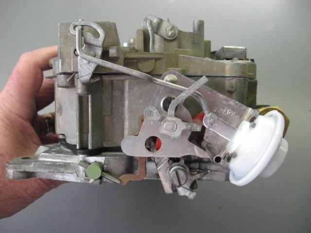

ing at a rochester 4bl 69 corvette 350 a/t carb i believe. I see no provision for a choke? did it have one? Or is this one just missing?

I believe the lever that is hanging free in the foreground of the pic connects to the thermostatic choke coil mounted on the manifold.

First, Rochester does not have a 17029202 carb number. The '69 carb number should be 7029202.
The 7029202 is a 4MV carb, which means it's a divorced choke. The choke is contained in the carb, but the choke coil for actuating the choke is "divorced" from the carb and is part of the intake manifold. The correct 7029202 carb should look like this. Photo shows the choke in the wide open position:
Choke actuation linkage looks like this:
