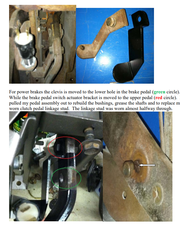

I have a 73 convertible with a transplanted 1969 396. I recently helped a friend buy a 1973 coupe with 61K original miles. It has AC, power brake and a telescopic tilt steering wheel. I would like to duplicate the power brake on my convertible. What part is different on the coupe brake system I can get to install the power brake set up on mine? I am thinking the rod from the cockpit to the booster. Any help is greatly appreciated. COVIB project.

  • If you have really tall valve covers on a big block they can interfere with the factory brake booster.
  • power master cylinder has a different bore size 1 1/8" for power 1" bore for manual (cant use a manual master on a power booster)
  • the brake pedal switch actuator bracket is different
  • the hole in the firewall for the clevis rod is lower and wider
  • the master cylinder lines to distribution block are different
  • the upper booster mounting studs need holes drilled.
  • get a booster to firewall gasket to use as a template for drilling the upper booster stud holes
  • get a matched booster and master cylinder combo for your year so the booster push rod is correct
  • vacuum hard line, hose, filter (if used) and intake/carb fitting for the vacuum line to the booster
Pics from when i did mine:
