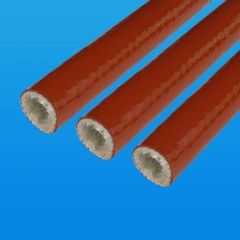

My fuel lines are inside a insulated hose cover with a Silicone Fire Protection (...) I ran the tubing insulation an 99% of the hose and the fire proof stuff inside my engine compartment.
That seems a wise idea. What insulated hose cover did you use ? Only inside the engine compartment ?

Ah, I'll bet you're talking about this stuff...
