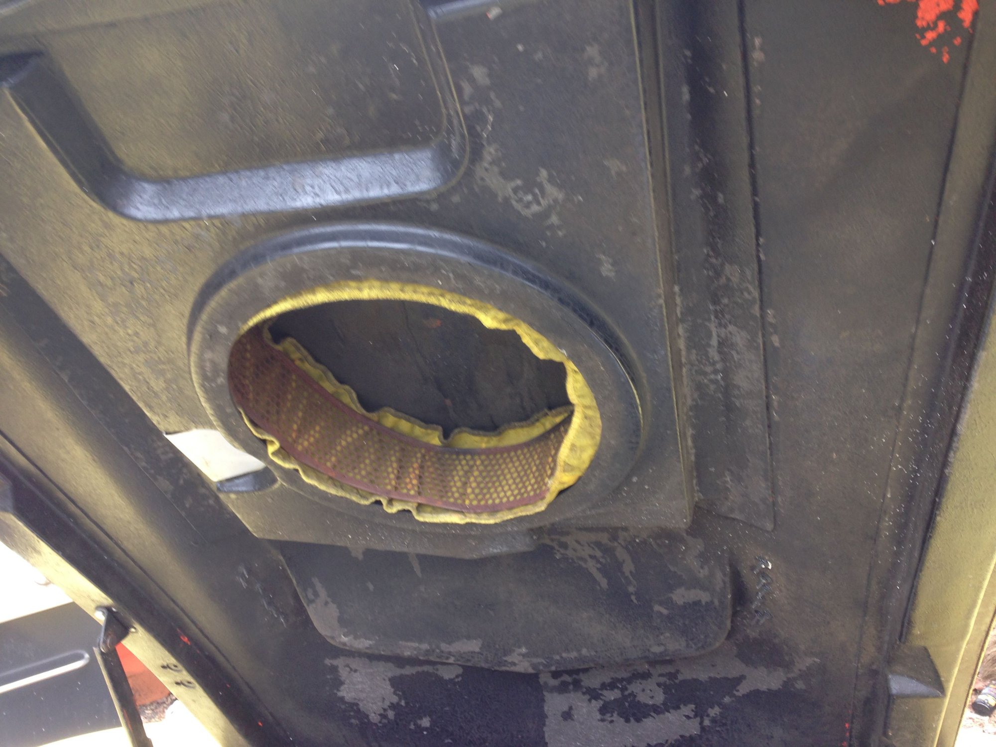

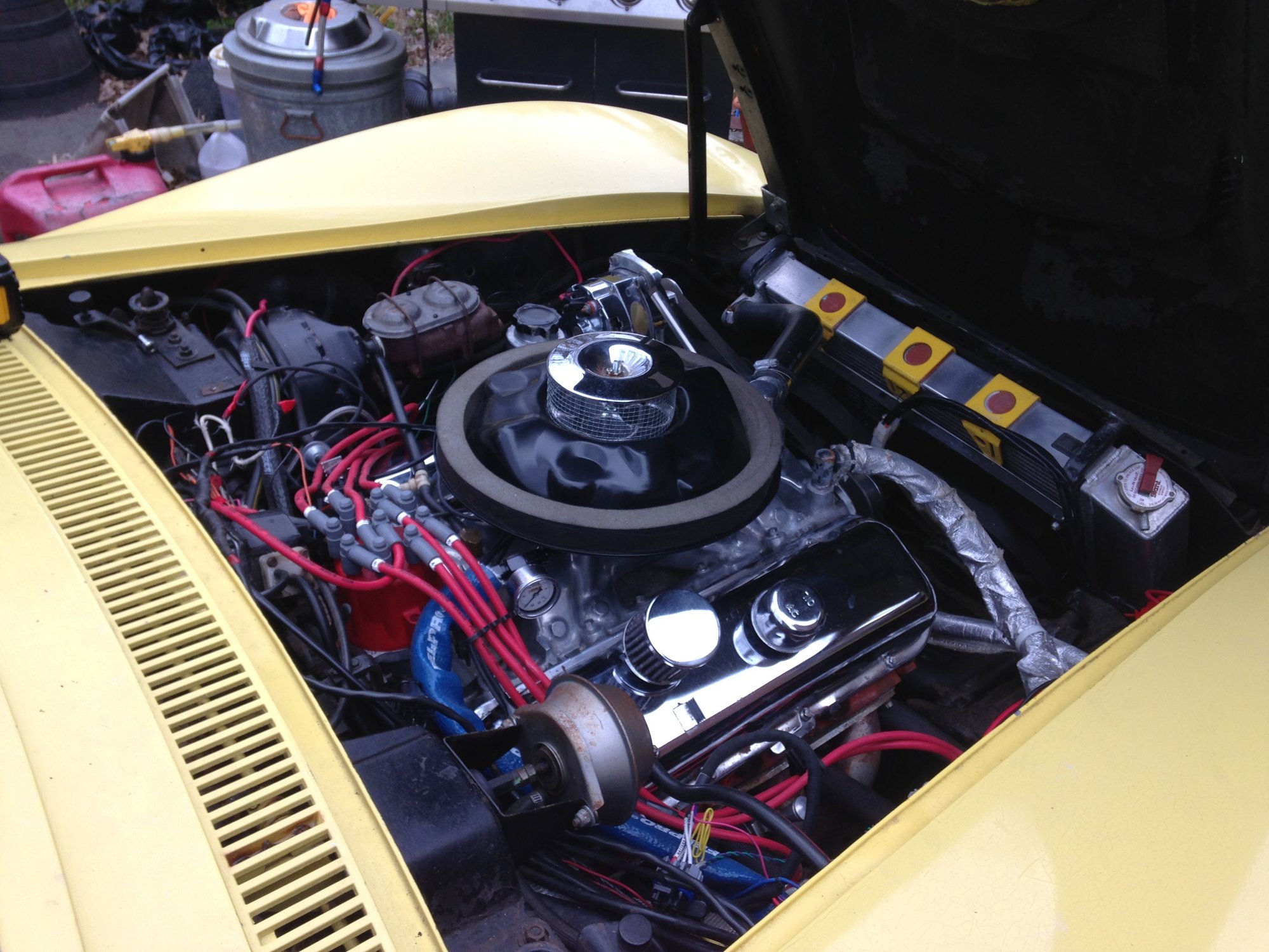

I think I have figured out the picture part better so I will post my very first picture on this Forum!!
This is the new Sniper Stealth 4150 installed on my 1968 427
This is where the hood seals to the plate mounted on the Throttle body
I guess I need to read how to size them appropriately.. Yes, my hood looks terrible but it is a authentic L88 component and I don't want to make any huge changes to it. The heat from my engine is what is killing the paint under the hood.
I will post more pictures once I know more about how to do it properly.
The first picture is what my Corvette looks like with the Holley EFI system. The blue hose cover on the fuel lines ends at a Fuel pressure Gauge which is a dead giveaway that it is fuel injected.

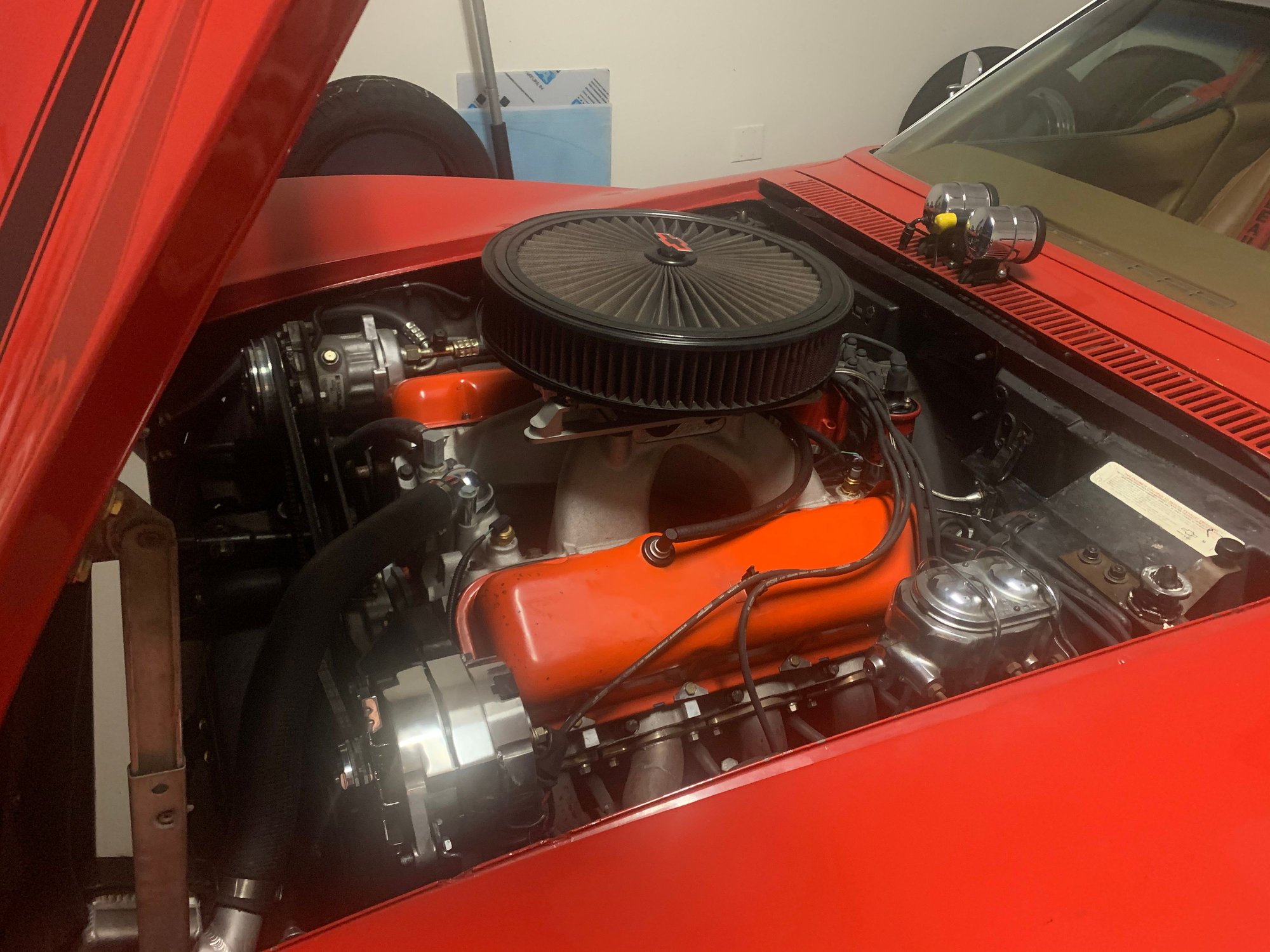

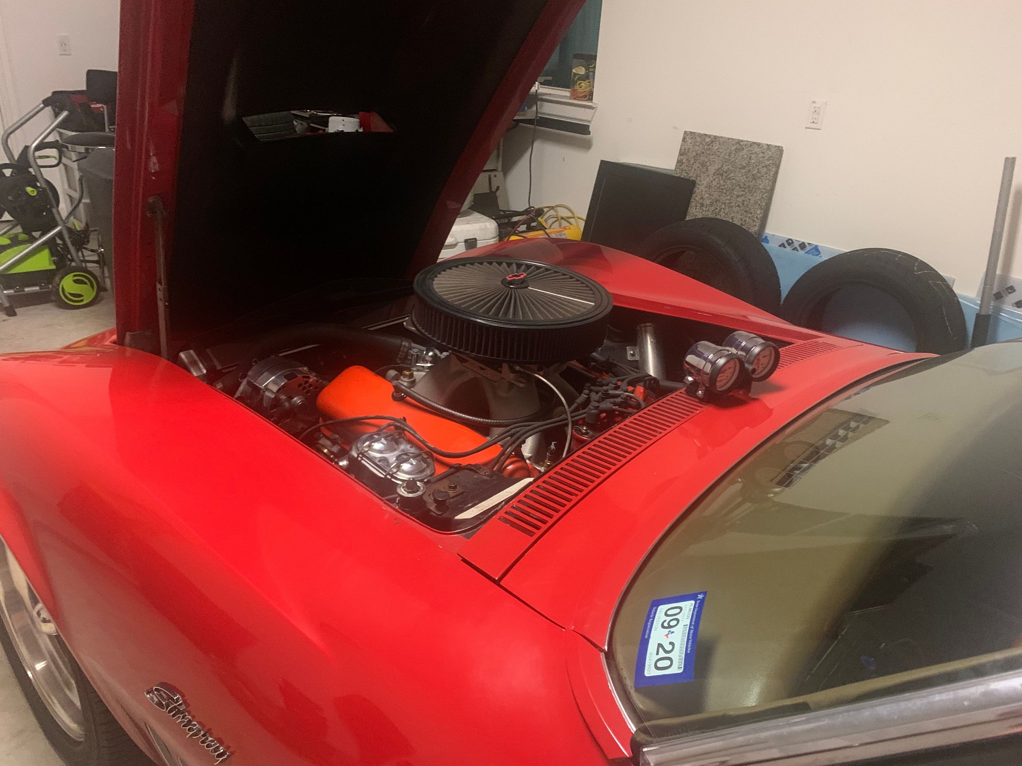

I have been using the Holley Super Sniper 4500 on mine since last October. Very pleased with the operations and overall look.

Originally Posted by ctmccloskey
Hello again Dorian!
Obviously you are surviving this crazy Pandemic! I hope that you and your family are spared by this mess.

Well, for first ever pics, the look great. Thanks for posting... always good to see your work.
You weren't kidding about insulating the hoses. I see you even wrapped the heater hoses
You have me convinced, I will definitely do the Holley conversion. I did another road test a couple of days ago and sure enough... it is boiling in there after a good drive and that make starting difficult. It might also be affecting the running as well. That pressure gauge maybe reading higher than carb... but it still looks like it could be carbureted.
I was surprised by the amount of heat under these hoods
Thanks again for sharing !! Yes safe my friend !
@68vette2go Sweet ! I like the way you put this together. Very clean. I like the hood gauges... Are you also using a Holley in-tank returnless unit ?
Old May 23, 2020 | 09:02 AM
68vette2go's Avatar
68vette2go
Joined: Jul 2017
Posts: 84
Likes: 71
From: Texas City Texas
@68vette2go Sweet ! I like the way you put this together. Very clean. I like the hood gauges... Are you also using a Holley in-tank returnless unit ?[/QUOTE]
No, due to fuel consumption I was not able to use the Holley in-tank system. The car has a very hungry 632 that makes just shy of 900hp. I used the Hyperfuel in-tank system with a return and 2, 340 lpm pumps. In the top of the fuel curve, the engine needs close to 500 gph on pump gas. One 340 lpm pump would almost supply enough fuel, but the unknown is fuel system efficiency loss. We tried a single pump on the dyno, and the engine goes lean around 5,500 rpm. I have 10an supply win 8an return. Currently the Sniper activates the 2nd pump at 75% TPS. I also wanted the option to use E85 which will require about 40% more fuel.
