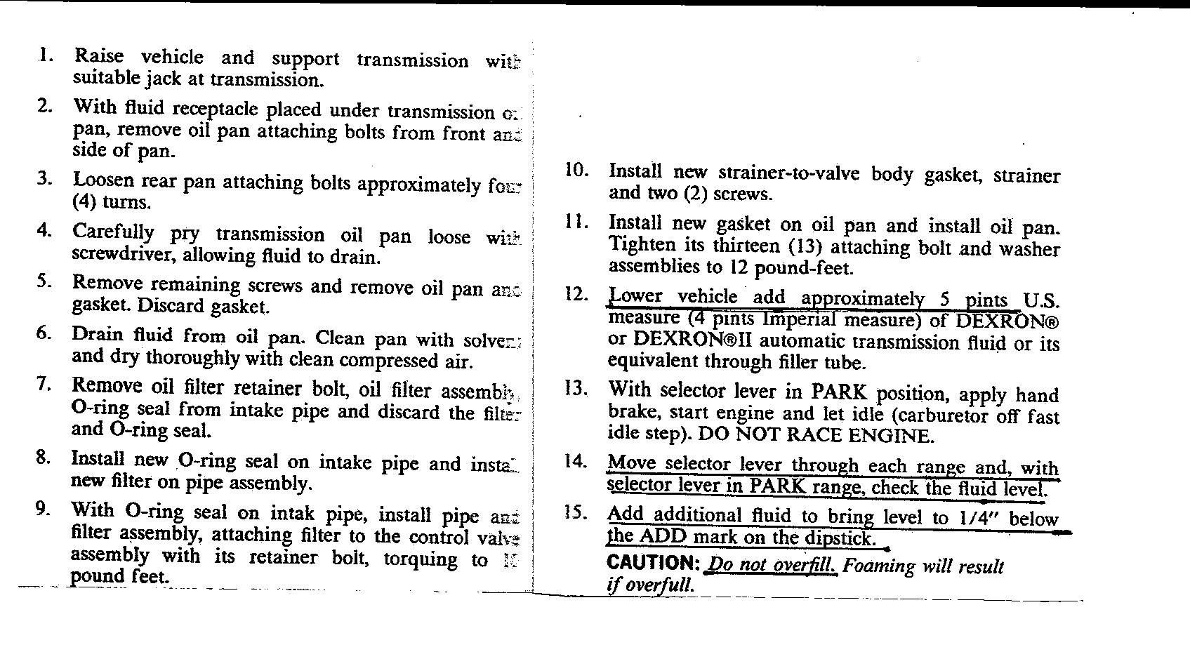

Default Don't over fill it!
Originally Posted by Texxracer
So I had always been told that changing out all the fluid was not a good idea. I dropped the pan when I changed the filter . Fluid had a copper look. Added back about 3 quarts. When you say “service” the trans what all do you mean? “All“ fluid, filter and ...?
Your th400 takes 5 PINTS to refill after just dropping the pan to change the filter.
