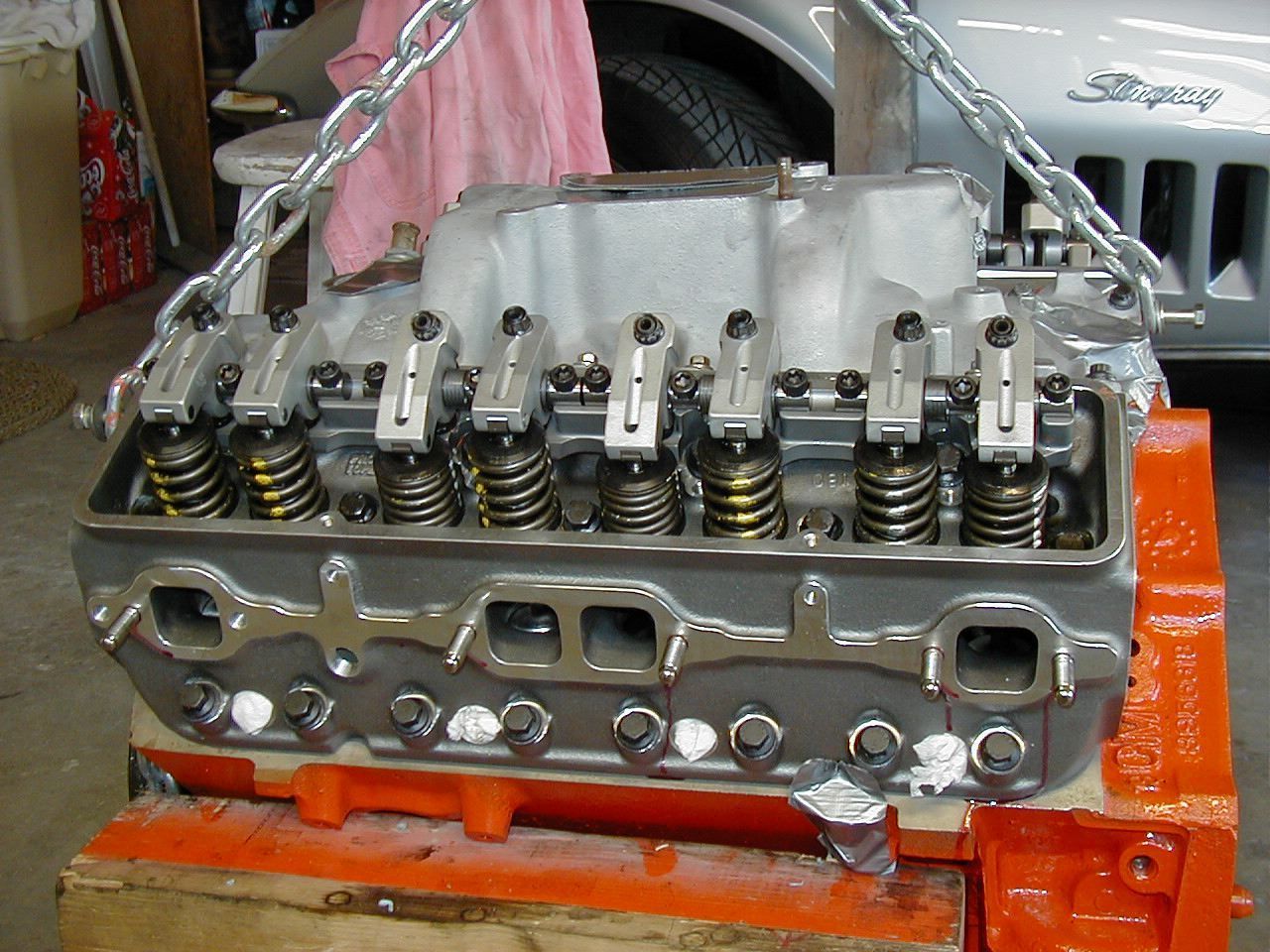

With nothing better to do I have been playing with the thought of up grading my cam
Any thoughts on going roller instead of flat tappet
My interest is in
COMP Cams Xtreme Energy Retrofit Cam and Lifter Kits SK12-408-8
vrs
COMP Cams Magnum Hydraulic Cam and Lifter Kits CL12-212-2
Motor is 350 board .030 over
Flat top pistons
Edelbrock performer heads and intake
Distributor recurved by Lars
2 1/2" rams horn manifolds with 2 1/2" Magnaflow exhaust

I guess I should have posted the cam I have now is a Crane Cam H266 with a 440/454 lift
May I ask why I would have to change the springs and retainers on the Edelbrock heads, they are listed as max lift .510"
Because rollers have a very quick opening and closing rate......this is what makes them make power. This will wear out a flat tappet spring in short order.......even with a mild cam such as the one you posted, I still would not run a flat tappet spring.
If you want to go through the break in process....the 280H Magnum and a set of Elgin Z/28 springs are an old staple....runs great and sounds very chunky. Malke sure you upgrade to one piece pushrods and replace the valve seals on your Edelbrock heads to viton......this is a problem with older versions of these heads bleeding oil past crap valve seals.
a roller cam like Jebby said open faster and closes faster. So more spring pressure is needed to insure the roller follows the cam. Also roller cam likes a good 130 lb on the seat. A flat tappet cam is in the range of 90 lbs. with insufficient spring the roller lifter will leave the cam profile, valves will float, and the valve will bounce on the seat leading to valve seat wear and loss of power
Since your head is limited to .510 then that’s your limit for lift.
