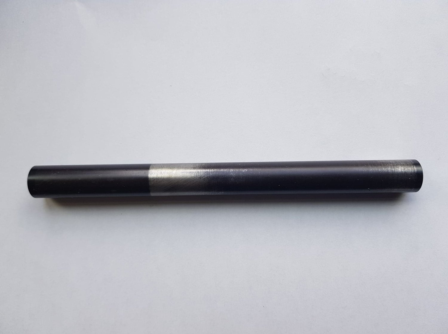

I've got the push rod out and you will see wear .
Could that be the problem?

No, that slight wear on the side of the shaft looks perfectly normal. I think wear on the ends is really what your looking for.
a side note. I had a annoying clicking sound in my 77 engine awhile back. Turned out to be excessive end play in the distributor shaft. Pulled the distributor, removed the gear. Reshimed to spec. (Summit sells shims). Back in, reset timing, clicking gone.

The slight wear is only on one site and the rod is no longer pure right either.

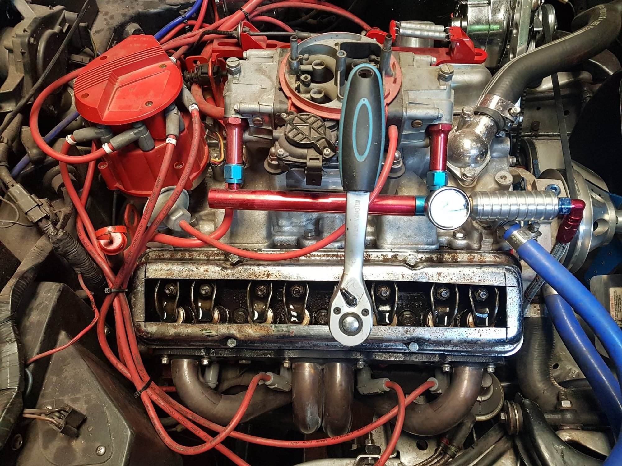

It's not fuel pump pushrod, the sound is still there.
I listened with a hose and long screwdriver, but did not hear any abnormal sound.
I measuring all lifts to determine if a lobes /lifters and there is no deviation there.
I remove one valve-cover at a time and watch the valves, rockers, retainers, springs while running. After it cools down I grab each and every rocker and spring and check for excessive lash, bent pushrod or a broken valve-spring but there are no abnormalities.

Well, at least you know what it isn't and sometimes that info can be very useful.
When you lashed it......how many turns after zero lash did you go?
What method did you use?
Run the engine at night in a dark garage too....sometimes a plug or wire zap to ground sounds like a tick......

Go aorund and check them again using the TDC of each cylinder method. Start at TDC #1, lash those two valves I and E...zero lash then 1/2 turn....then go through the firing order (1)-8-4-3-6-5-7-2 and do each cylinder at TDC for that cylinder. You need to mark the balancer at 90 degree intervals for this......each 90 degree after #1 is the next cylinder in the firing order.......wont hurt to check and it is free. If you somehow lashed it at, say, a 1/4 turn for each one after zero lash....they will be noisy.

You could try lashing them while it's running if you can, depends on the rockers in use and if you can get a socket on them without it grabbing the socket. Some engines apparently make a big mess while running with the valve covers off, mine doesn't, yours might not either. Some guys do end up lashing the valves while it's idling to finally make sure they are all tightened 1/2 to 1 full turn down to try to eliminate that as a source of valve train noise.
Does any of the rockers have the pivot nut tightened down a lot further down to get lash than the others? This could be a sign of a worn/wiped lobe on a cam or bent pushrod. Have you removed the pushrods to check for straightness by rolling it on a flat surface?
Just what I can think of if your going to be in that area anyhow.

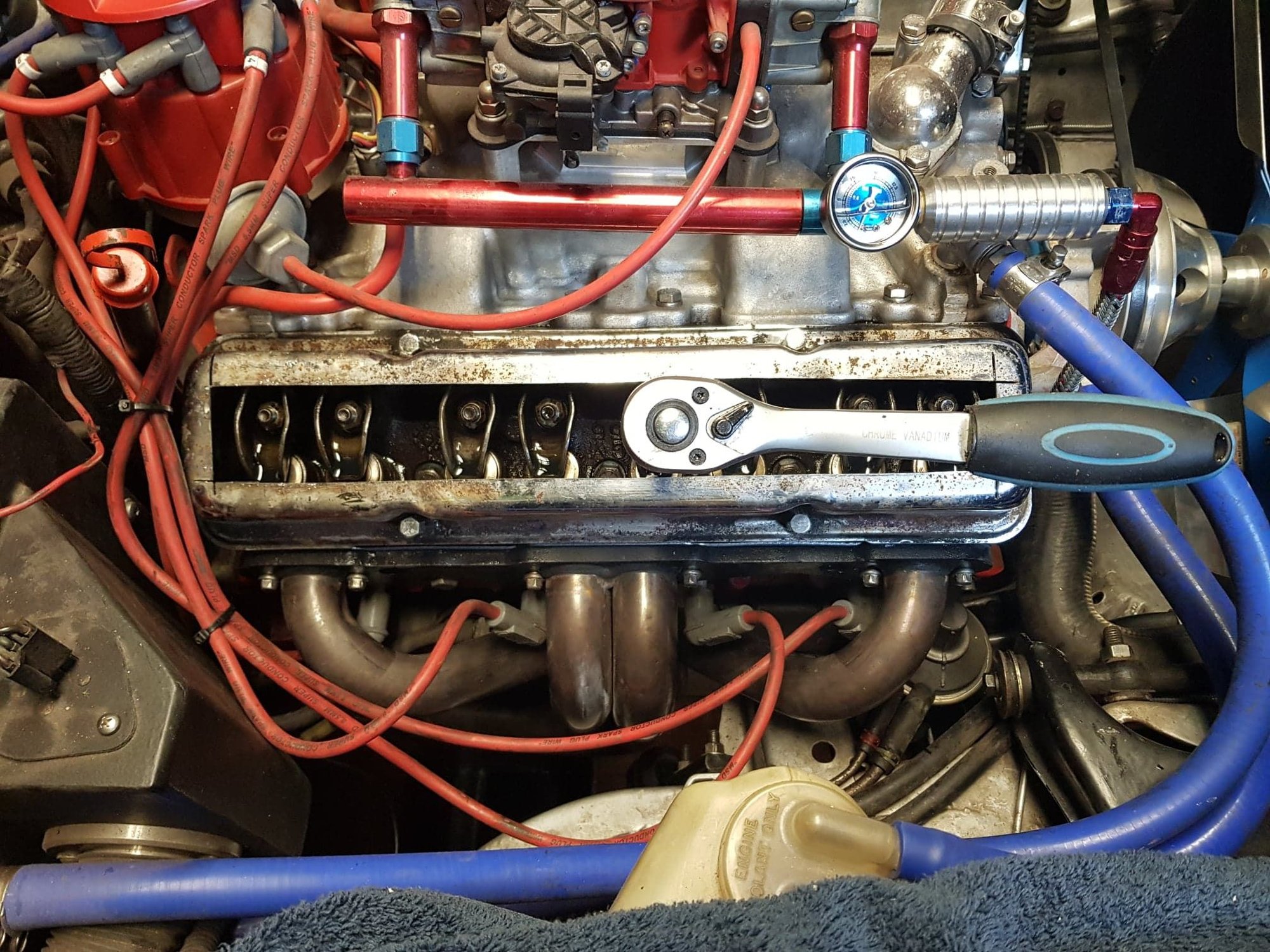

You could try lashing them while it's running if you can, depends on the rockers in use and if you can get a socket on them without it grabbing the socket. Some engines apparently make a big mess while running with the valve covers off, mine doesn't, yours might not either. Some guys do end up lashing the valves while it's idling to finally make sure they are all tightened 1/2 to 1 full turn down to try to eliminate that as a source of valve train noise..
I adjusted the valves with the engine running, but the sound is still there.
I gave a quarter turn three times because otherwise the engine would stop.
There is no difference in the adjustment.
