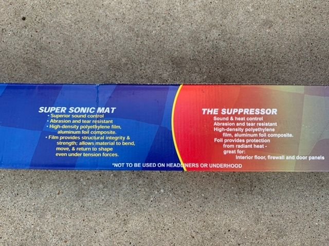

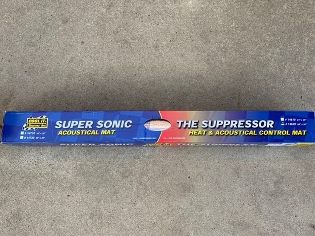

Just received the thermotec coolit product. I didn’t realize it was a sound deadener and heat shield. I guess I can accomplish both in one step? Also plan to install the jute pad with the new carpet and may also opt for the mass backing. This should be sufficient, no?

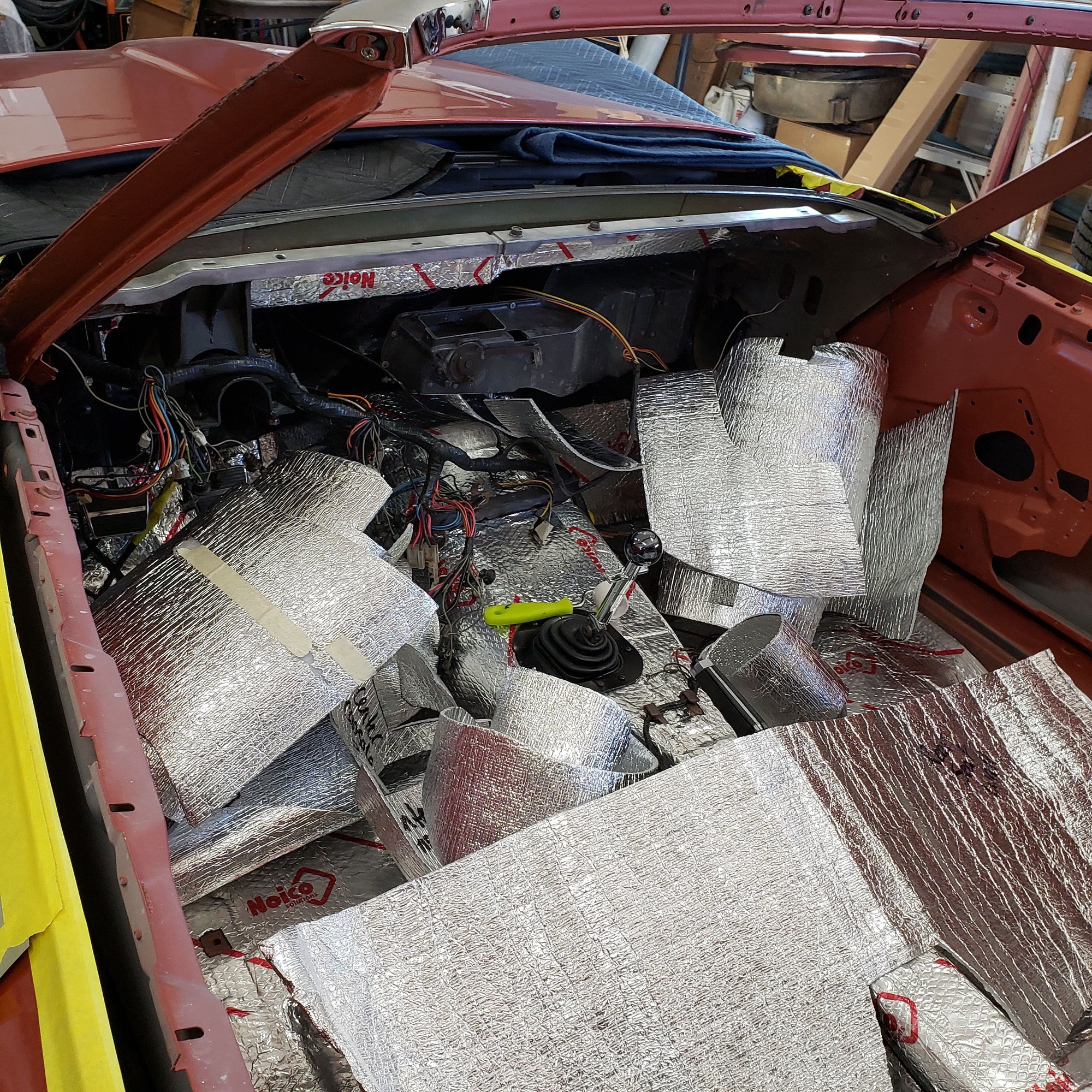

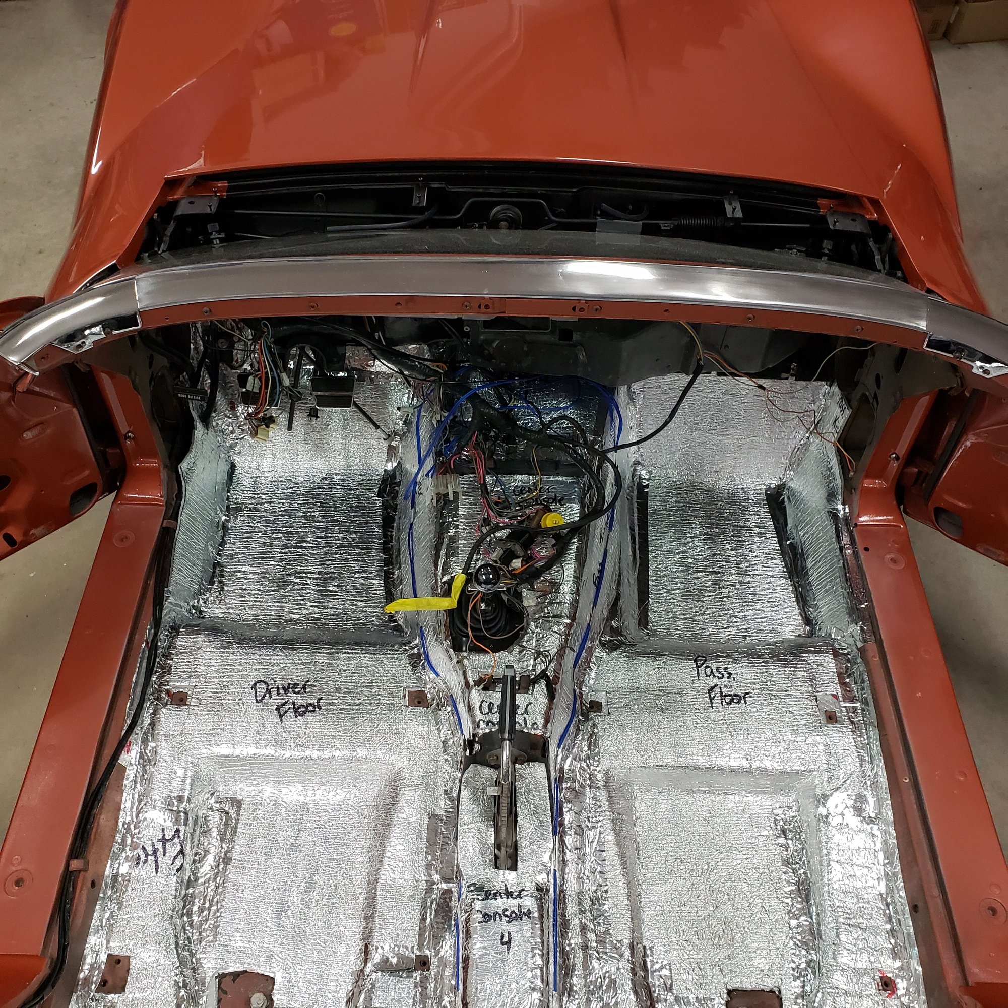

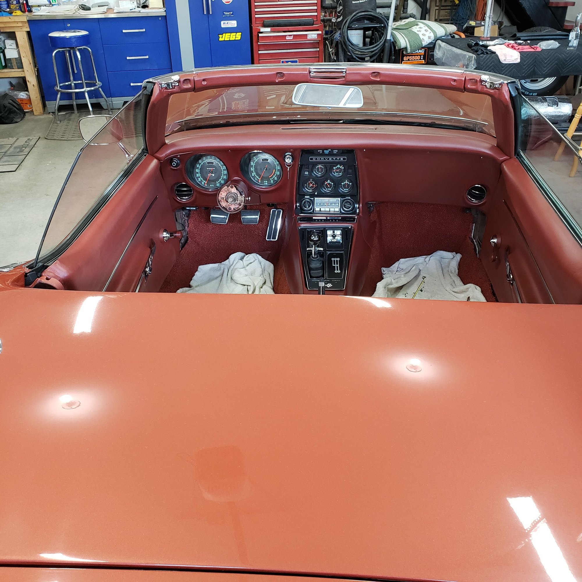

I used a putty knife to clean old chunks of carpet and adhesive than vacuumed. I than wiped down the area I was working with acetone and plenty of rags. Changing the rags frequently. I put down the sound deadner first than the heat barrier insulation than jute backed carpet.

So will the product I am using work for both heat and sound deadening? Box says it does both.
