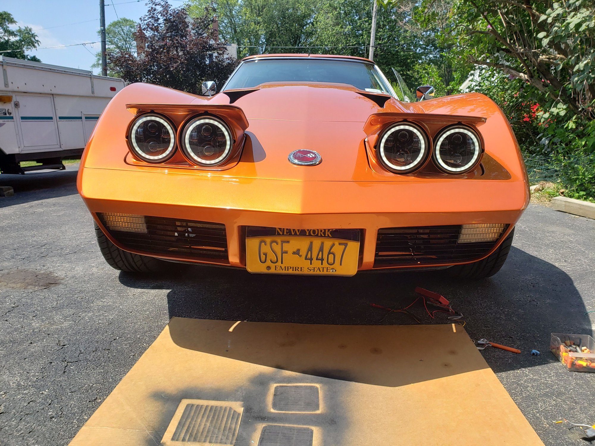

trimming of the metal bucket pieces is required

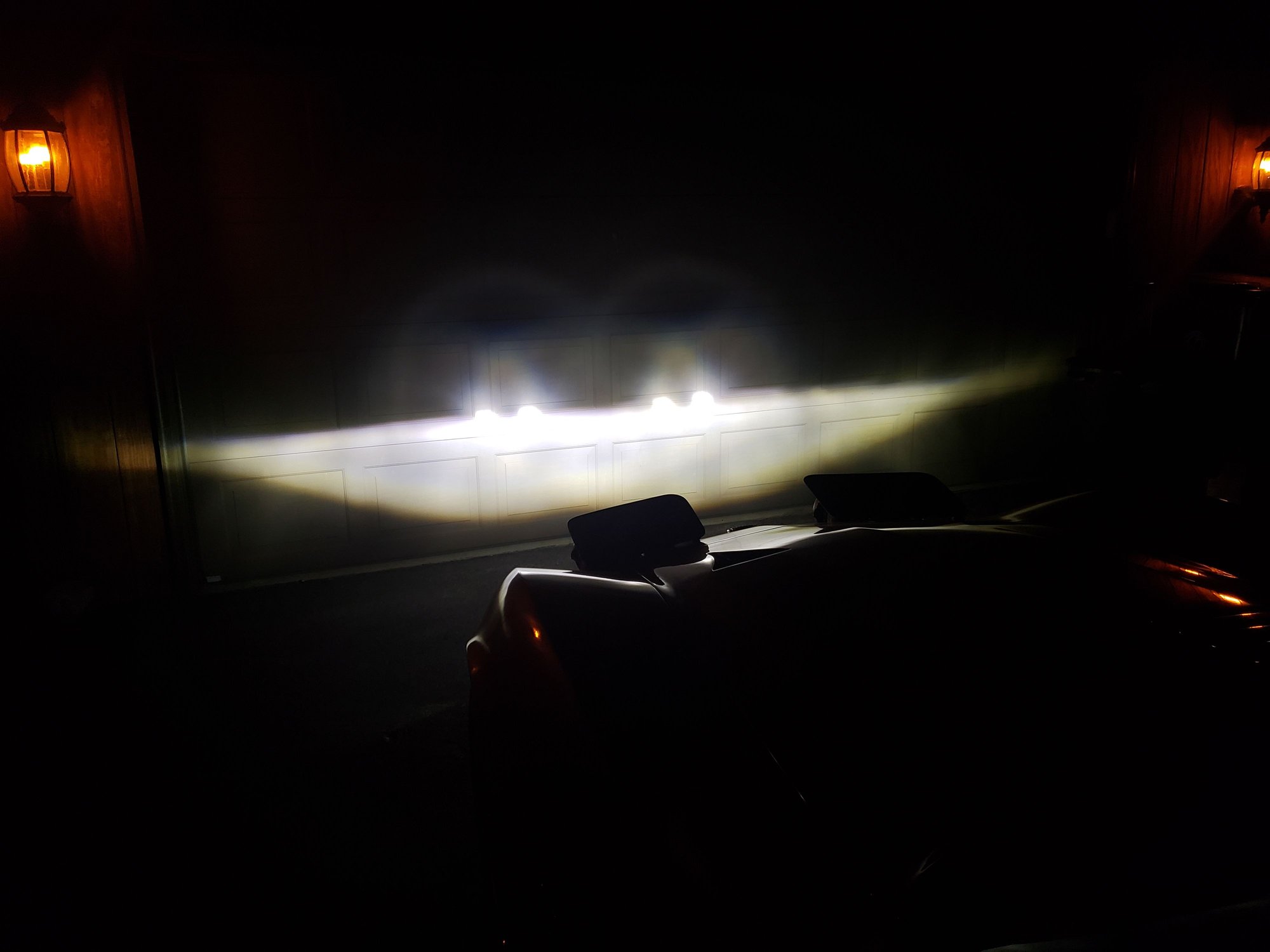

they are much brighter than stock with stock wiring as they draw less wattage.

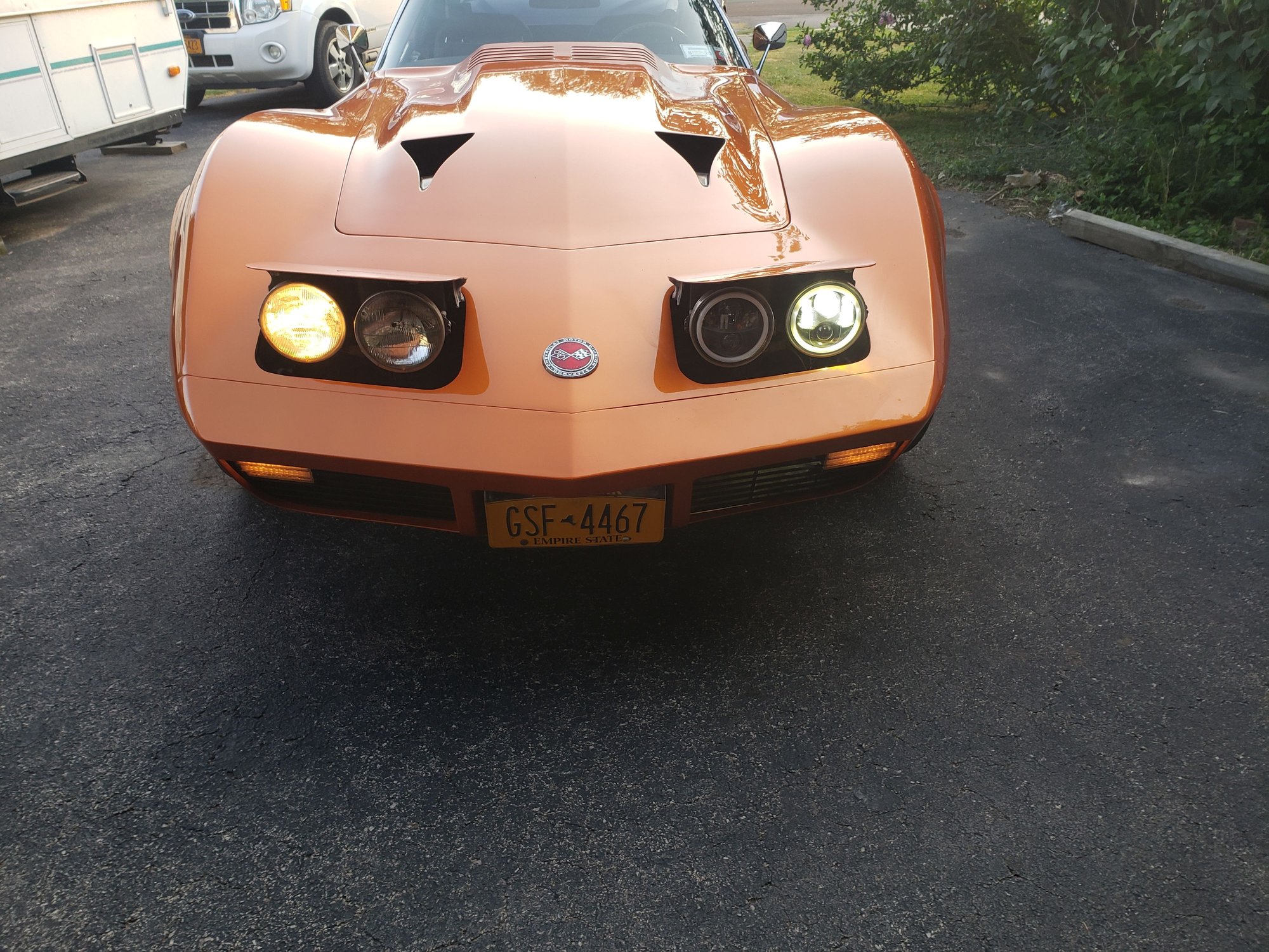

projector style LED lights are superior in my opinion due to the defines light focus and cutoff Its hard to tell but these are just the 2 low beams the high beams are built in as seperate projector bulbs and housings. theoretically if a low beam ever fails I can just swap the outer bulbs with the inner bulb as those arent being used except for the high beam. These are the bulbs I installed one year ago now.
https://www.ebay.com/itm/4PCS-5-3-4-...4AAOSwY5ddLBz7
