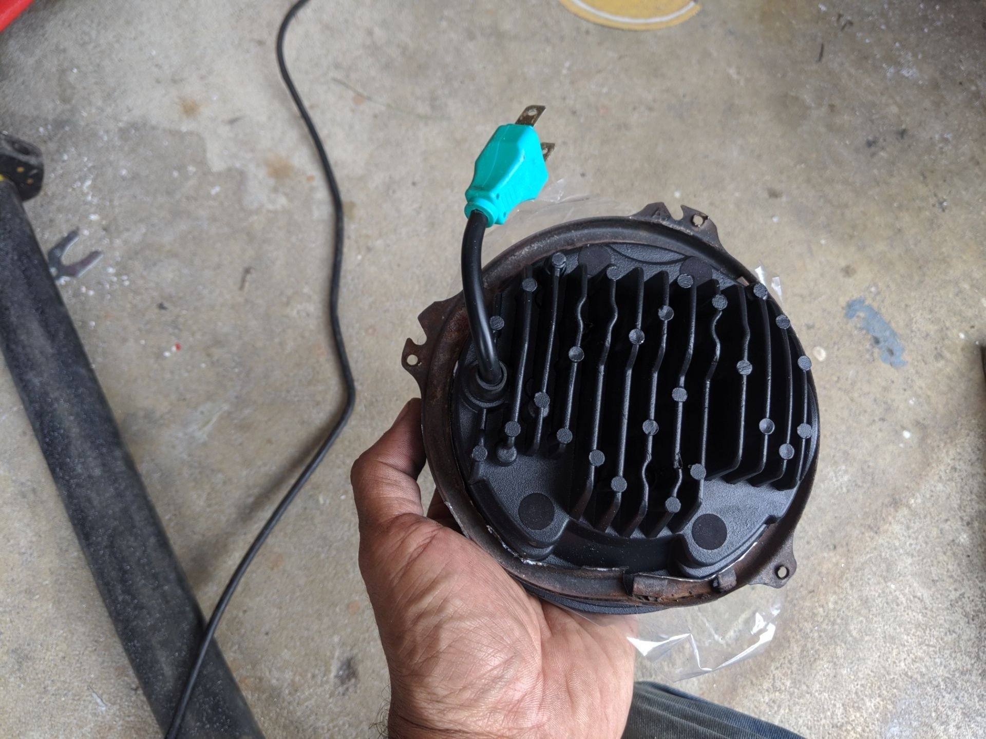

We all agree the headlights could be much better. I already wired my lights to be on a relay and are wire for low/high on at the same time. However I wanted better...their are a ton of different ways to go about this... Here is mine, all said cost $140 all in and about 2 hrs of time. I don't love the look, but I'm not on the outside looking at the lights with them off so whatever...
Getting the lights is really simple, you just need to cut the housing and file the rest down slightly, the rest is literally plug and play.

Yes - they are Hi/Low, I run one (the outers for the low) and HI all four kick on. I might change the wiring so the low is used on all four (the top part of the light is the low)
Fiber optics are long gone, these are DOT approved. They are not too deep that they don't fit, but as I posted in the photo you will need to grind down the "tabs" if thats what they are called.

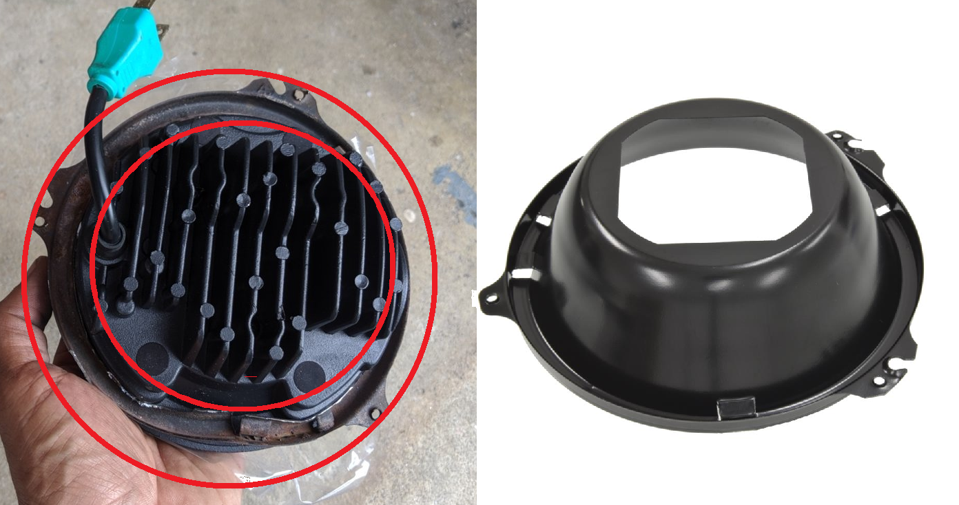

You have to cut up the headlight bulb retainer quite a bit-
the piece circled in red is whats left- HOWEVER you can buy replacements for $15/each and cut them up if you feel saving the originals is a big deal....

I didn't use a dremel, I am sure you could I just put a slice with a cut off wheel then cut it with an air saw. You just need the outer ring of the cup, cut as much as possible and grind down the two tabs the top and side one (the one holding the spring on my car didn't need to be touched). Thats all folks...
They are 100% plug and play into the factory harness, I run two relays on my headlights but thats because I have a lot of electronics in my car and it's far from stock. And to be honest I run most things through relays where there is any large draw. You don't have to.

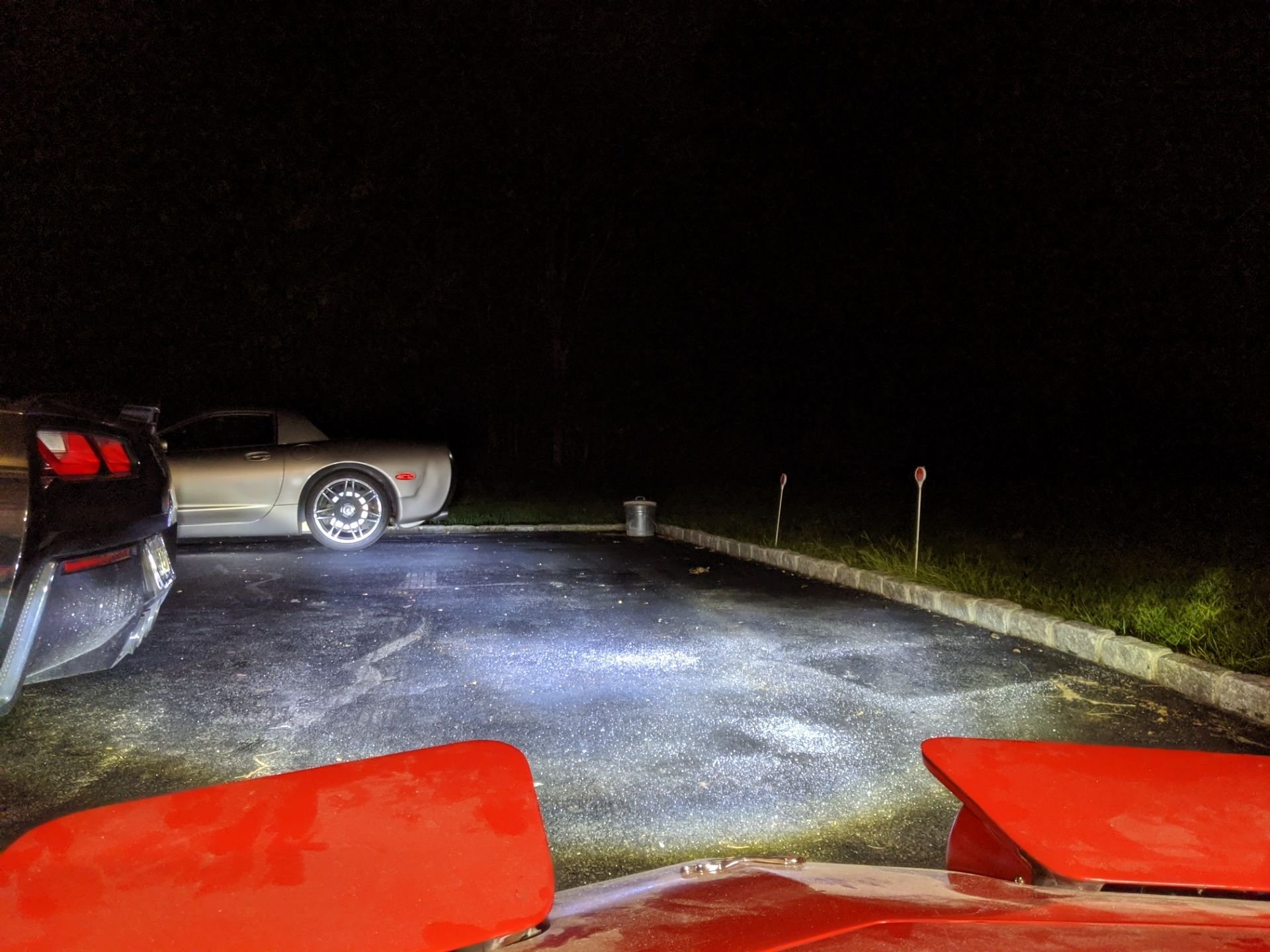

Here are some photos of the lights on the car... YES I know the car is very dusty...and the lower part of the lights are NOT on thats the camera angle. ONLY the three top light up on low.
Here is high beam..
Here is low...you can see the cut off is mid body of the C5, and nothing is hitting the glass or roof line.
And here is high...
