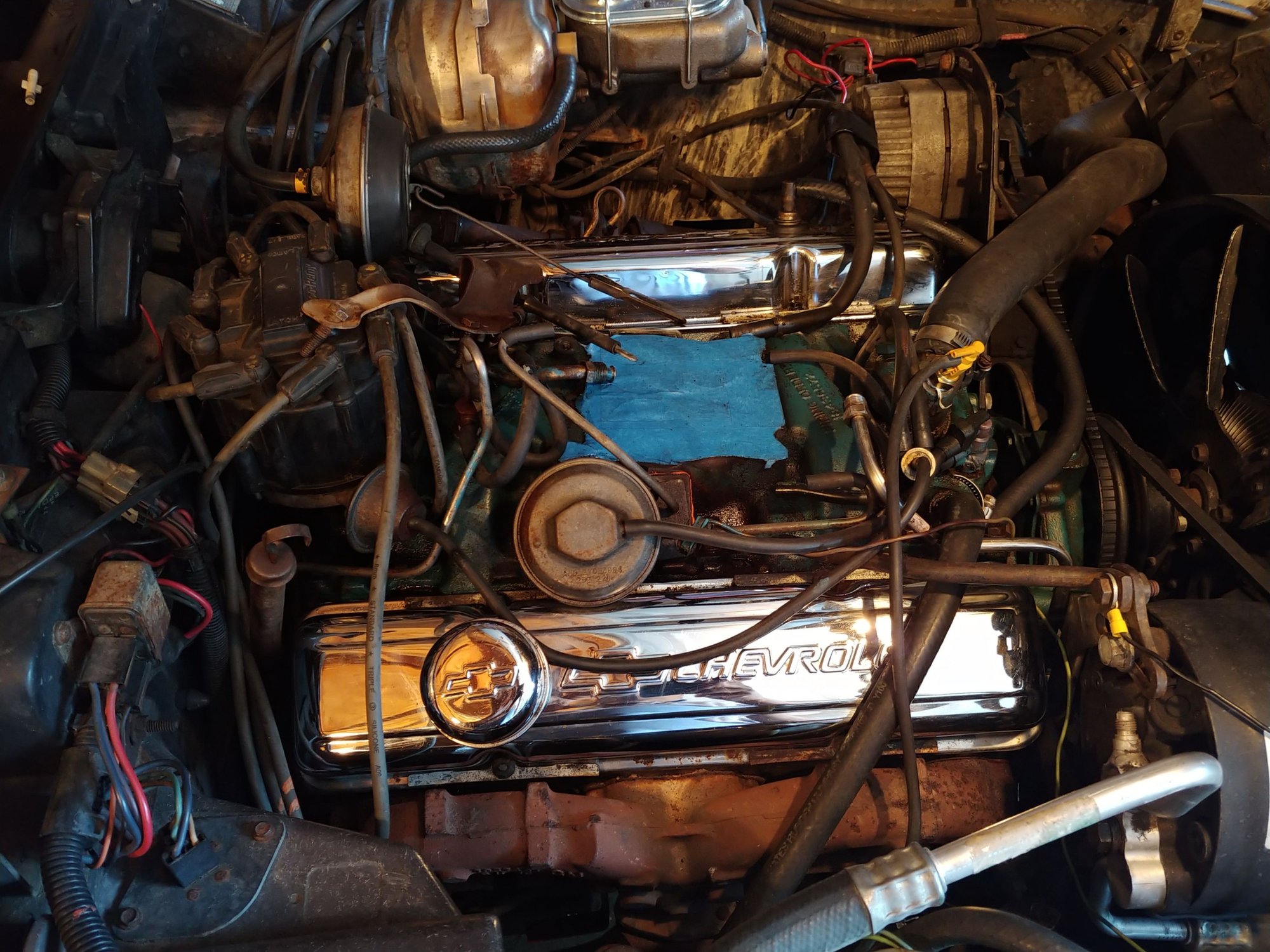

Good Day people this has most likely been covered at some point or another. but i am looking to change the factory manifolds over to Headers. What headers are recommended ( in you guys experience) with the least amount modifying, Can i just remove the manifolds and replace with headers direct fit with out totally removing the engine, i do not want side pipes and would like them bolt up to my existing exhaust via 2'' collectors. I have noticed block huggers are nice but it appears to be a real tight squeeze. just looking for what works best with the least amount of fuss. 1979,350 with AC automatic.

The only way to bolt right up to existing exhaust is by using a shorty header designed for such connection. However you won't get the same performance gains as from a full length header. Full length headers can be bolted to your existing exhaust but it will take some cutting and welding. You can put on headers without removing the engine.

Maybe someone with way more knowledge than me will add to this but I think I would work on removing some of that smog crap before I spent money on headers. Your engine is so choked now that headers will be of very little or no benefit. Just my $.02.

OK actually i was thinking about that as well, when you say smog crap do you mean the EGR valve and ported vacumm switches. No smog pump attached.

yes

Most common header collector size is 3" with three bolts. Then a 3" collector reducer is attached to that, to get the needed size of your exhaust pipe (2")
Try Summit Racing. See what they have in a 1 & 5/8 primary, 3" collector, ceramic coated. I believe Dyna Tech is reasonable.
You will need to fabricate some type of spacer for the (missing) exh manifold bolt near the A/C to hold the compressor. The spacer will need to be the length of the thickness of the manifold.

If your state allows, everything off. Its just performance killers, makes the engine difficult to work on and looks like ****.
The purist will disagree but I believe in keeping things simple, enjoyable. Smog crap is none of those.
Pitch the air pump, cast iron Exh manifold, EGR and about two miles of vacuum lines. Re-time the distributor curve,
