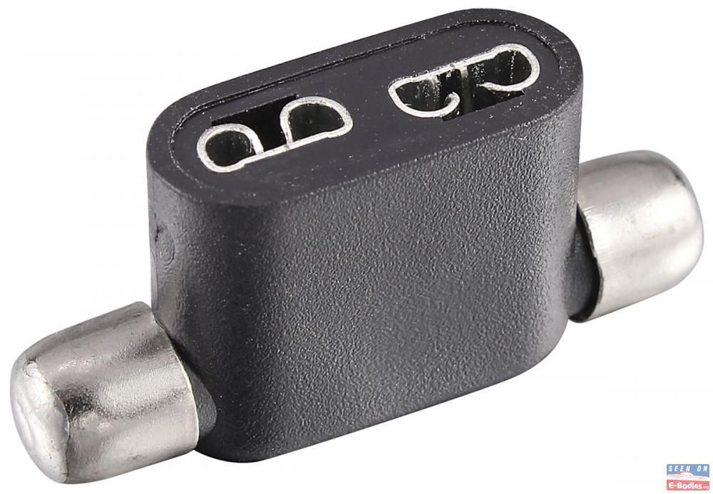

If you use the adapters to blade fuse-
AND

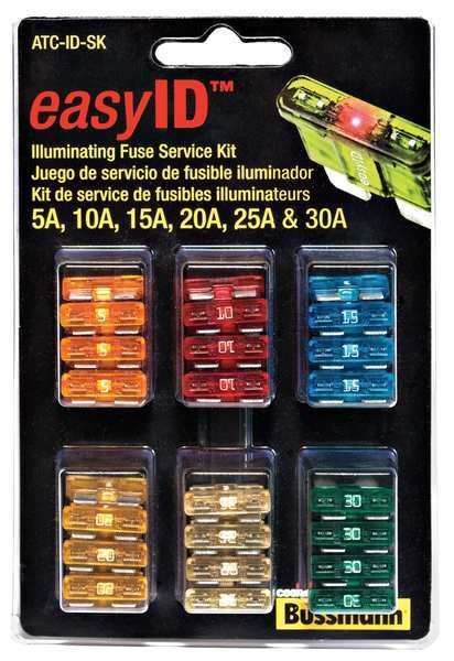

Get the blade fuses that have LEDs that light up when the fuse is blown-
Simple plug and play- nothing to rewire-
1) With the adapters- the fuse is MUCH easier to replace
2)Much easier to tell if it's a blown fuse w/ the LED
Old May 15, 2020 | 12:30 PM

Now, THAT'S a route that makes sense....IF you want to go with "modern" fuses. The fancy ones with the little light which tells you that the radio which just failed (and you can't hear) has a burned up fuse are just "peachy" At least, they will tell you WHICH fuse is defective. But, using the 'conversion' strategy will also allow the use of the non-flashy fuses, too. So that would achieve your goal of modern fuses without tearing into a working 50-year old box & wiring.

Love this! Sounds like a good compromise. I definitely do not want to create any unnecessary work for myself.

Looks like the adapters are no longer available. Probably for the best. Save me hours of work bent under the dash.

The adapters look pretty neat though, maybe my parts store has some on the shelf. Might buy some if possible just to have around. I used the lit fuses on an auxiliary fuse block, so far so good.
