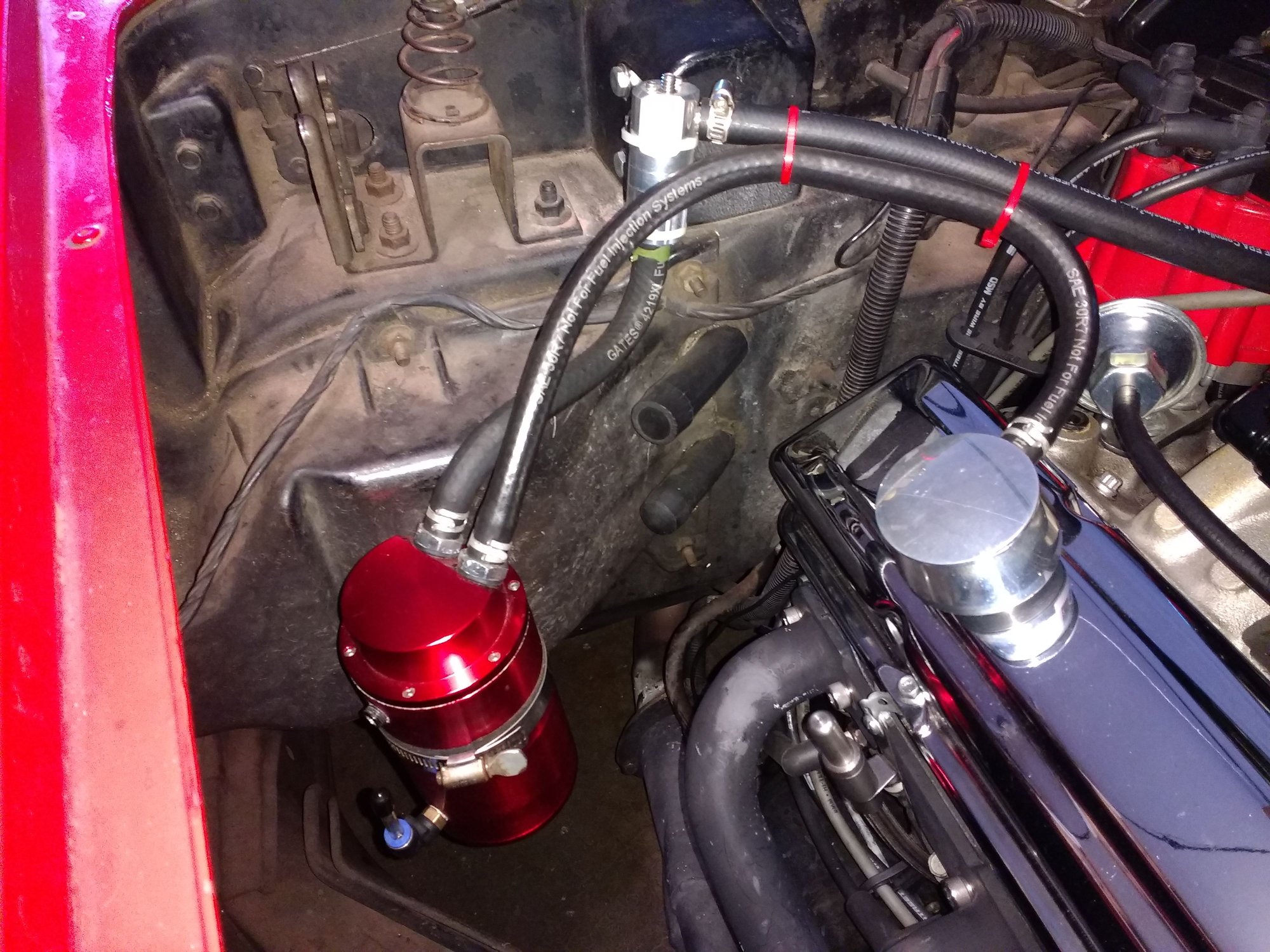

This catch can from ebay
https://www.ebay.com/itm/Oil-Catch-C...17cf2891f038e3
I put some stainless steel in the can like it shows in the pic. I like the dip stick feature and that the bottom screws off to dump the can. It's pretty robust and seems to work as advertised.

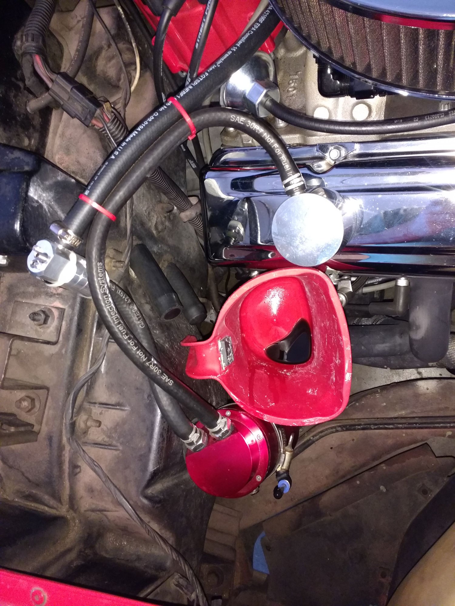

I've got both the M/E Wagner PCV and a catch can. Mounting was easy since I don't have any obtrusive air conditioning, heater, radio or any other unnecessary items to get in the way. The valve cover breather thingy is a Billet Specialties PCV fitting but I was getting too much oil sucked into the intake. So I took the valve out and stuffed it with Scotch Brite and ran the hose uphill for drainage, then down to the catch can which I found for $35 on Amazon. It's probably best to spend more on a well built can but I only had to make a couple mods and stuff it full of Scotch Brite. I added a tube inside the can so the incoming mist goes to the bottom and has to rise through the can to reach the exit. My PCV inlet behind the carb is now always dry. After three years and
roughly 5000 miles of abusive WOT and street cruising, I've just recently drained the can and got not quite an ounce of oil out of it. I'm pretty happy with this arrangement.
