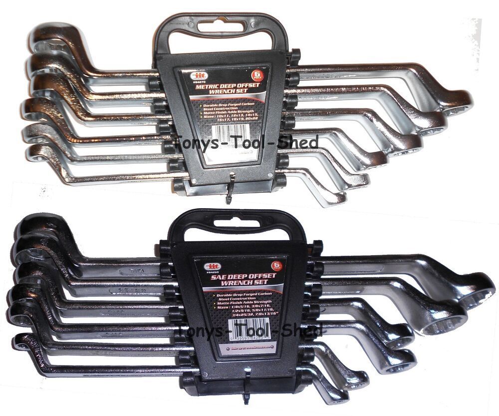

I suggest trying a deep offset box end wrench for the plugs with limited access.
You don't have to fight with trying to thread a deep well socket over the entire length of the spark plug.
It's what I use for the plugs that are partially hidden by the header primary tube.

Guess who's going shopping...this guy!!!
