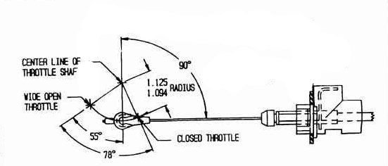

The geometry of the TV cable is one of the biggest screw-ups people make with that transmission
You should read this
http://www.jakesperformance.com/trans-tech-info/
This is exactly correct and is about 90% of these issues these transmissions have is that everyone in this hobby who knows everything still doesn't believe or want to believe that TV adjustment is CRITICAL on these transmissions......think of it as the transmission pressure control cable.
I have been laughed out of the room by dummies when I tell them this is the reason their transmission quit. And it doesn't matter if you paid $500 or $5000 for one.....if the TV cable is improperly adjusted.....the trans will fail. If the adjustment is close....it will act funny.
The OP needs to get a correct bracket on it and have the geometry checked as stated......
