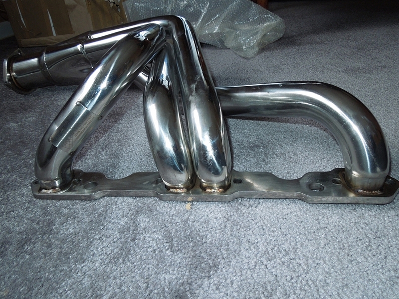

Depends on what you buy
Not Hooker S/C 1 3/4
Not my 1 7/8th stainless
Not older my headman 1 5/8th
I use the tall Wix or K&N one quart filters

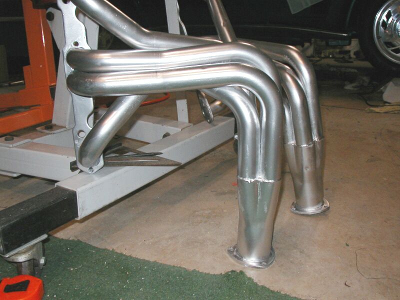

Here you go. I had some of these on my 68 ages ago. Fit just fine and the oil filter does also (and I've never seen anything about them being redesigned). I've been through a couple other exhaust headers since and I am now back to RamHorn exhausts manifolds. BUT, anyway, these fit well but you still have to tie in to the remainder of your exhaust system. These are relatively cheap but if I was planning an LS future then I would not even bother.
https://www.summitracing.com/parts/hed-68300

So you mean you don't have to use a short filter? I have circa 1990 Hedman 1 5/8" units and I have to run the short "PF25" style filter......mines a Wix.

My 79 l-82 Got Hedmans circa 1980 and I always ran larger filters just for the extra oil volume. Memory is kinda faded, but it seemed to me that Hedmans QA wasn't very good back then because one collector was probably an inch higher on one side because I remember doing the true duals and they looked dorky from side view. I don't remember which side.
