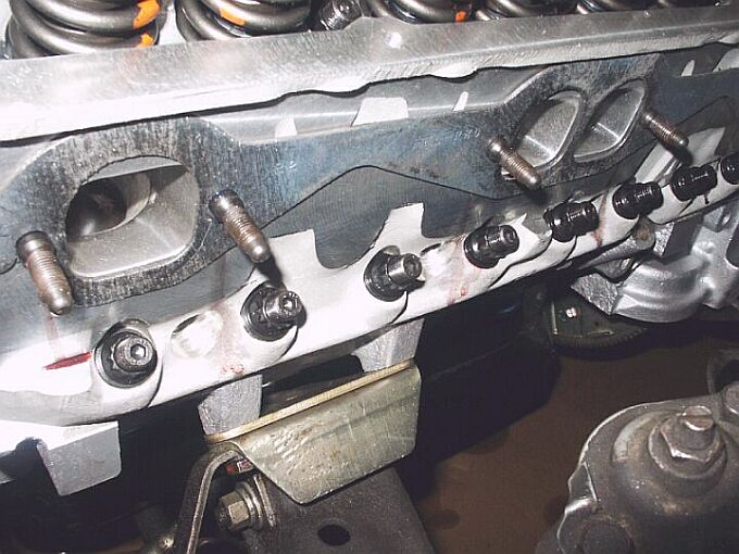

This is the only correct answer! You Loctite red the studs in. hang felpro blue steel impregnated header gaskets. Universal ARP header studs from Summit racing. Black oxide studs. high temp red Permatex so that they never come off. I used to safety wire stuff. My vette motors are fully studded. headers, heads, mains, timing cover, dizzy, and water pump.
Dip stick tubes can be a PITA. I've had some success using two people. Get a small 4 inch vice grips. pull the dip stick in and out so that you know it's orientation. The dip stick will hold the tube out from crushing when you put the vice grips on down near the base and block. Have one set of hands working the tube back and forth and the other person pounding up with a big screw driver. Once it moves up get the screw driver under the rounded dimple and keep pounding up and out. Worst case I just took the stick out and destroyed it and bought another tube. Time is money when you are a race car mechanic! :LOL

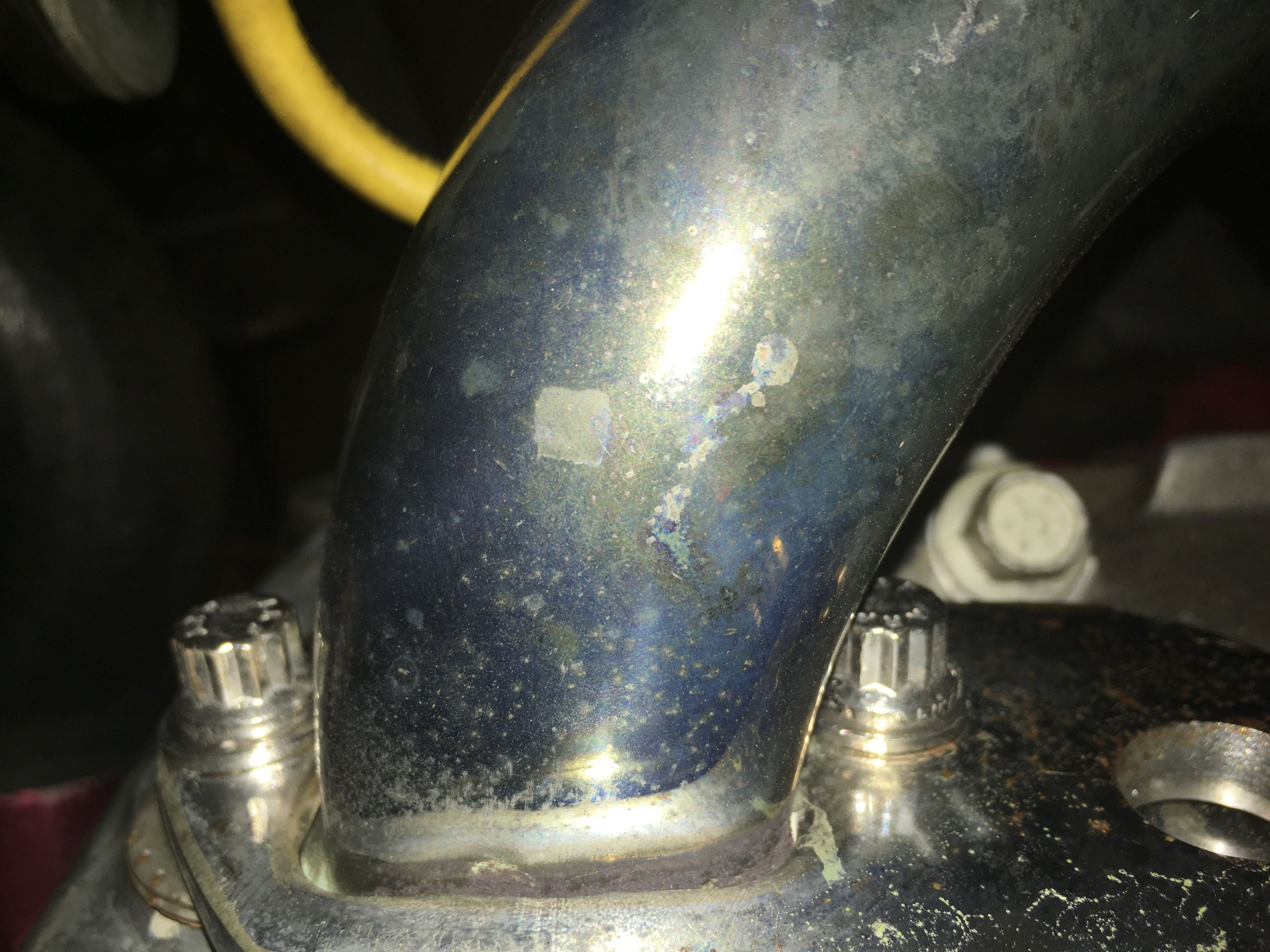

I think these are the ones you are talking about that will fit my 383. Is this correct? I can't see how you put the stud in first. I assume there is some kind of wrench fitting in the end of the stud, but I can't really see it from any of the pictures. I changed my valve covers over to studs and did it properly and I'm really happy with how that turned out.
Some of the reviews say the nut didn't fit because the tube was too big to allow room. When I took the headers off, some things were pretty tight. That was why I was leaning toward the Allen wrench heads. I'm not sure how to tell if they will all fit and I really don't want to loctite studs into the head and find out I can't get the nuts on.
Your picture looks like you may have had to dent the tube a little to get the nut on.

Originally Posted by Bikespace View Post
Next time, I'll get the ARP 3/8 to 5/16 studs, that have the next size smaller nut. The studs also make hanging the pipes a lot easier.
To install studs: You double nut them. run two nuts down a bit and tighten them against each other with two wrenches. Then you Loctite the end and run them in and let it dry.
They make stud sockets that grab the threads if you are careful. But when you use air tools to R&R remove and replace...… you invariably ruin and chew up a few threads. not a big deal on a race car because you buy multiple sets of everything
