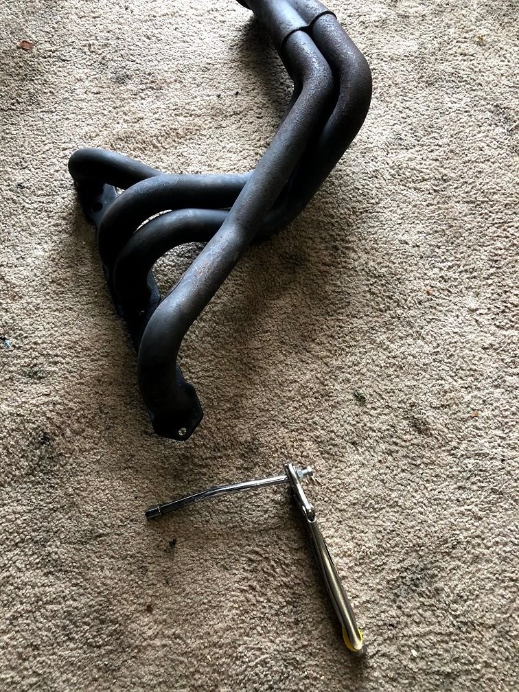

After some sleep and some thought...
I got the dip stick tube out and the headers dropped right out. Oh happy day!
I also found a 19/32 12 point socket used as a spacer on the front right bolt that spaces out the A/C mount bracket. I guess I now have to look for the right spacer for that. Or not care how it's spaced out.

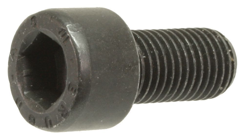

I just installed a set of Doug's Headers on my '77.
The header bolts that come with the headers... toss them in your 'misc bolts' bin
You definitely DO NOT want header bolts that require a socket because some of the pipes make it impossible to get the socket on the bolt head, even with the smaller bolt heads that Doug's supplies. I found some allen key header bolts at the auto parts store that come with a socket with a ball allen. From personal experience (meaning yesterday!) DO NOT get the Cometic brand... there is a reason why it's $15.99 and the Mr. Gasket set is $54.99! The socket was so loose it wouldn't stay on my ratchet, and the ball allen got stuck in the very first bolt head.
What I ended up using were these (well look like these)
I got mine from ACE but you can get these at Lowes or Home Depot or any good hardware store. I found the 3/4" long ones worked perfect. I got a couple different sizes since they were inexpensive. The longer ones didn't bottom out, but they got to a point they were hard to thread in. I suspect those bolt holes made not have been threaded all the way down. I've seen some comment and say 'why risk cheap bolts breaking off', I can say the ones I got actually are beefier than the ones I got with my headers! You can use a regular 5/16 allen socket (longer key though) to tighten SOME of the bolts, but it's still hard to get the ratchet in straight on some because of the pipes. I just used a regular 5/16 allen key and was able to get those ones nice and tight. As far as strength, I had absolutely no problems. Also I got mine in black and they look really good and beefy on the headers. The bolts I got were less than $2 a bolt and worked perfect.

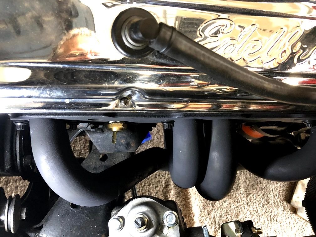

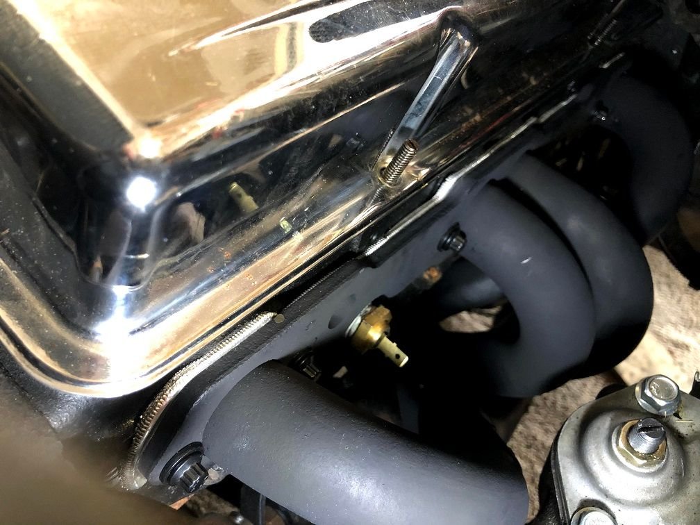

In the end I decided to go with the ARP-100-1207 bolts because of the smaller head size given the clearance to the header tube.
I think it turned out nice. Had to pull the header evenly by doing all the bolts a little and then again and again. If I got the header cockeyed by pulling one side in too far, there was one bolt that would get too close to the tube and I wouldn't be able to get the wrench on it. Not that big a deal. Thanks for all the help because I would have bought the wrong bolts without this help and would have been frustrated.

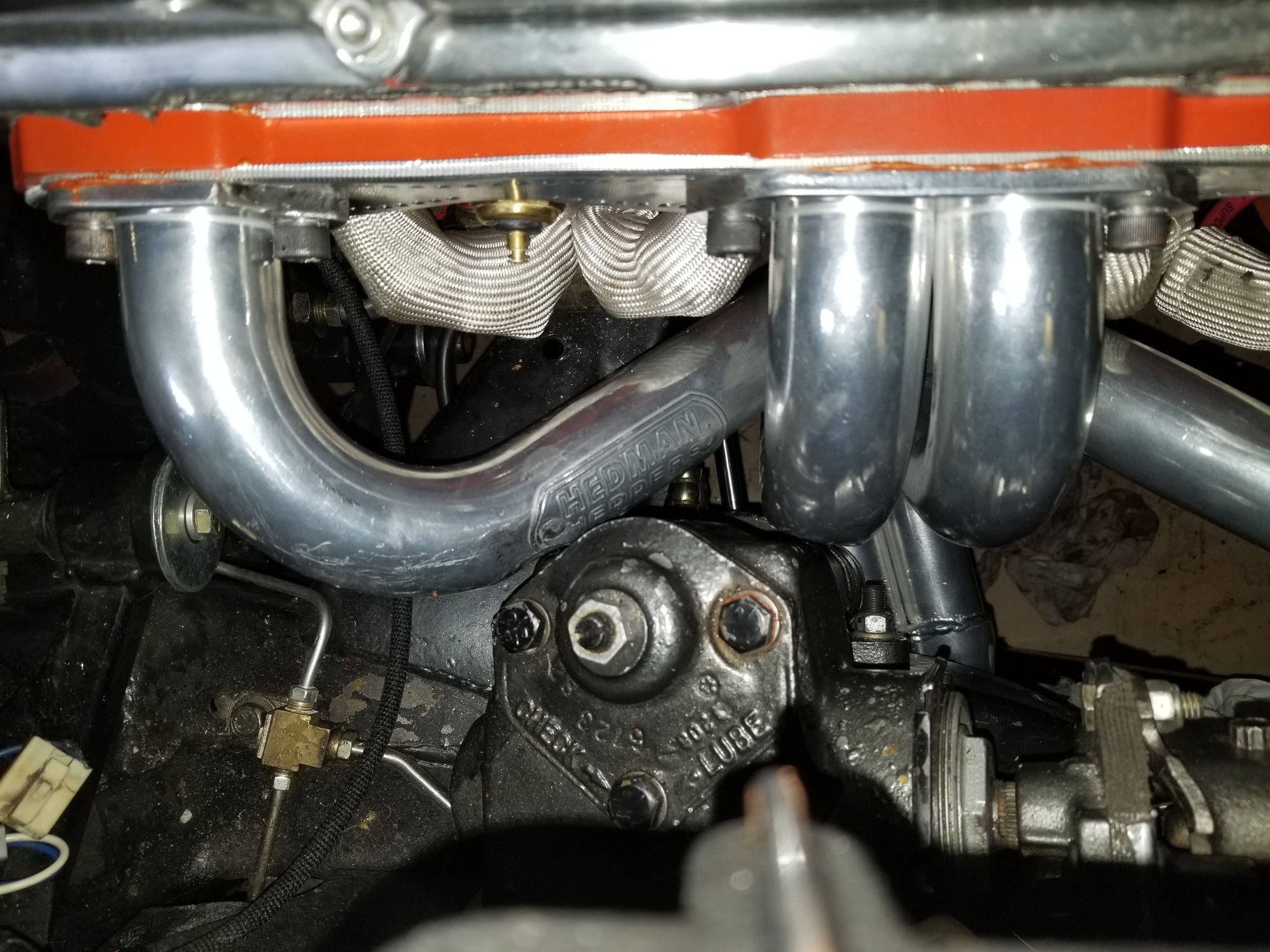

I needed 2 inch bolts because I used marine header spacers to clear the angle plugs so I bought some grade 8 Allen heads that are drilled for safety wire. It worked great

They look great. I always liked the built-in washer on those ARPs and the 12 pt head. You spared no expenses on the gasket too.
Anytime you get a header flange that refuses to mount up nice & flat to the head (warpage), there is an old trick to fix that.
Pull header back some and using a hacksaw blade cut a "kerf" on the BACKSIDE of the flange between cyl 1 & 3 and 5 & 7. Cut the kerf only deep enough to allow the flange to flex a bit. The kerf will be hidden from view once the header is bolted up.

You could feasibly put a dab of high temp red silicone on the bolts so they wouldn't back out. I would never use bolts in aluminum heads. You can damage the threads. Bolts only fit on smaller 1 5/8th pipes. Never on 1 3/4 primaries. 5/16th studs are the only thing that works and it is so easy to be able to just hang the gasket in place and lift the pipes on!
Rescue Roger, I would worry about the heat turning the power steering box grease into crusty nothing. I had to dent my nice S/C header with AFR heads to install one plug.
I agree, that pic doesn’t show the dimples I had to put in for clearance, I had to get creative
