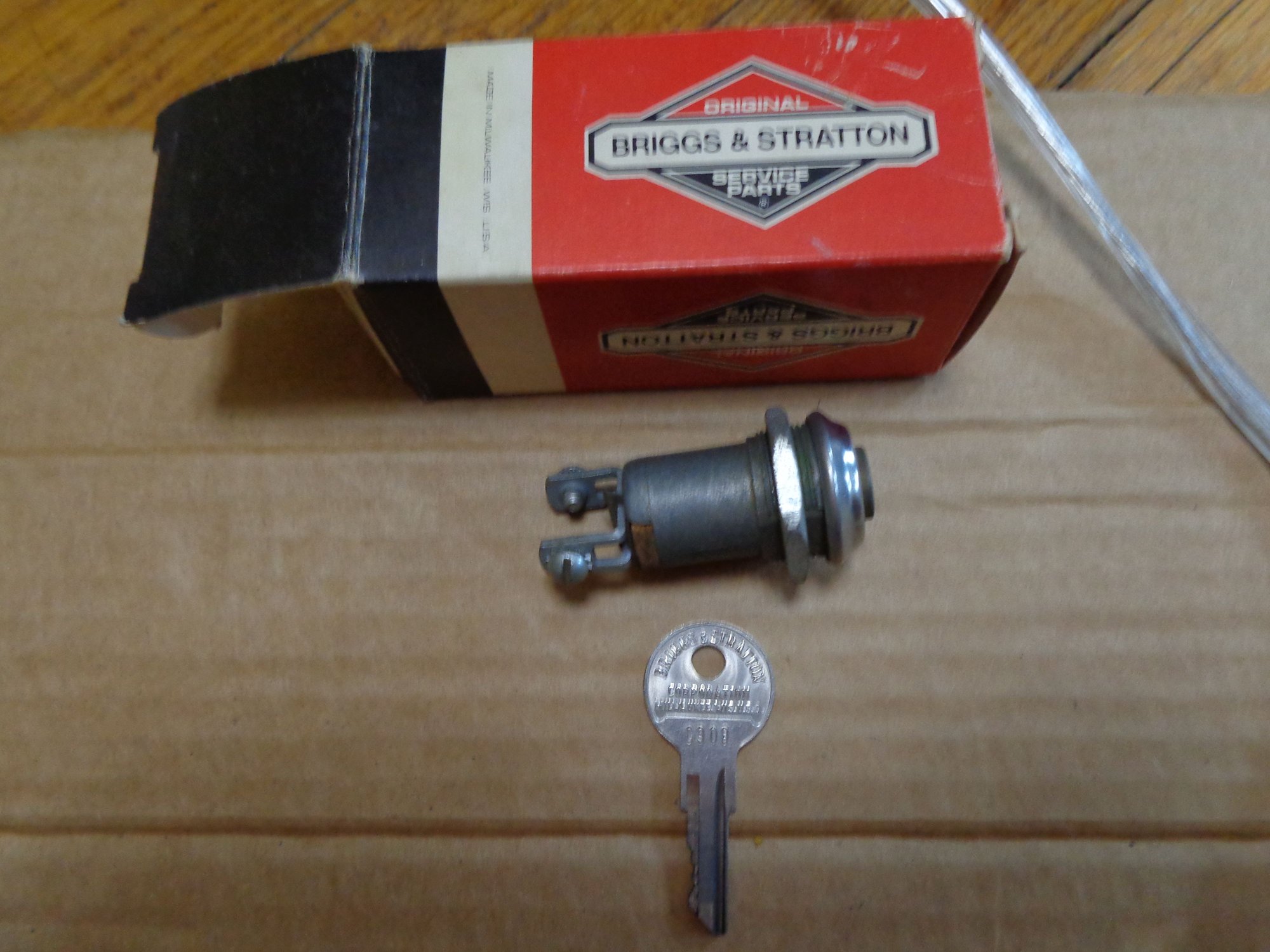

That's not an original Briggs & Stratton alarm switch in the rear panel

This switch was used 1968 69 and early 1970

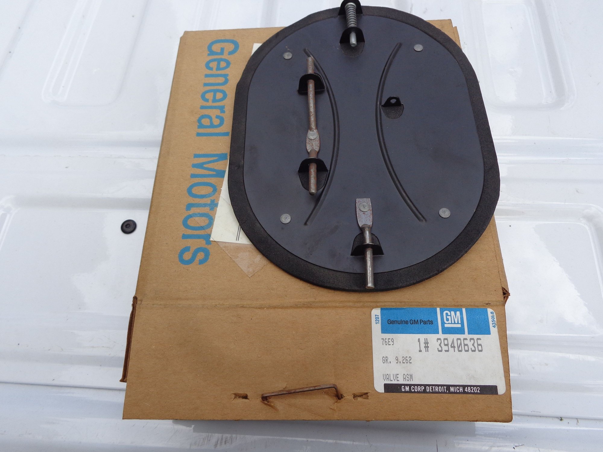

Remove the left kick panel where the radio speaker is and you can remove the vent door and reach in there. You remove the vent door it has a spring on one of the pivot shafts you either lift it up or down to get it out then you can reach inside

Old May 31, 2020 | 08:54 AM
ralphspears's Avatar
ralphspears
Banned Scam/Spammer
Joined: Nov 2011
Posts: 2,966
Likes: 991
From: MA
Old May 31, 2020 | 10:40 PM
