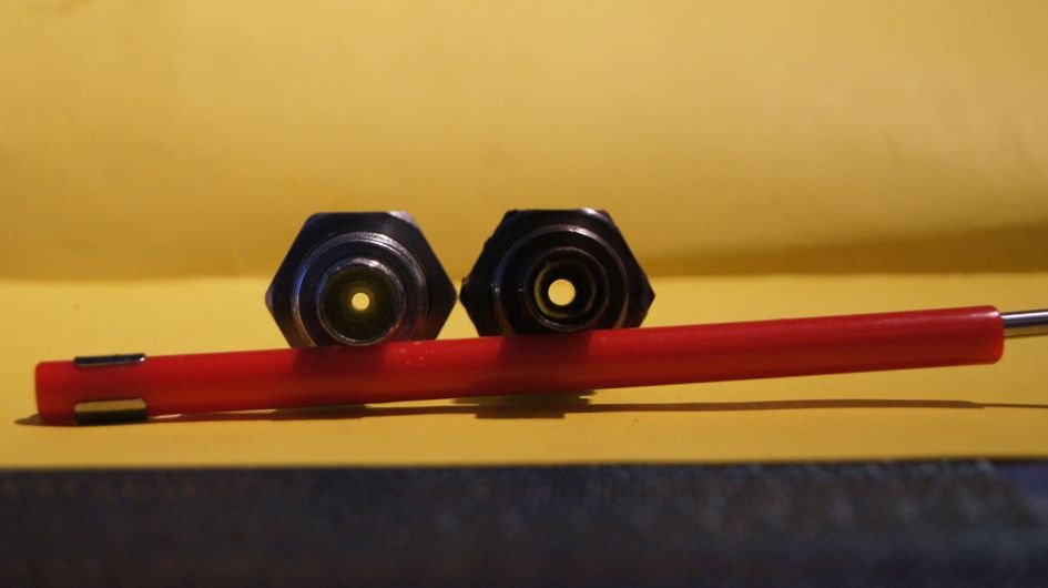

Here is what you need.
https://www.turnone-steering.com/pro...low-restrictor
I have a flaming River rack which is designed also for a lower flow rate than the factory GM PS Pump for the C3.
Here is a picture of the before and after. Left is the unit from Turn-One Right is the factory unit.
Also read this.
https://www.turnone-steering.com/blo...houldnt-be-cut
This covers using flow vs pressure to improve the sensitivity. The kit you refers to pressure reduction.

Thanks for the excellent reference, although the kit I was referring to appears to be exactly the same part that Turn One is offering, but at half the cost.
