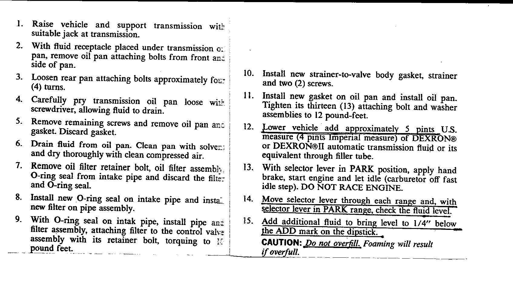

Default Does this help?

Default Written how too
Yes!! I’ve seen videos and walkthroughs but seeing it written is very nice.
Thank you both so much! And, depending on tomorrow’s weather. I may be tackling this tomorrow! Along with my rear differential, power steering, coolant, and maybe engine oil.
