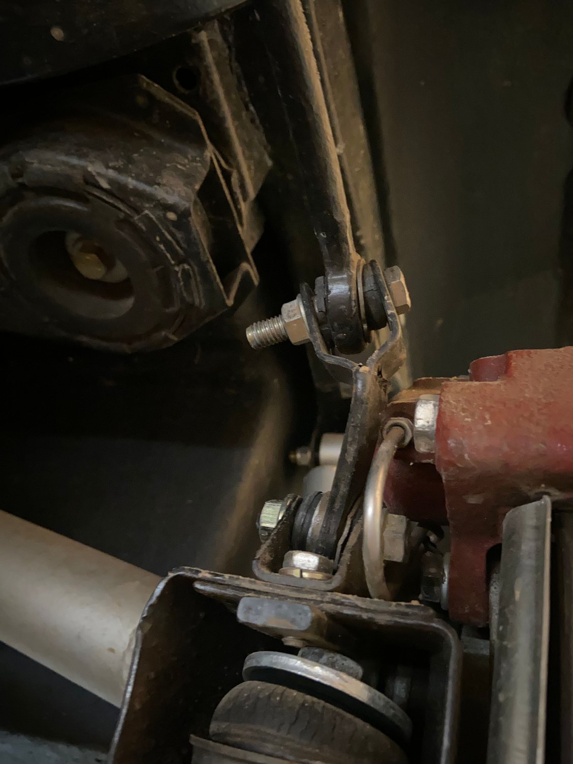

Pass rear Oem swaybar link. Seems to be bending as shown. Drivers side is not bent. I took it off and bent it back straight. This is the second time bending. Any ideas ? Thanks

I'd start by cutting that bolt a bit shorter. I bet it's hitting the frame.
Do you have the rubber suspension travel bumper installed on that side? If the suspension bottoms out, perhaps that is enough to raise the trailing arm up and crush the sway bar mount.
Here's a thread with discussion of the bump stops.
https://www.corvetteforum.com/forums...-too-flat.html
But start with the bolt.

Well that’s exactly what it was. Bolt too long hitting frame. Yes I have the bumpers on. Seems the drivers side bolt was not long.
I'm glad it was an easy fix.
