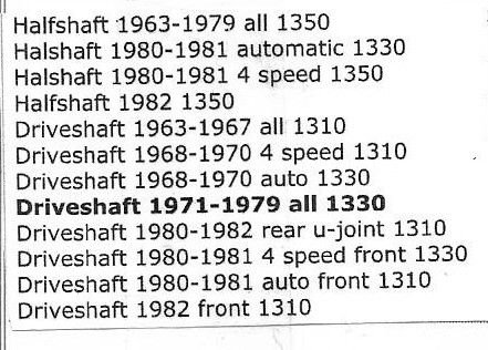

I'm in the process of replacing the u-joints on the drive shaft of my '69 427 stroker. Any idea if this drive shaft is a 1310, 1330 or a 1350...how do I find that out? Been looking on Dennysdriveshaft.com, took all the measurements, #B11 is 1.062, #B10 is 3.6, and the #B10A is 2.4. Closest I come is a 1310/1330. Don't have any of the other measurements as I'm only replacing the u-joints. Your help is appreciated.

Default Does this help?

Thanks, Pete! Where'd that come from?

I copied that chart from the internet and have posted it a few times and no one posted back any problems or corrections.

The above chart posted by Peterbuilt is correct. I did the driveshaft u-joints on my stock 69 big block/4spd and they are 1310's and for an auto trans only are 1330's.

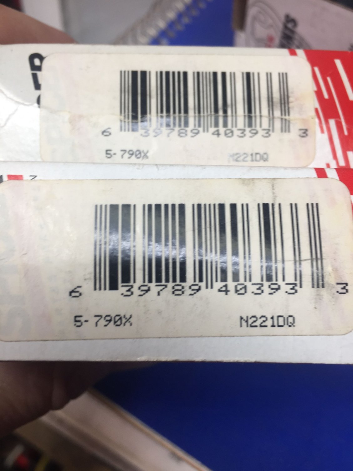

Sorry to jump on the thread, but I have two Spicer U-joints that are supposed to be for the drive shaft on my '68. However, I don't see any numbers anywhere close to 1310 or 1350 or anything like it. How do I know if they are the right ones? Pics included.My car is a four speed sbc
Larger, hand written numbers that are the same from bar code on other side
No other numbers. What do I have? And how do I know that?

Andy Tuttle ... Spicer 5790X is same as Dana 51330X.
Alternate/OEM Part Number(s): 0437104030, 043750C020, 1330X, 2720082Z10, 2720082Z20, 37126EA025, 37126EA026, 37126EA027, 37126EA028, 4L3Z4635A, 4L5Z4635AA, 5014733AA, 5175392AA, 5790X, 68048401AB, 8890402430, 89040243, D5790X, DS51330X, DSPL251X, E5618X, E5742X, E5790X, F2AZ4635C, F2TZ4635B, SP51330X, ZZN025060, ZZP025060
Courtesy of Rock Auto

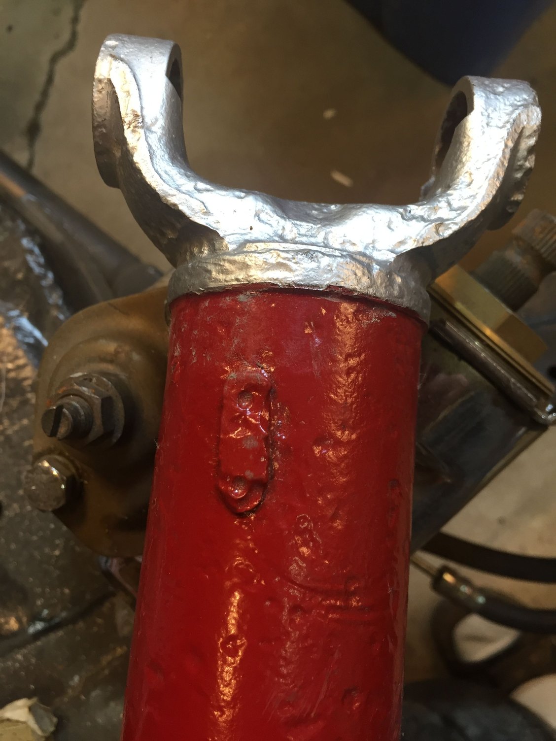

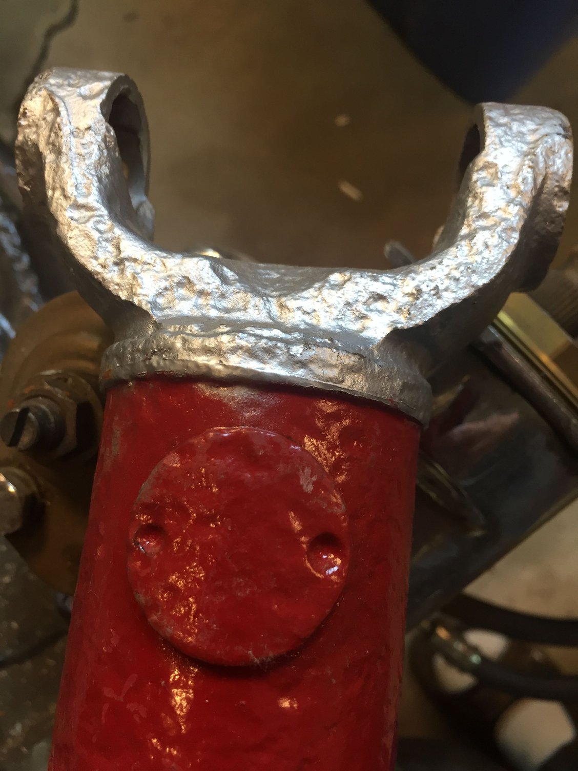

Ok my driveshaft, unknown year, has two additions to the main shaft:
This is the round one, and I would say it left the factory with this. If I was a betting man I would bet this the factory weight or balancer. But I am not a betting man.
This is on the opposite end from the round "weight". I would consider this a smaller mark than the other, and would guess this to be front. Do I win the chicken dinner?

No chicked dinner. Every shaft has balance weights on them. Every shaft has different sizes depending on the balance required. They say it has to be installed correctly,,,,, but like yours,,,, mine is also rusted a lot. I would think any balance has long ago been thrown off from all the corrosion
