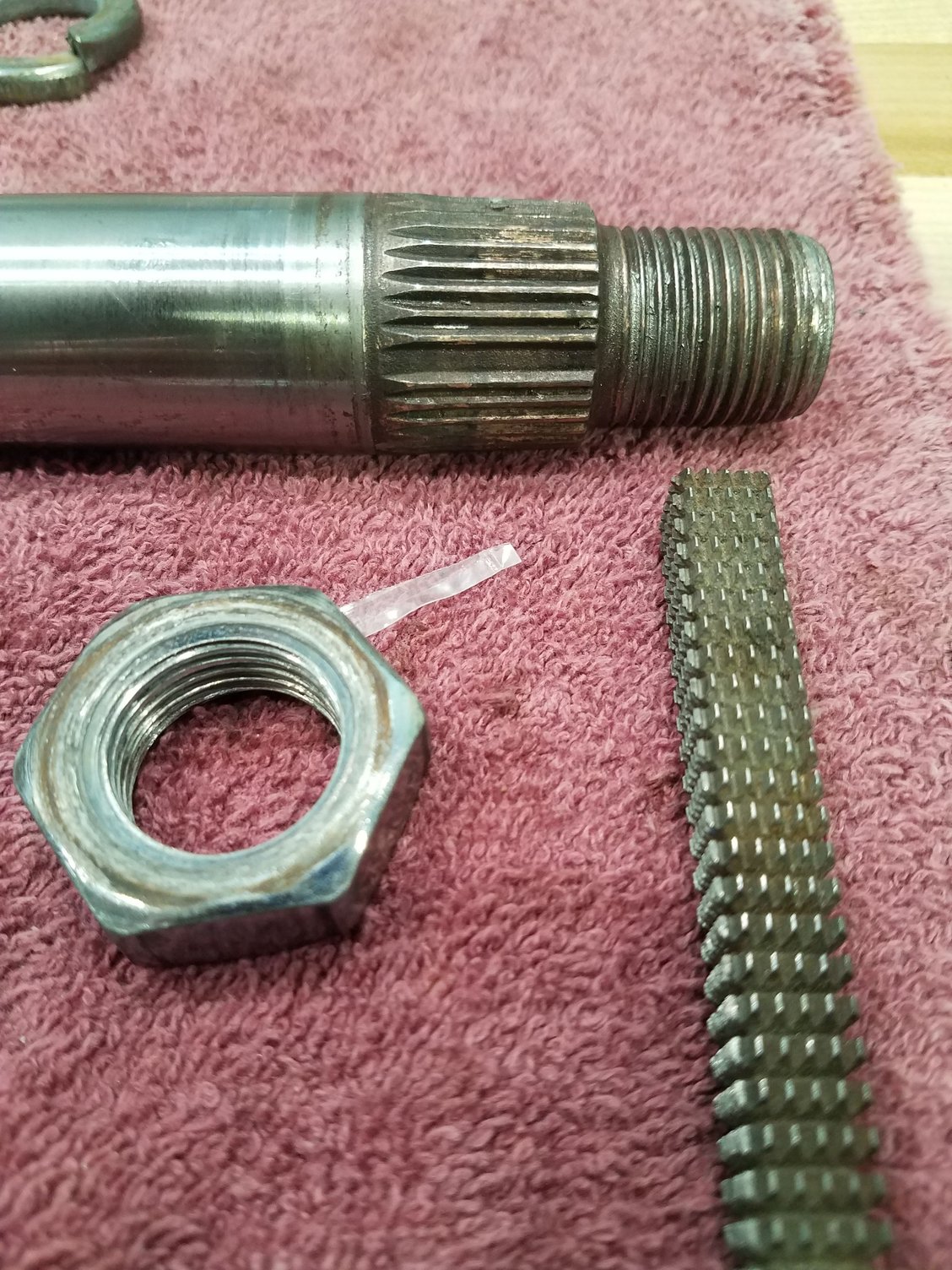

Thread file fixed the shaft, but the nut is buggered.
Who is a good source for that nut?

FastenAll...but I imagine it's not cheap if you buy only ONE.

The new nuts are thicker then the originals. They should be ok with an original sector, sometimes I machine them to the stock size. A good hardware store, industrial supply or McMaster Carr will have them.

Thanks guys. I found an original on "The Bay." $5, done.
