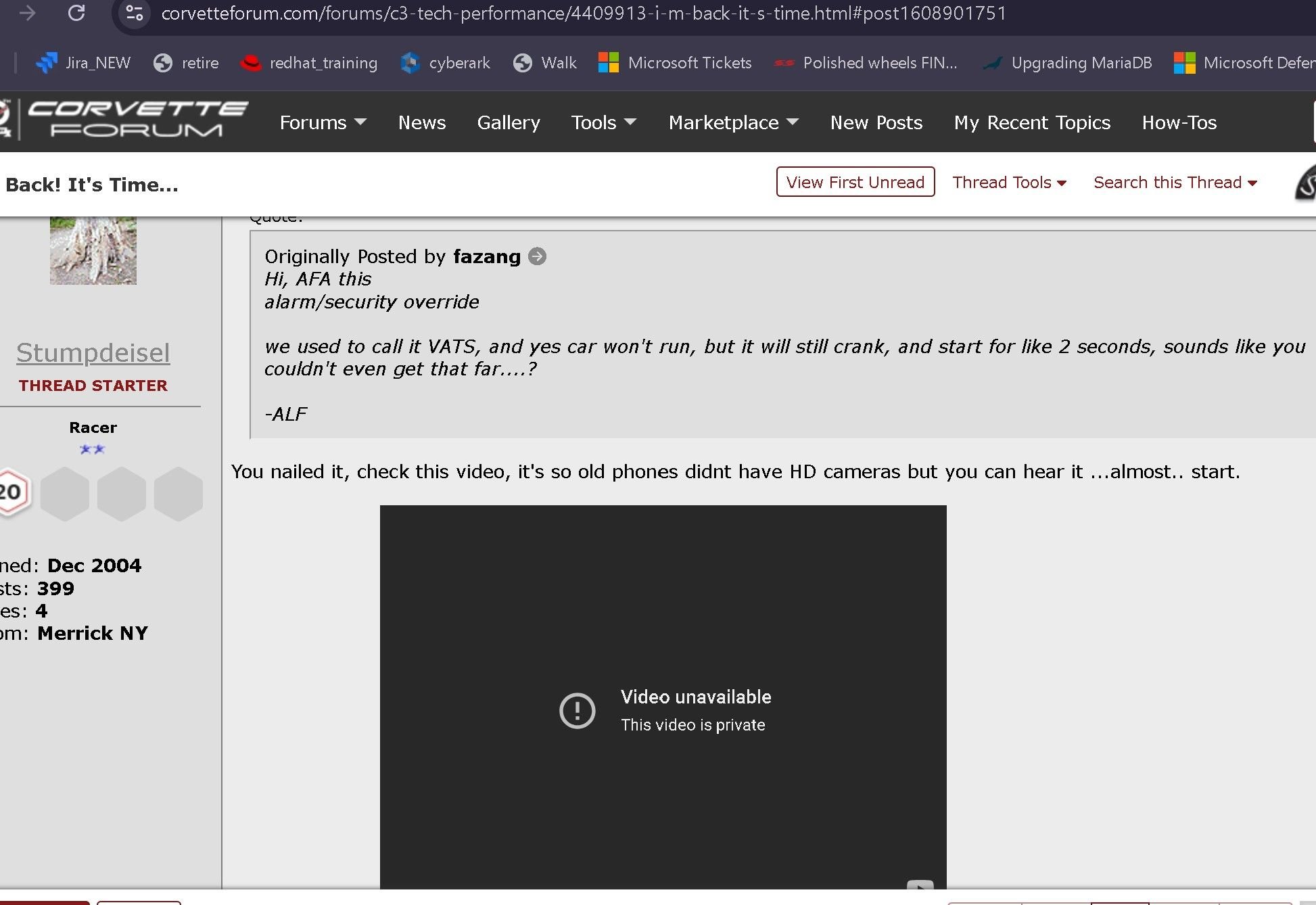

Originally Posted by fazang
Hi, AFA this
alarm/security override
we used to call it VATS, and yes car won't run, but it will still crank, and start for like 2 seconds, sounds like you couldn't even get that far....?
-ALF
You nailed it, check this video, it's so old phones didnt have HD cameras but you can hear it ...almost.. start.

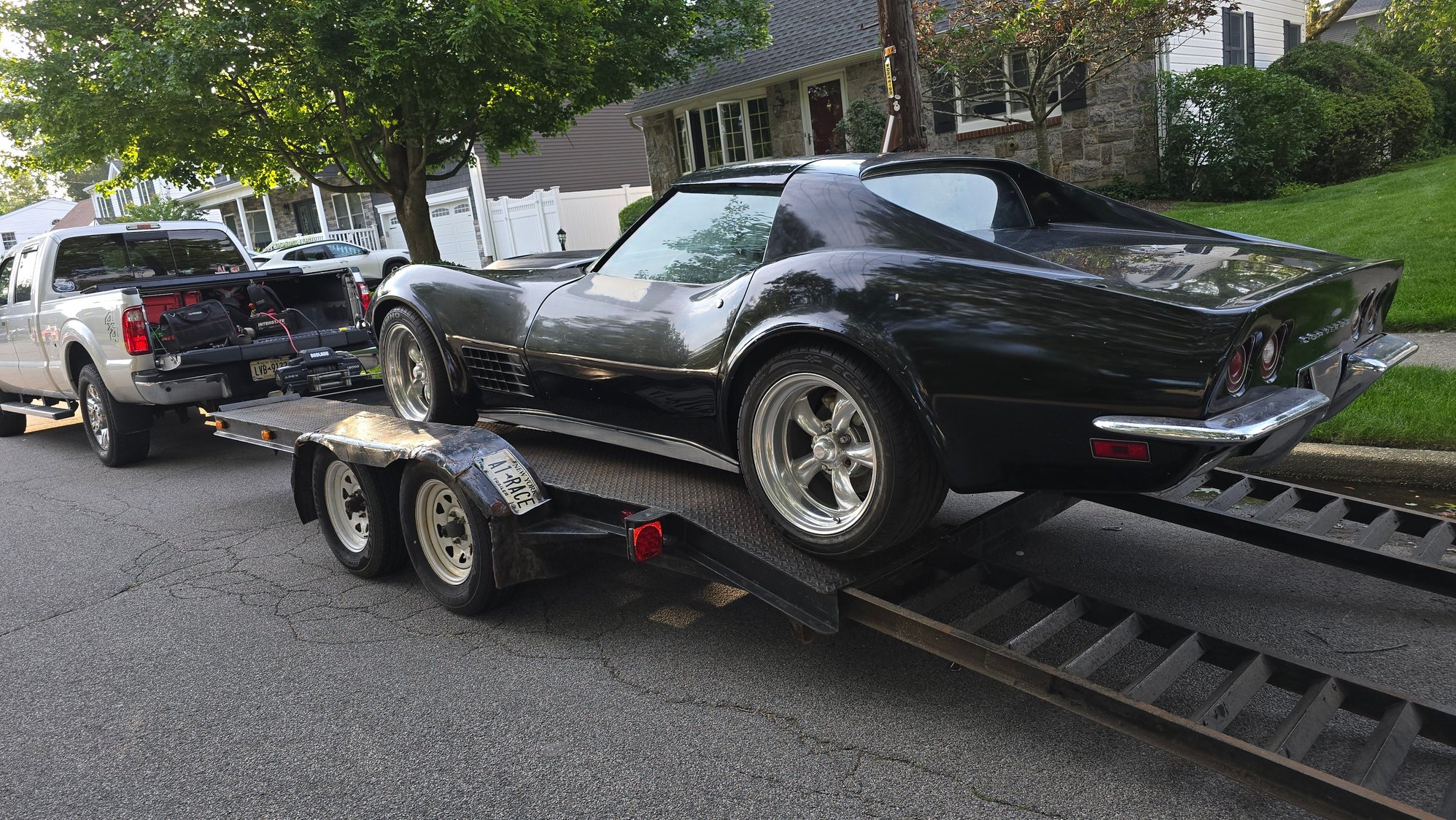

Project Update - pics in my album:
All underside work has been completed:
Brakes: New calipers, lines & pads, rotors shaved
Fuel: New tank w/ internal pump and lines installed
Suspension: All bushings replaced
Rear: half shafts redone & rear serviced
Exhaust: Fully installed
Remaining work:
* Install new harness
*Troubleshoot no spark/injector firing issues for motor to run
*Suspension setup, alignment and tune
*Install the interior and finally drive it!!!
