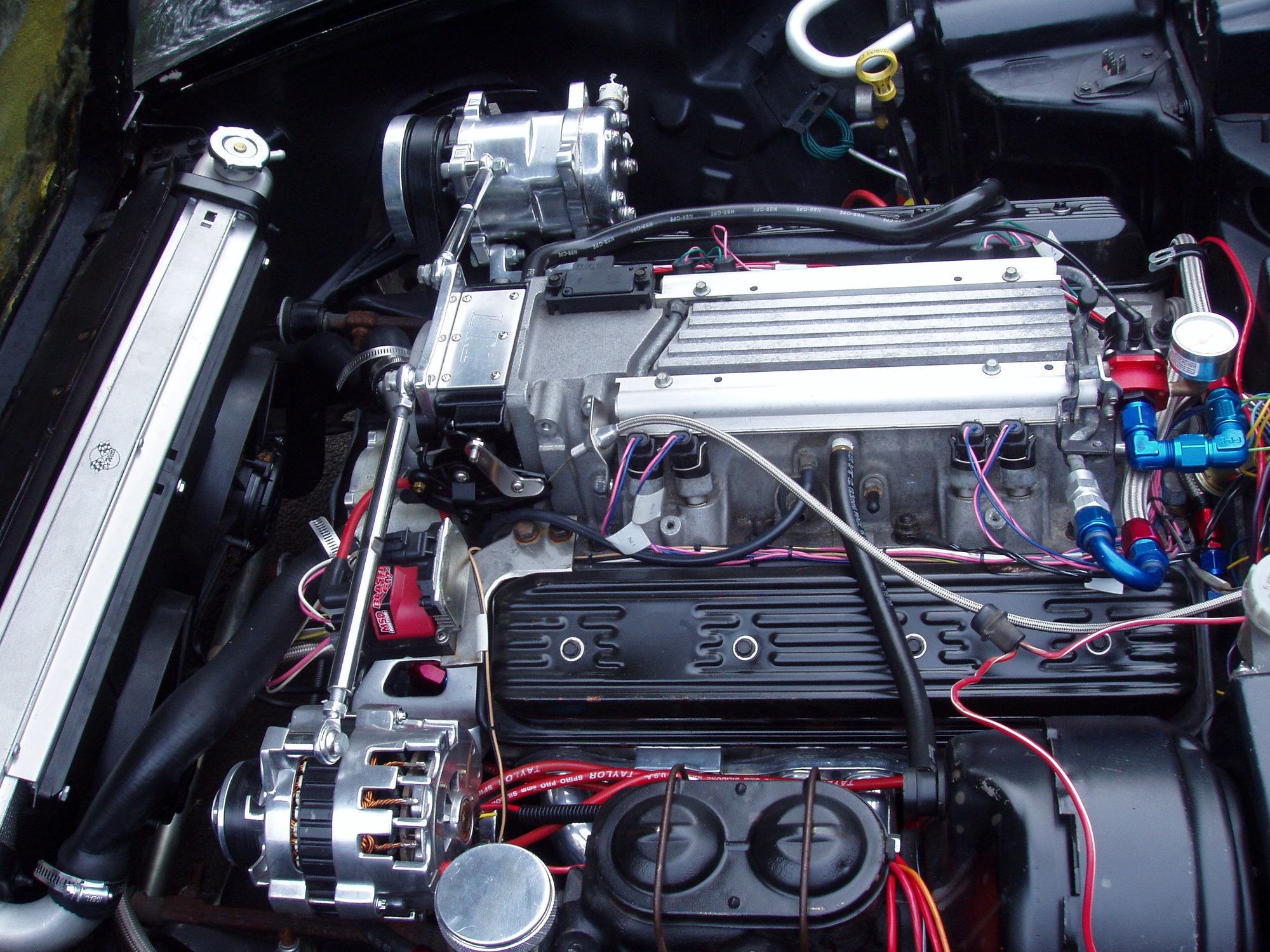

2014, that was my last post here.
House, marriage, kid, life got in the way of finishing my 70 LT1 restomod.
Well between mid life crisis, world craziness, and finally some discretionary funds, it's time to get back into this build!
To recap:
70 vette frame off, completely rebuilt. VBP 1G suspension kit & offset trailing arms, steeroids, T5 with hydraulic clutch, and a rebuilt ODB1 LT1 with hotcam valvetrain and painless harness.
What do I need?
Replace the rest of the original wiring, considering a painless replacement, is this what I should be using? https://www.painlessperformance.com/wc/10413
I fear my external Aeromotive A1000 is burned out, and if it's right for this setup? The cost to replace is high and I read internal tank pumps are preferred?
Electric conversion of the headlights and wiper door. I have the killer lights instructions from years ago, but now see full kits however they are expensive! Are they worth it?
After sorting out these 2 items comes help figuring why I was never able to get the LT1 to turn over, always suspected no spark but have no diagnostic tools or experience to troubleshoot. I'm looking locally for help with this as a shop may be 100 buck if they figure it out in an hour, or 1K...
Finally, once it runs, I can have my exhaust installed and gladly pay a pro to properly set up the suspension, get my interior installed and actually drive it!
Any feedback on the 2 "What do I need" questions is greatly appreciated...

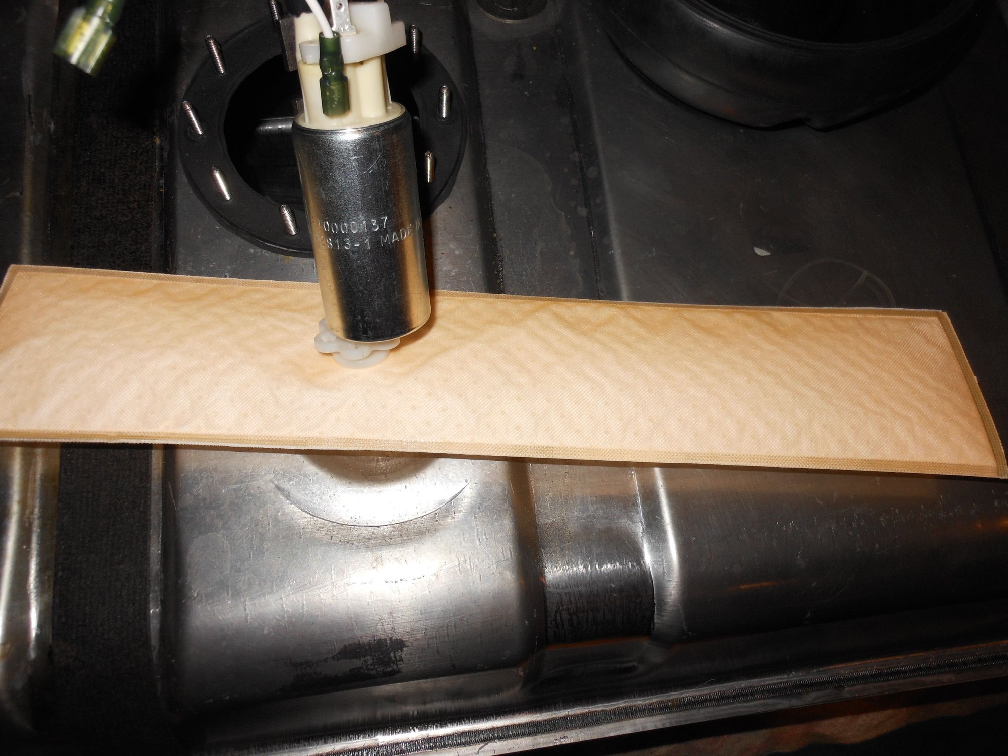

For the in-tank solution- look at the Holly hydramat. They have several different sizes-don't know how did the sump- but fitting the hydramat there would be ideal.
I did the aeromotive stealth set-up and was DISAPPOINTED in it- the aerospace foam dissolved in just regular pump gas. The guys at the factory admitted it has happened...
As far as wiper-headlights-
I have a PDF put together and can send re: doing a DIY Miata/Probe motors - also have a PDF for the bracket sizes. email me- richard454 at comcast dot net
The problem with the killer lights is it requires a module that is tough to find and expensive. Miata/Probe can be done with a simple Bosh SPDT relay- no external electrics required
For the wiper door- I used a rear wiper off a SUV-
Holley hydramat-
Aerospace foam that dissolved in pump gas- they (Aeromotive) said i could BUY a replacement foam!!! Not!!!

I just finished the installation of a Holley Sniper Stealth EFI system on my 1968 C3 and I was very happy to learn that Holley offers a replacement fuel level sending unit that has the fuel pump (Walbro 255) and a fuel regulator on the same part along with a new Fuel level sending unit. The one piece makes your Corvette ready for EFI systems. The whole part was $350 or so but included a piece of the new Hydra-Mat from Holley and the Fuel Pump and fuel level sending unit. It took me about 20 minutes to swap out the parts and my fuel system was done.
The Hydra-mat is amazing material that will pull fuel from anywhere in the tank. It by itself is very expensive so getting a small piece was really nice of Holley. I had planned on getting a new EFI fuel tank but saved a lot of money not having to do this. On my Corvette the gas level sending unit was installed from the bottom of the tank. I use a bit of grease to hold the O-ring in place and re-installed it.
By the way, the Aeromotive Electronic Fuel Pump Controller is a great device but a bit too expensive for most. I have one from the electric fuel pump system I was using before. My Holley Sniper does the priming like the C4's do and will not allow the use of the Aeromotive controller. The Aeromotive Controller uses "Pulse Width Modulation" to control the speeds of the fuel pump. Holley told me that PWM will not work with the Walbro for very long as the Walbro was not designed for this type of control system. I would have to ask Walbro before I took Holley's word at this.
The Aeromotive controller is very small and very compact. I loved the way it worked on my Corvette. The new system is so quiet that you don't hear the pump running unless it is priming before startup.
I still have the Aeromotive Billet Electric Fuel Pump Controller Part #: 16306 in perfect condition with less than 2 hours of use on it. It would probably work with your Aeromotive Electric Fuel Pumps I would imagine. A quick call to Aeromotive would answer that question. I used it on my 1968 C3 with its 427 with an electric fuel pump in place of the original engine mounted fuel pump. The newer system is so quiet you get spoiled fast with the in-tank fuel pump!
