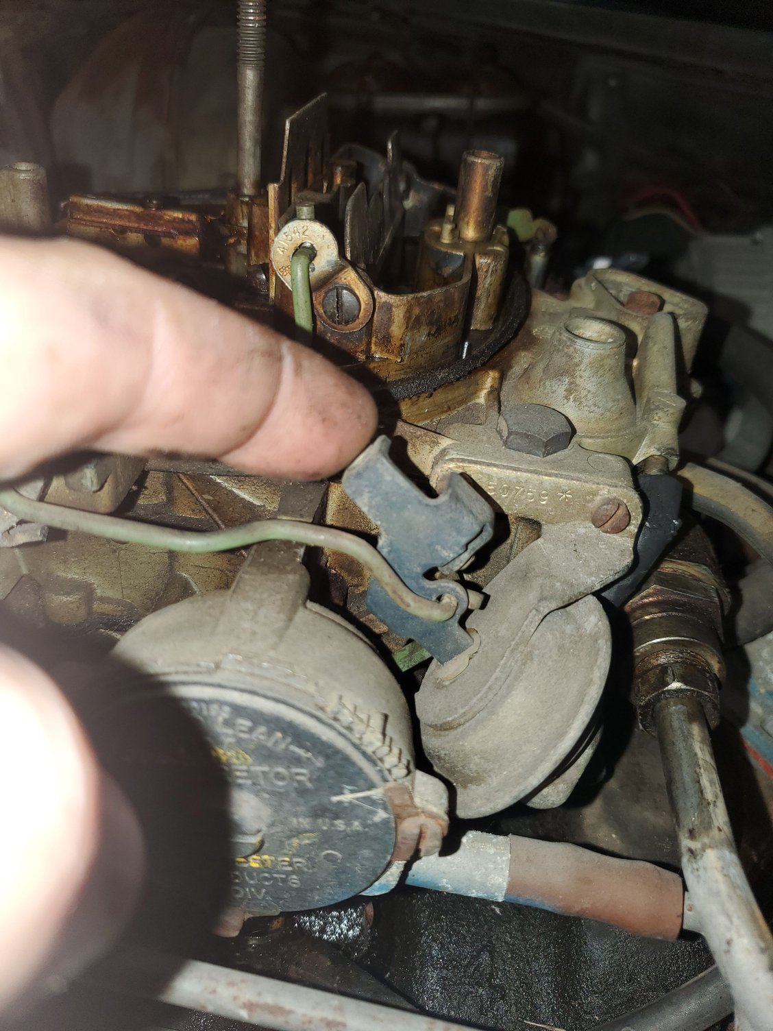

Can someone explain to me how a quadrajet works? I don't understand how my secondary is supposed to open?I replaced fuel filter and I think I'm not getting enough fuel cause I can't floor it or give it more than half throttle in all gears. If I do the car starts shaking I just dont whats not working. It doesn't seem like it will open with vaccuum.

Push your finger down on it......on the secondary air flaps.....do they open freely and snap shut with a slight spring load? Did you post in the C3 page about this on FB? If so, I am the one who told you to stick a filter in it first.

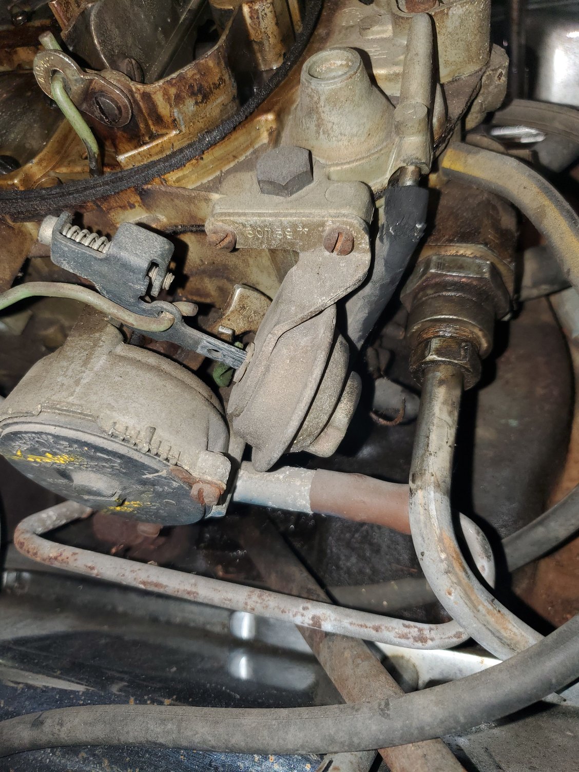

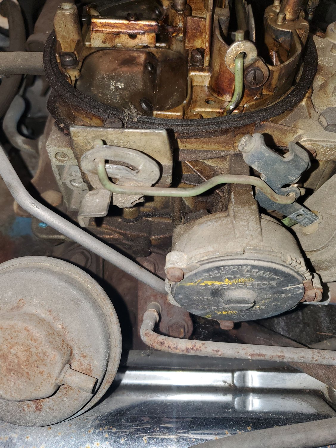

what you were pointing at is the choke pull off. Push it in and watch the linkage its attached to move, then open the choke valve while you have it pushed in and see what other linkage moves behind that black plastic disc which is your choke. In your pic theres a tip of a rod (secondairies rod) with a post through it. That will have a swinging arm that prevents it from moving. When the car is running you will see choke pull off pull on that linkage which will allow the choke to open once it gets to the required heat setting. When the motor is cold there is a small lever that holds the secondaires closed. If you look on the drivers side you can see the lever that travels through the carb Secondaireies and see that it is spring loaded. When you move the throttle, the lever for the secondairies will move but only the spring will twist until that lever on the other side is out of the way. if you find the lever for the choke on the passenger side, you can hold it open manually, open the choke valve, then flip your thottle and see the bottom valves move. You have to manually open the top flap and hold it open to see the lower valves open. the top opens with the air flow when the air is drawn in.
Here is a video of a different style choke pulloff on a quadrajjet but you will see that lever that I was trying to explain. If someone messed with it or the choke pull off is bad it wont release
Now if you have everything connected correctly, and the choke works and with the engine hot you can see that the secondairies are working, you may be experiencing the quadrajet bog. Its what happens when that secondairy air flap open too quickly and your car runs lean all of a sudden. there is an adjustment for that doors spring to make it resist openning too quickly. But make sure your choke is functioning correctly first before messing with the flap
