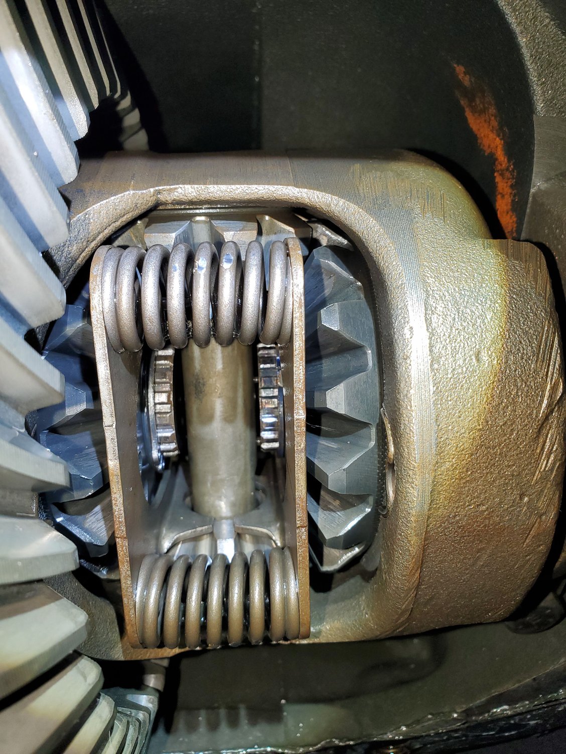

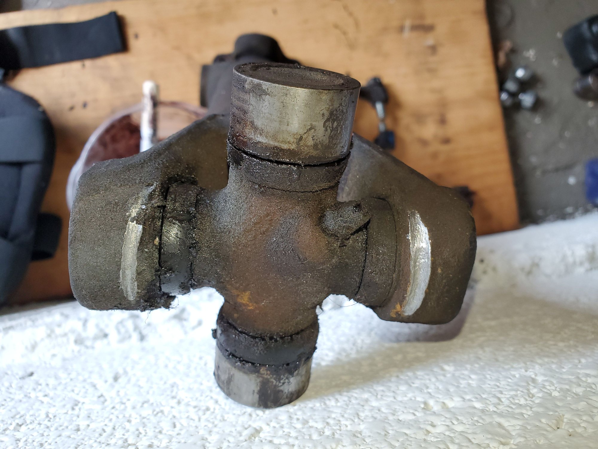

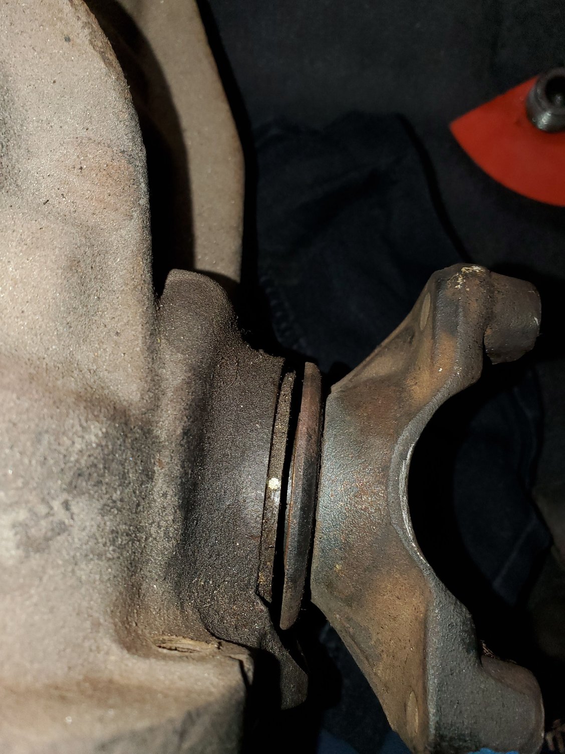

Well, I finally got the differential out and opened. I think the noise was coming from the u-joint that connects the drive shaft as it was fused on to the differential. The bearing came out with the differential. That still doesn't explain the play in my axles because the inside is in perfect condition and they're the heavy duty ones. Now that I have the thing out I can see that thy were changed, weird though only 76k miles. What I'm wondering about is the in and out play and the space that appears like something is missing on the axles. Not sure if it's the seals but if so why no leaks. Please see picture. Thanks in advance for the help from all of ya'll.
