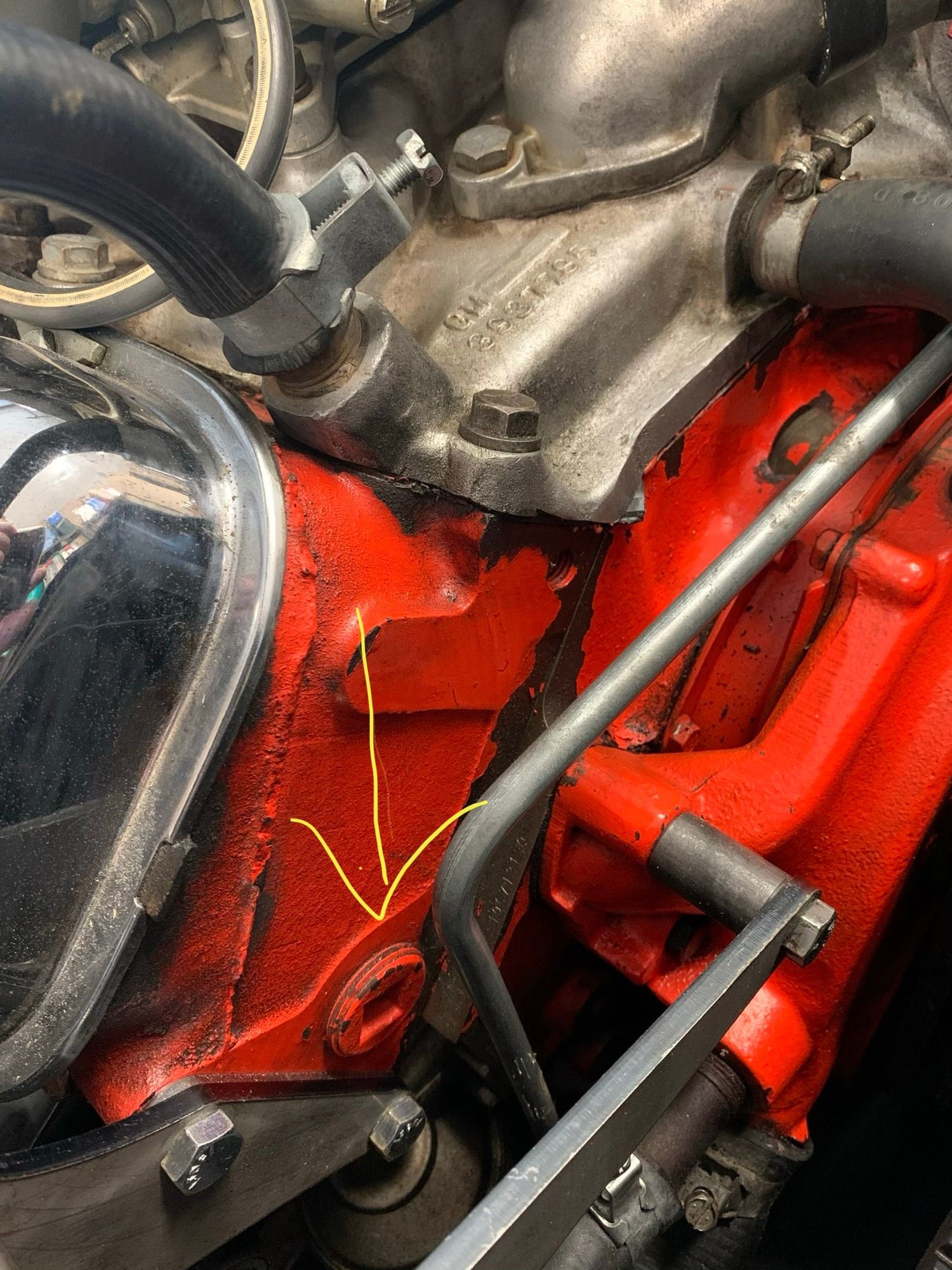

if I do install a temp switch what is the best location? Engine block? See below for a pic of a plug on the front of the block that may accommodate the switch.

This port?
Old Jun 14, 2020 | 11:12 AM
Big2Bird's Avatar
Big2Bird
Joined: Dec 2006
Posts: 8,837
Likes: 1,028
Ruh roh. I forgot BBC. LOL
Those plugs on the heads are not too easy to remove.
Skip the switch and cap the wire for now.

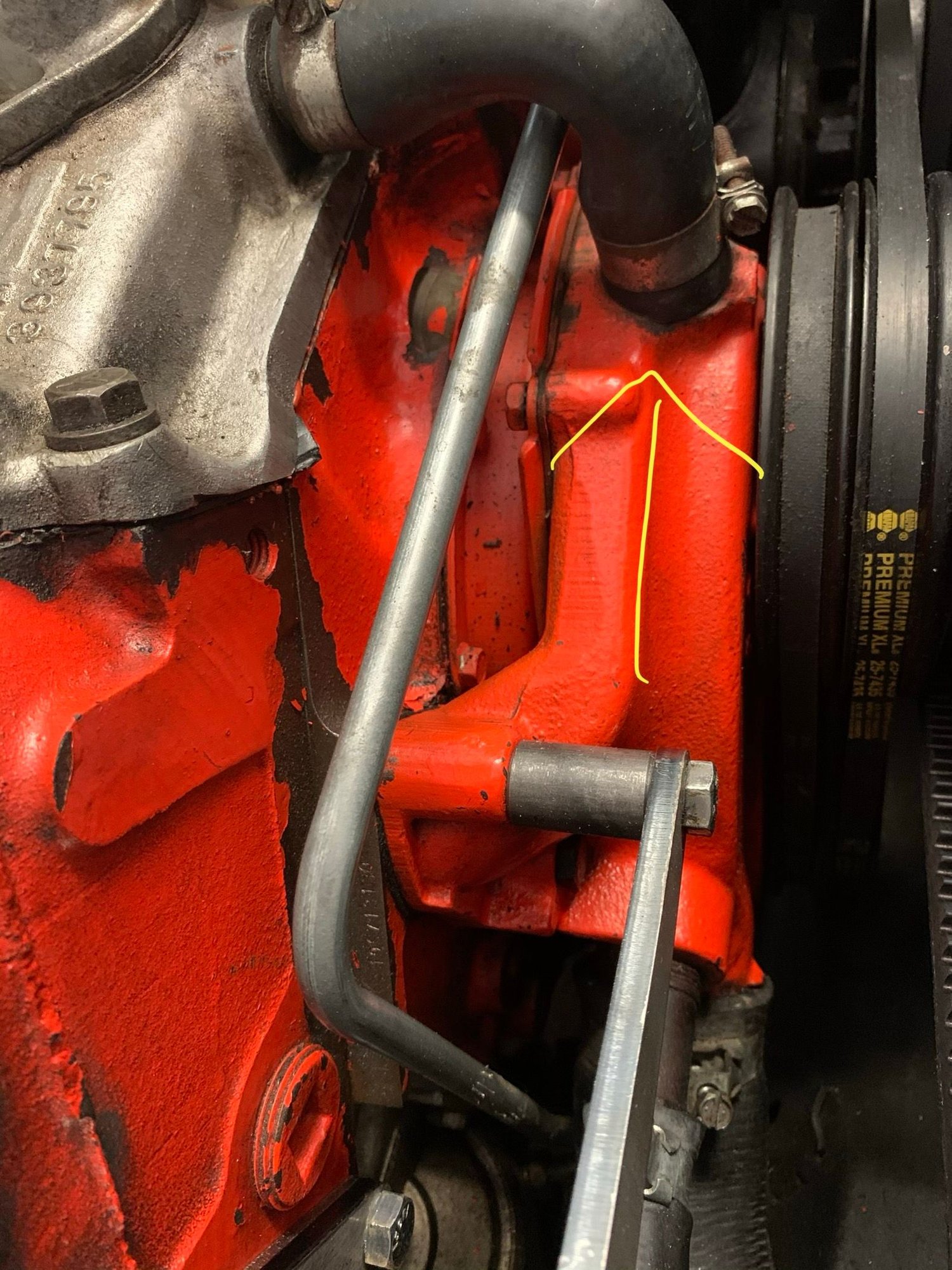

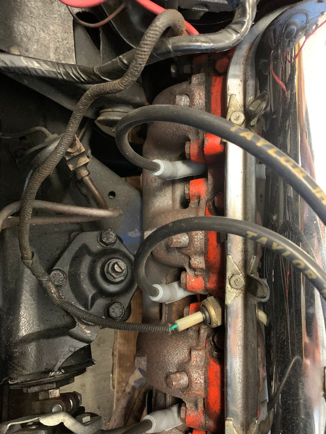

Here is a pic of driver side temp sensor. What does it control?
there is an available port on the passenger side. See pic below.

I’ve used the big port on the front of heads to run manual temp gauges bolted directly into each head on my drag boat motors.
This was back in the ‘70s and the heads were only a few years old.
Those plugs were near impossible to get out back then.
Now after 40+ years, I would think they would be rusted and fused into the head casting from the inside.
I would try to find another location and forget about pulling out that plug.
Just my opinion.
That is your water temp gauge sender. The other unused port would work perfect.

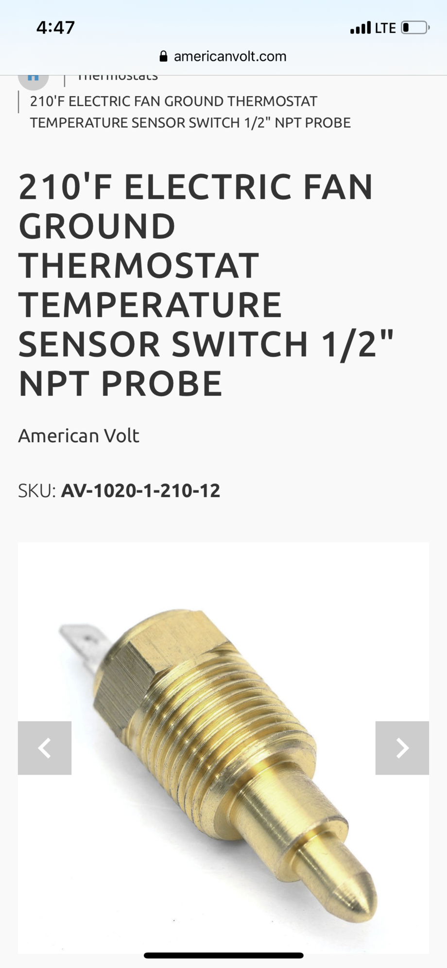

What temp sensor should I get? Car normally runs between 200 and 210

How about this one? I’ll have to confirm the thread size?

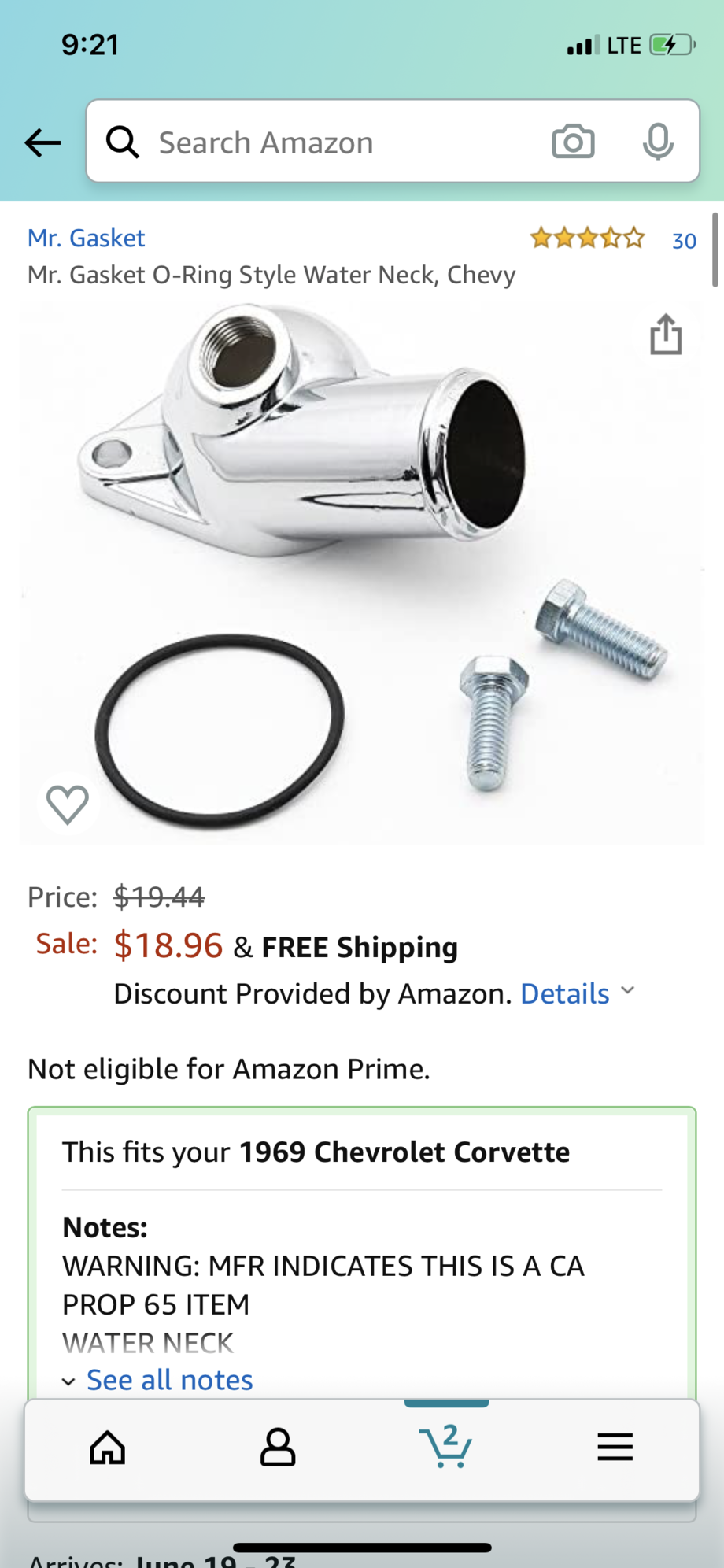

I'm using a thermostat housing that is tapped for a temp sensor.
https://www.amazon.com/dp/B00S75FFUK?tag=duckduckgo-d-20&linkCode=osi&th=1&psc=1 https://www.amazon.com/dp/B00S75FFUK?tag=duckduckgo-d-20&linkCode=osi&th=1&psc=1
That would work. They have reducing bushings that will make it fit. That head is 1/2" NPT

The square plug in the engine block will not budge. I actually rounded it off a little. I don’t have access to an acetylene torch
Any suggestions for an alternate location for the temp switch?
https://www.amazon.com/dp/B00S75FFUK...osi&th=1&psc=1
This is a good idea. Just buy one and look at it assembled, then see if you like it. Most anything like that can be done to "look right."

Here is one that will work. Just not sure I will like the look of the sensor sticking out of the top
