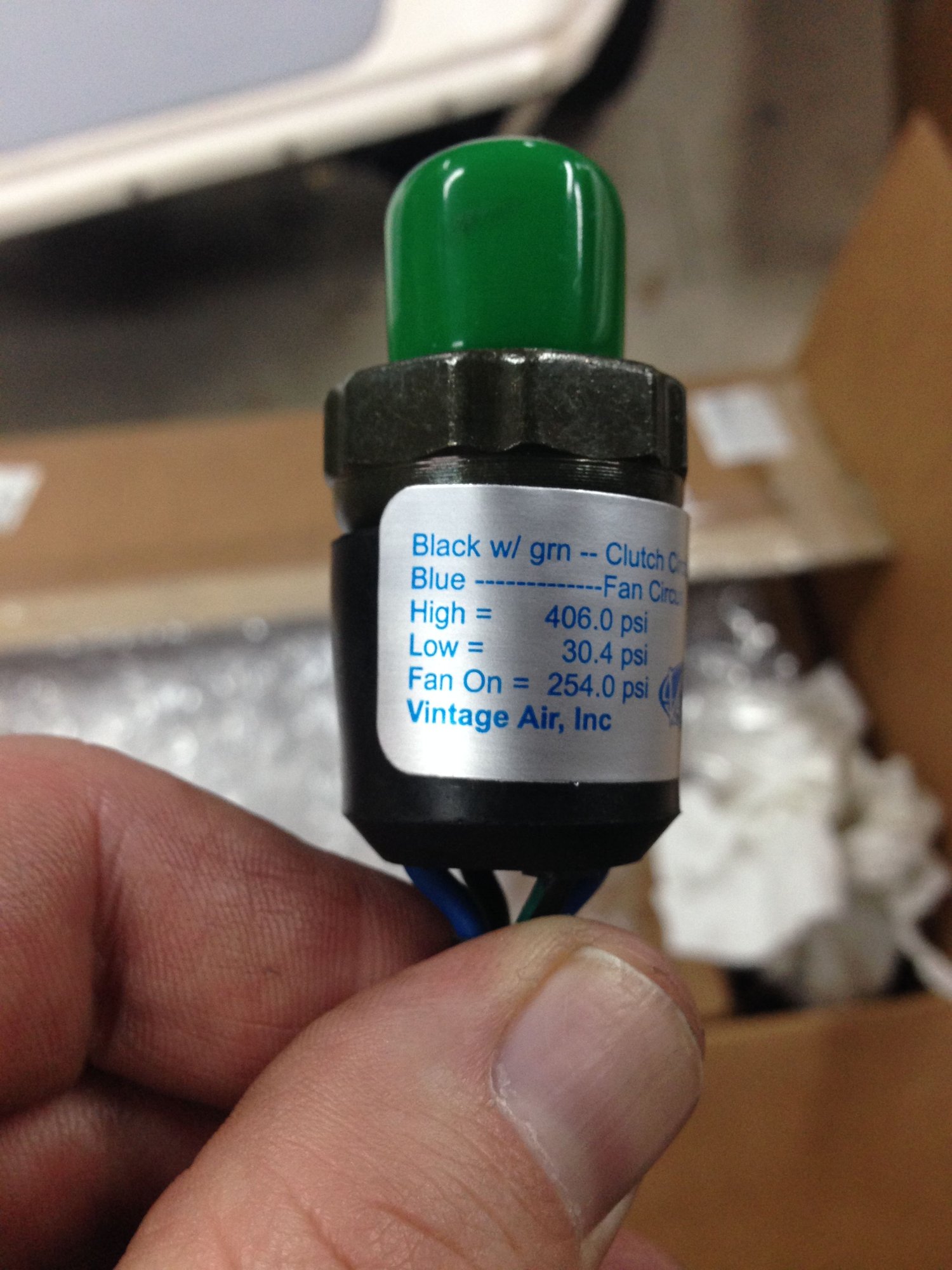

I dont think you will need a temperature controlled switch for the condenser fan. As you stated, this AUX fan is only for the condenser when it reaches a certain pressure (254 psi). I dont think engine temperature really needs to be a considered variable when it comes to condenser temp/pressure.
My aux only comes on in stop and go traffic on hot days. You could wire up a switch to ground an just flip that to see if you get any benefit. Most AC systems like a cool condensor. A lot of cars do run the AUX condesor fan (if equipped) all the time when the compressor is engaged but I just dont think you need that or an engine temp controlled switch in this case. Let the trinary call it if it needs it. Just my $.02. I would leave those coolant plugs alone.

good advice thanks. I will just let the pressure switch tell the fan when to kick in.
