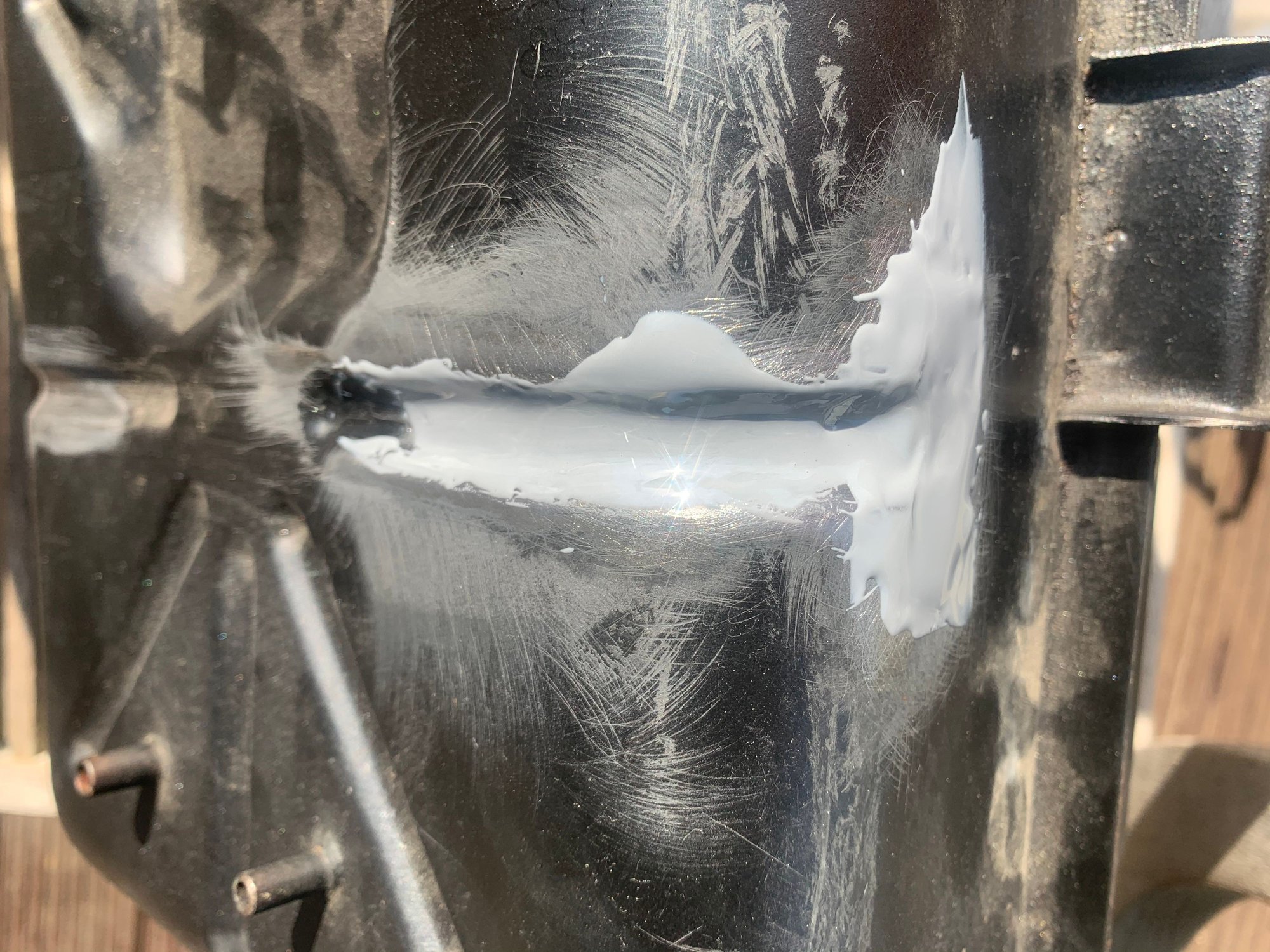

Originally Posted by MelWff
I can see the tank but I have no idea what that strand like substance is. Find a radiator shop and ask them .
I sanded off paint and found a crack

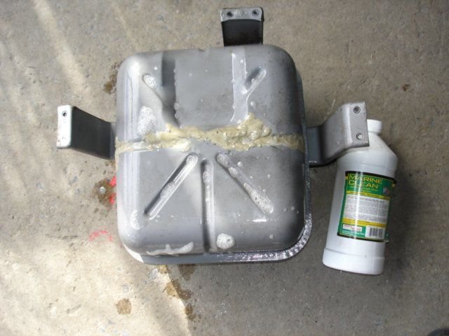

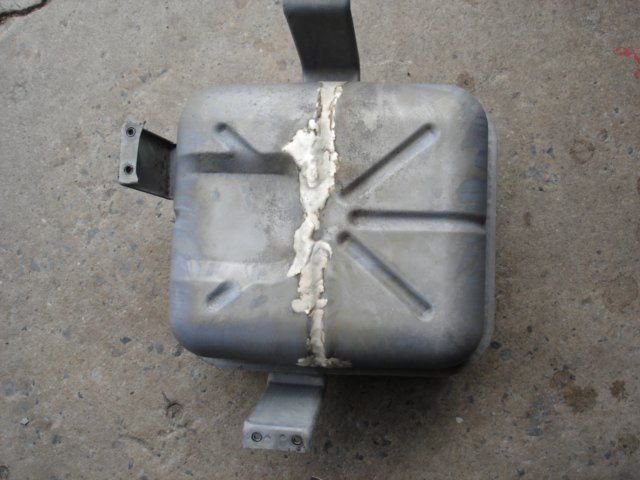

Here's a GREAT fix it from "Dub"
https://www.corvetteforum.com/forums...nk-repair.html

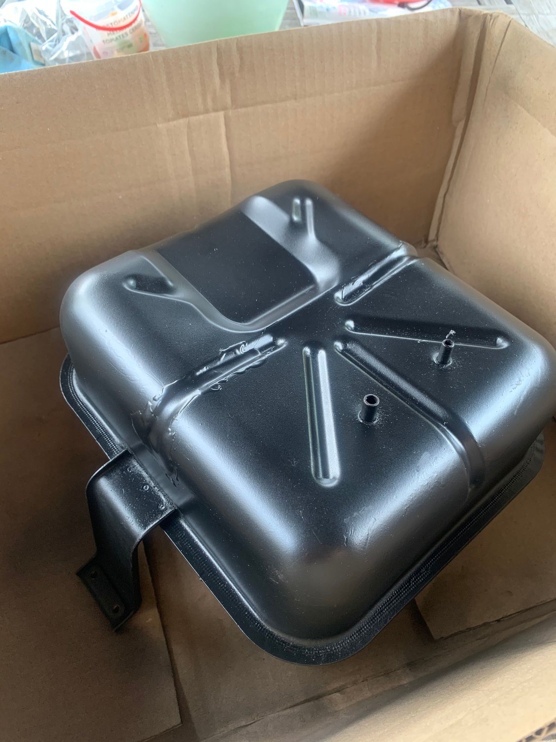

Keep the original tank so you know the support brackets and holes will align properly. I had this same problem on my tank with multiple cracks on different sides. Someone before me used some kind of epoxy to fill the cracks but the epoxy failed. I taped over the vacuum nipples and covered the cracks with tape and then removed the paint and exterior rust with a glass bead blaster. I had the cracks tig welded. A good welder will pick the correct rod and welder setting to keep from burning through the metal. The welds are barely visible. I powder coated it black and then used POR 15 inside the tank. I wrapped the tank in stretch wrap to protect the paint while putting it back in and then cut the stretch wrap away before final tightening.

Gentlemen, thank you all for the great input, you empowered me.
Brazing or soldering is beyond my ability at this stage. On the other hand I’m confident that I don’t need to farm this out to a radiator shop.
I noticed that in addition to the hairline cracks that follow the groove, the ends have some as well.
Can’t go wrong with Loctite. For metal.
It flows well. I made sure to sand with 60 grit to make sure the epoxy will have good purchase.
And a lick of rust contain and prevention paint.
I pressure tested the tank. It seems to be holding.
