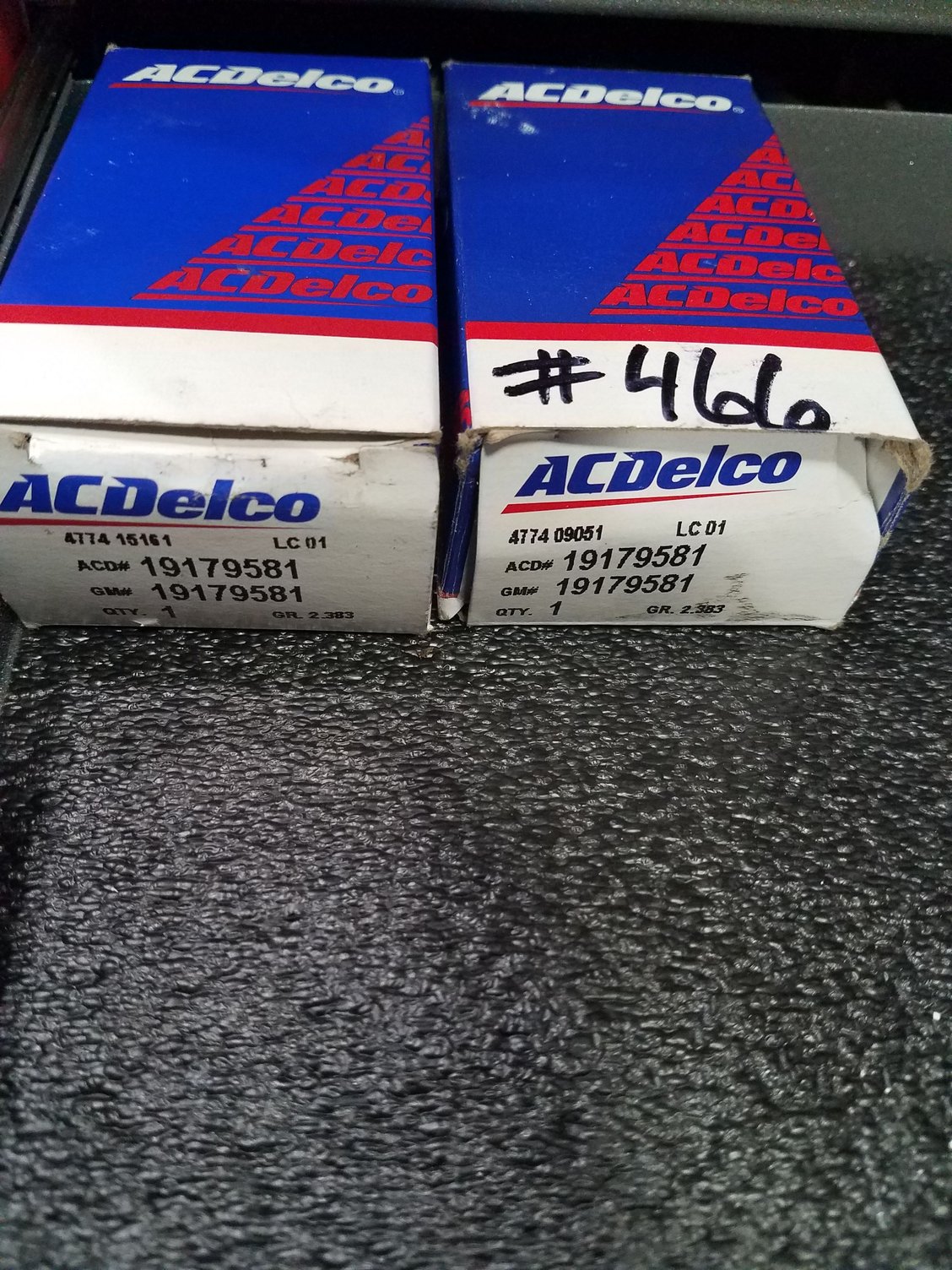

Originally Posted by Big2Bird
Oh boy. They use crap modules. Can you drive it with the tach unplugged and see if it still has those blips of power loss?
Swapped out the module, problem solved. This is the second module that has gone bad on me. Last one left me stranded. Who makes a good one?

Old Jun 18, 2020 | 09:40 PM
Big2Bird's Avatar
Big2Bird
Joined: Dec 2006
Posts: 8,837
Likes: 1,028
