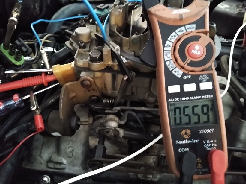

Next I tuned the carburetor. Set the throttle position sensor to 0.56 volts at idle.

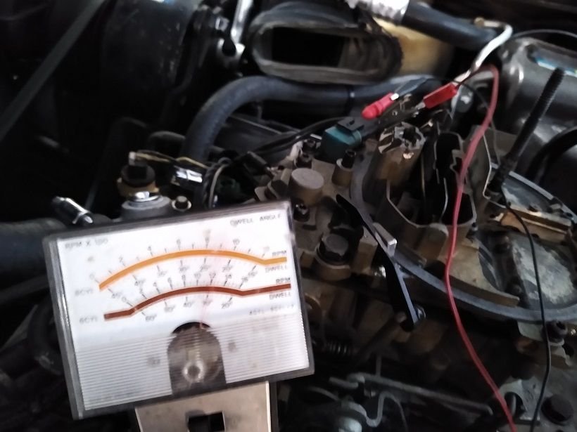

Next I adjusted the idle mixture screws to 3-1/3 turns, then set the idle bleed valve to 30 degrees dwell.
I'm still having the same problem. Again, idle is fine, cruises OK, the problem is transition from off idle is not smooth at all Feels like it is missing one cylinder.
I double-checked the timing, set initial at 8 degrees BTDC, the computer increases it what seems to be a reasonable amount, and I get spark at all eight cylinders.
Maybe I have a dead cylinder, no compression? The car gets up to 95 mph on the highway though. Probably more, but you know how that goes. I guess I need to test that next unless anyone has a better idea.
