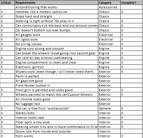

Hi and Welcome to the group!
This group helped me tremendously when I was (am?) modifying my 68.
One thing I would highly recommend is to first lay out what you want. I am an engineer to I am going to say "requirements" because that is what you want the car to be.
The reason I say this is because the Good Idea fairy shows up every day and it is easy to never know when you are done.
Then I would run the list by the group and get some feedback on what people recommend for meeting those requirements.
I will give you some examples of some requirements and the impacts that they have.
1. No wiring issues and all lights and gauges work.
This directly translated to just biting the bullet and putting in a whole new wiring harness. Invasive and a little pricey but it was the right thing to do for my 68.
2. Handles like a modern sports car.
This one I wish I had some help before I set off on it. EXPENSIVE! And easy to go down the wrong path. And really, in the end that was not what I wanted. I wanted it to handle great but not lose its character.
All I am saying is that a little planning and being honest with yourself will do a long way. Originally I had A/C on my list. But then I realized how I like driving the car (tops off) and it didn't make sense anymore.
Below was my list. Just for reference. You will see that after I restored my current paint (and I found out how much a perfect exterior would cost) that was deprioritized too.
