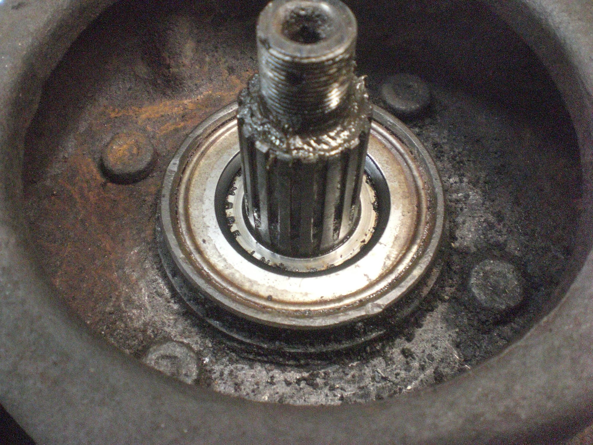

Here's the inner side of the TA with the flange removed.
When the TA was lifted straight up, it easily slid off and the spindle/hub just stayed on the workbench.

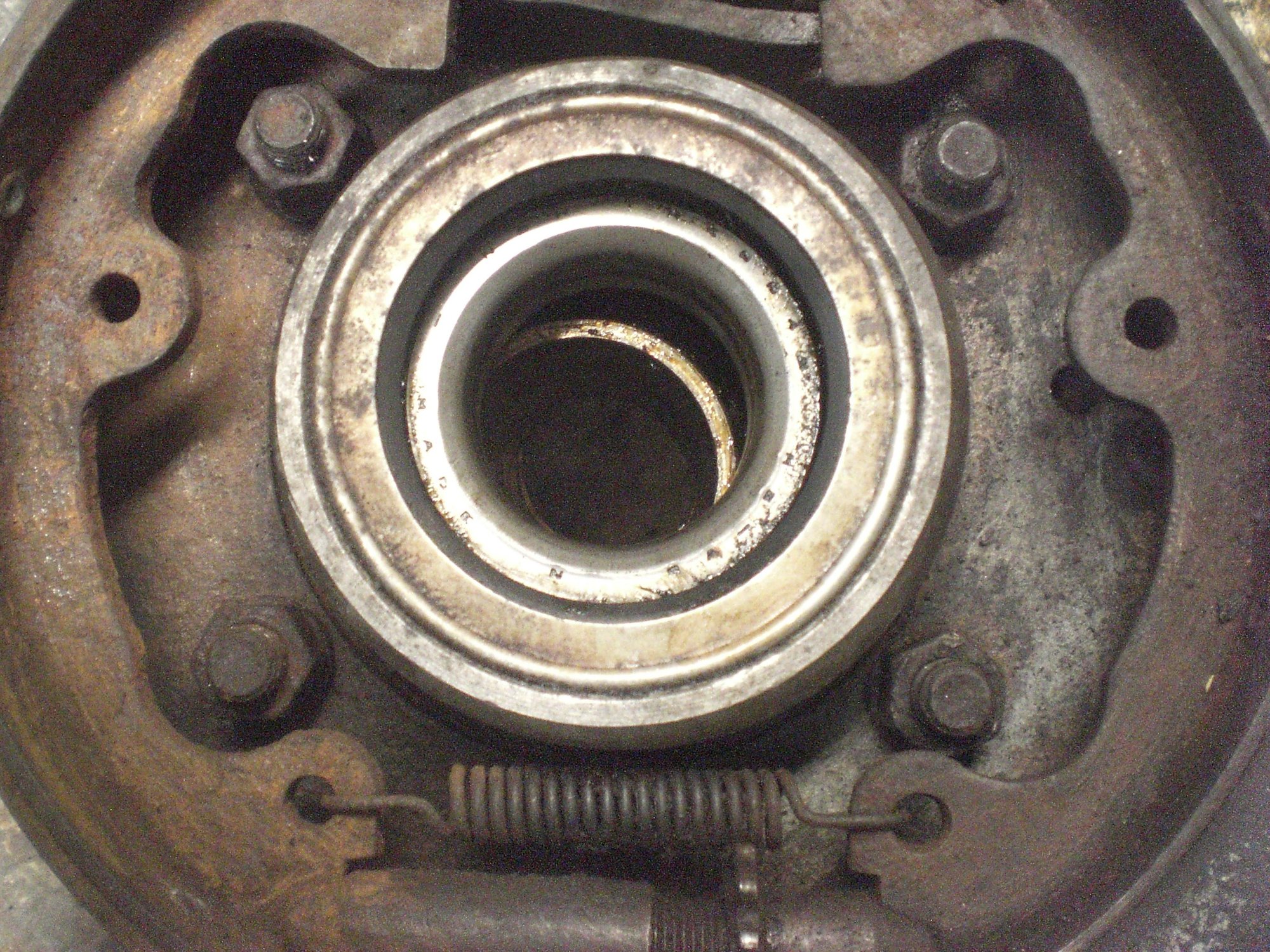

The inner and outer bearings stayed in place but the "spacer"(?) between them is quite loose.
The inner space sleeve can just wobble around. I don't think that's normal...

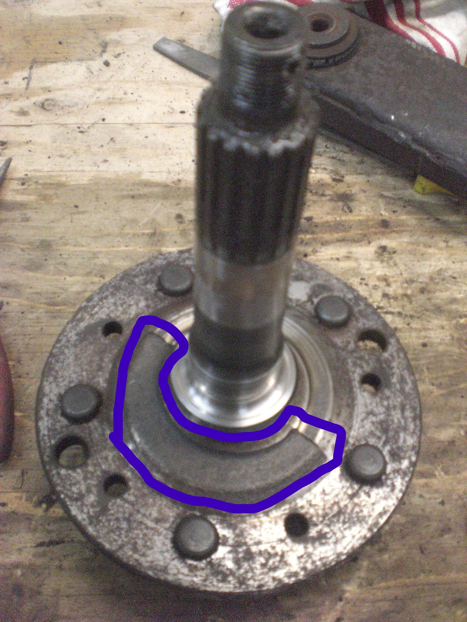

The spindle hub itself appears worn around half its circumference.
The spindle shaft itself doesn't look too bad.
My guess is that I'll have to replace this spindle.

The axle is probably undersize from someone slip fitting it or previous wear. It is no good and since that is such an obvious mistake who knows what else you will find. There is no inner shield unless you removed it, no sign of grease, the bearings are old they are stamped not etched as they have been the past 20 years.
Mic the axle, it should be 1.188 & 1.376 under that and its a door stop OR you can make a setup tool out of it and build them yourself- you can't do it much worse then that! It is NOT rocket science, the bearings are common, it is just a matter of being able to correctly setup the bearings - there is a window of 001-008 per spec or everyone tells you 002" is the magic number. The real dial-in is to set them up with -0- lateral play and they will live longer then probably most of us on here.

The TAs themselves have not been rebuilt to my knowledge. The last time the car was on the road was 1989 and I believe the bearings may have been replaced in '80 and/or '85 but the maintenance records don't really specify front or rears in all cases. That apparently checks with the stamped bearings rather than engraved. The shield was there, but I removed it to get the E-brake pins for another forum member and it was still off when the pics were taken.
The axle mics at 1.1890 and 1.3775 using my cheapo HF digital unit.
If those axle measurements are OK, can this still be used if the hub area circled above is ground down for 180* ?
In other words, if you were to rebuild this whole TA, would this be replaced or reused?

It is possible someone polished the ID of the bearings way back 40 years ago, who knows. Your measurement if correct shows a good axle however you can see where the outer bearing spun. If I was working on that axle I would lightly polish it in my lathe and recheck it. A quick "gauge" you can use is simply a new outer/inner bearing. They should not slide onto the axle, they should both require a press fit.
