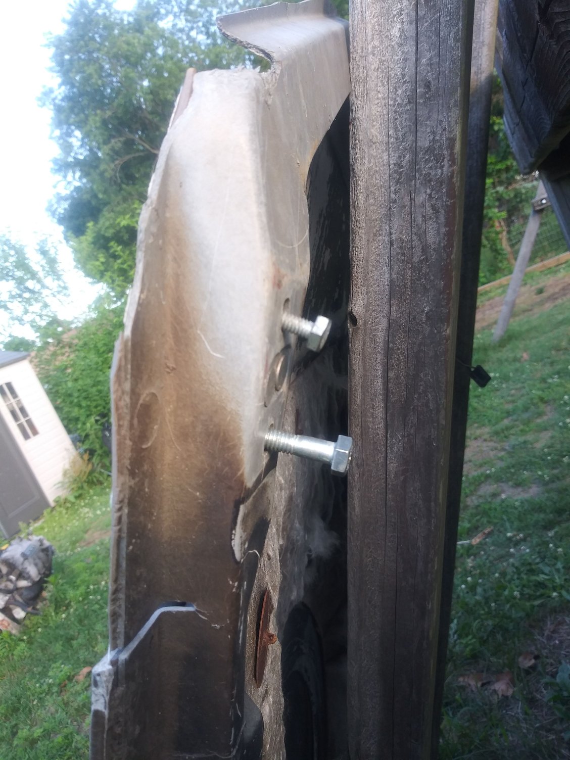

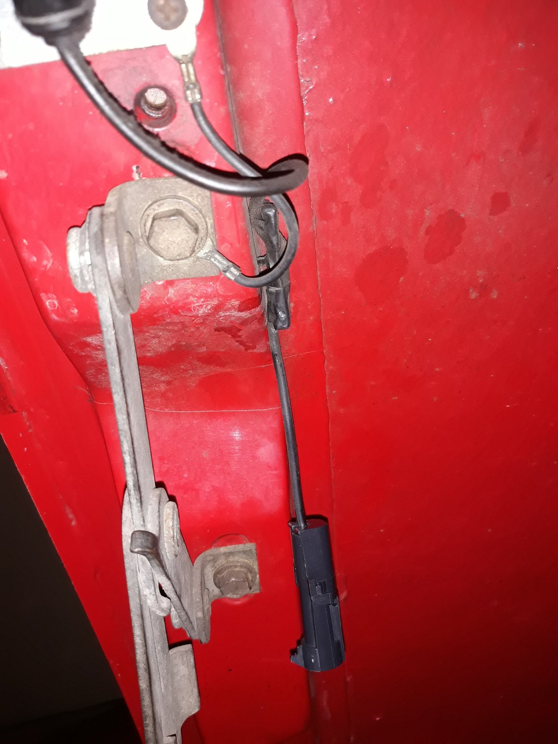

OK. Are we talking about these bolts on the hood?
Or these???
in the first photo, the bolts that hold the support to the hood, 5/16th's by 18 thread.
In the second photo, the bolts that hold the hinge to the hood, 5/16th's by 18 thread.
Not sure what your looking at.
These bolts take a 1/2 inch wrench.

ok, your basic 75 hood hinge mounting point. top view.
second pic is 5/16-18 threaded in by hand and 1/4 20 slid right thru. Hood was previously trashed. I did not cut it up to prove a point. the plate is riveted in before top and bottom of hod are joined. if yours is 1/4-20, somebody got real creative with helicoils. bolt size mixup. 1/4 takes 7/16 wrench. 5/16 takes 1/2 wrench. 3/8 takes 9/16 wrench. and people who haven't been handling bolts all their lives call em by the wrench size.
