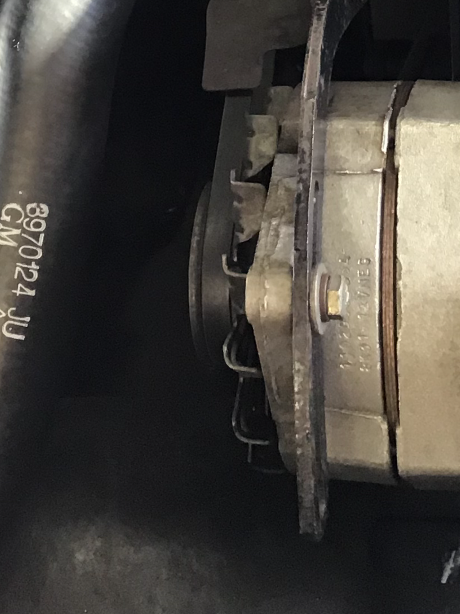

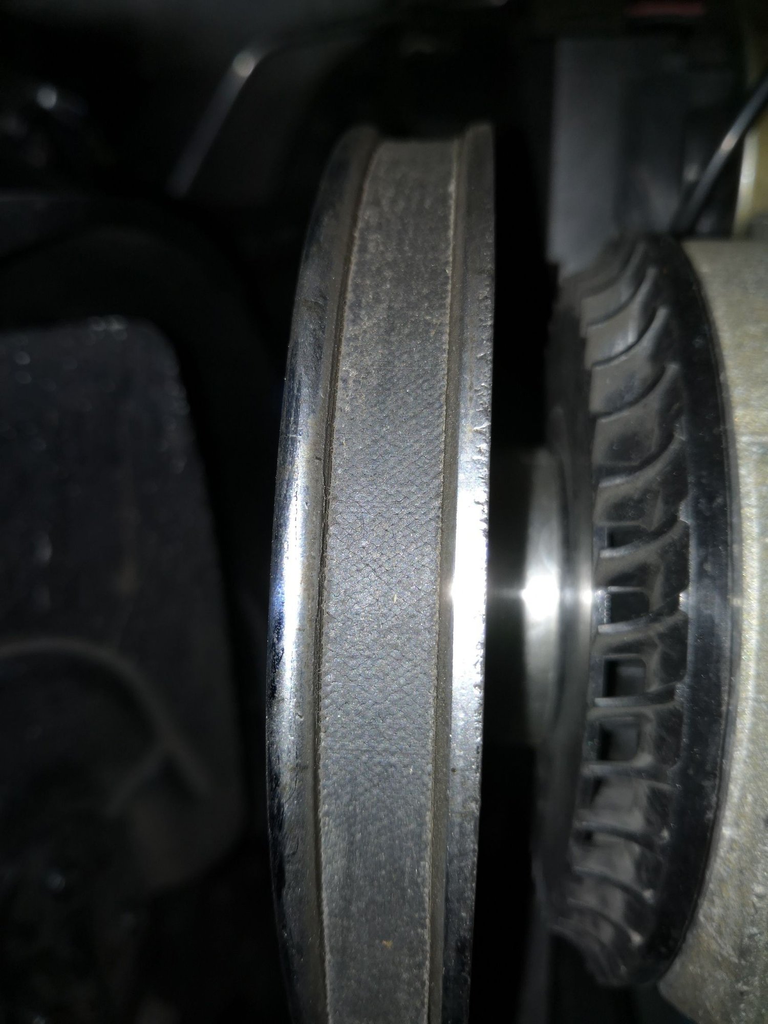

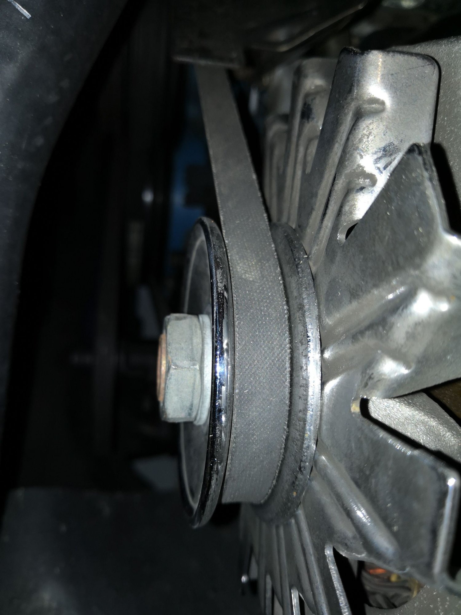

On my 1982 I have two v-belts showing signs of wear on their bottom. I both cases the reason is quite obvious as they are too narrow and therefore ride lower in the pulley grove instead of their top being on the same level as pulley grove side wall tops.
A.I.R. pump belt
Generator belt
I have seen many discussions on replacement belt dimensions, but people always complain about the length fit only. I live in Switzerland and my only option is to place internet order in US, i.e. I cannot walk to a shop and see what is available. Even worse, internet shops for Corvette pars rarely indicate the dimensions of the specific belts they offer.
GM specifications offer no solution. Two of my “problem” belts as described above are the ones for Crank Shaft/Water Pump/Generator and A.I.R. Pump/Water Pump, but according to GM specifications both have correct width of 7/16” and 3/8” respectively.
More specific, for AIR Pump/Water Pump GM indicates dimensions of 31.5” x 3/8” and on the existing belt it says GM 9433613 0.38 x 31.5. So the belt is “correct”, but is too narrow and rides deep in the pulleys grove!
Any idea where this strange situation comes from and how and where to get the belts that fit on the pulleys the way they should?

V-belts wear on the sides of the V. You may just have old, worn belts.
Since you're in a metric market, a 10mm x 800mm belt should be available to replace the 3/8" x 31.5" belt. That will be about 0.5mm (0.020") wider, which might help.
For the 7/16" belt, you could try a 12mm belt. Just convert the length to mm and find something as close as possible. The 12mm wide belt will be about 0.9mm (0.036") wider than the 7/16 belt.
