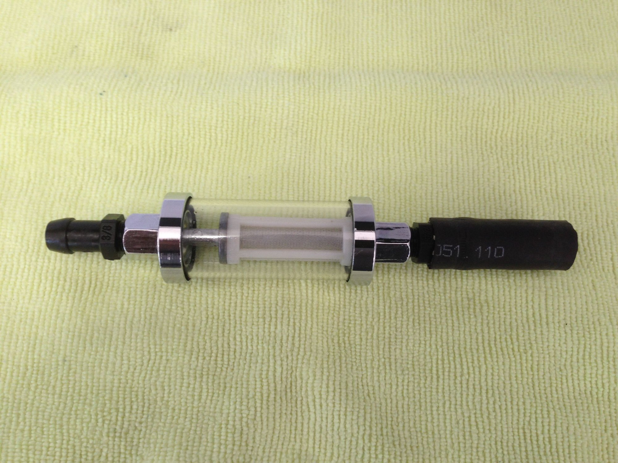

This is usually the problem. If you use cheap aftermarket valve covers with no baffles at the PCV port you can go from burning a quart of oil every 4000 miles to burning one in 400. If you want to check, just install one of those cheap clear plastic or glass inline fuel filters in the pcv line between the carb and valve cover to see how much oil is going through there.
I like that idea.

Originally Posted by 69427
I like that idea.
There are 64 tablespoons in a quart. If you drive 10 test miles and have a tablespoon in the inline filter it would mean you are burning a quart every 640 miles just through the PCV. A very cheap way to rule out valve seals, rings or anything else. My "tester" is below. Plug it into the carb and the PVC line on the other end and go for a drive. A really bad fuel filter but great for this and you can unscrew it, clean it out and use it again.

worlds smallest puke can... oh where did you get that? i need a couple of those elements for my seadoos.
You can buy them on fleabay all day long for about 5 bucks each delivered. Very dangerous as a fuel filter as the threads on the cast connecting rod inside strip out or the end seals start to leak but good for this. input "inline glass fuel filter"
