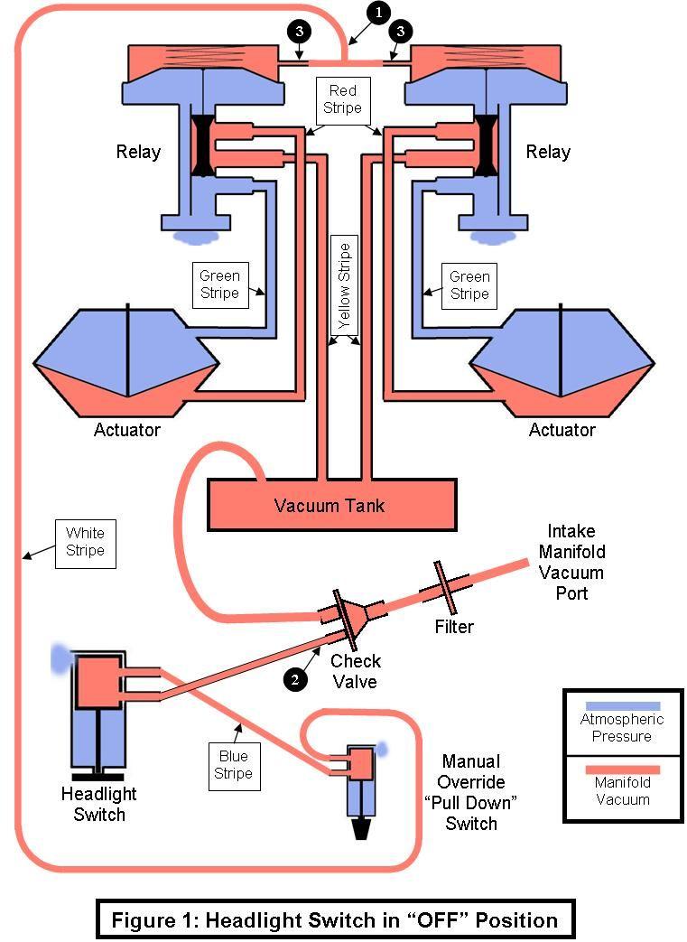

So on the white hose goiing to the relays, seperate the systems at the T and see if they both pop open. Then reattach one side at a time and plug the other hose and cycle your headlight switch to see what happens. Releasing the vacuum from the switch opens the doors, giving vacuum closes them. If the cause is on only one side you'll see which side it is
you can see here that when you introduce atmospheric pressure to hoses 3, the spring pushes the actuators towards the blue side which changes which side of the actuator sees vacuum.
So most likely either the relay isnt releasing the vacuum and internnal valve to get the relay to transfer the vacuum or the relay is leaking too much vacuum before it has a chance to transfer the vacuum inside the actuator. Doesnt really matter if you can get one side working, then you'll be able to figure out the other. Trust me and try one side at a time and you'll see what is up. Could be multiple leaks on both side as well. (the actuator and the relay)
