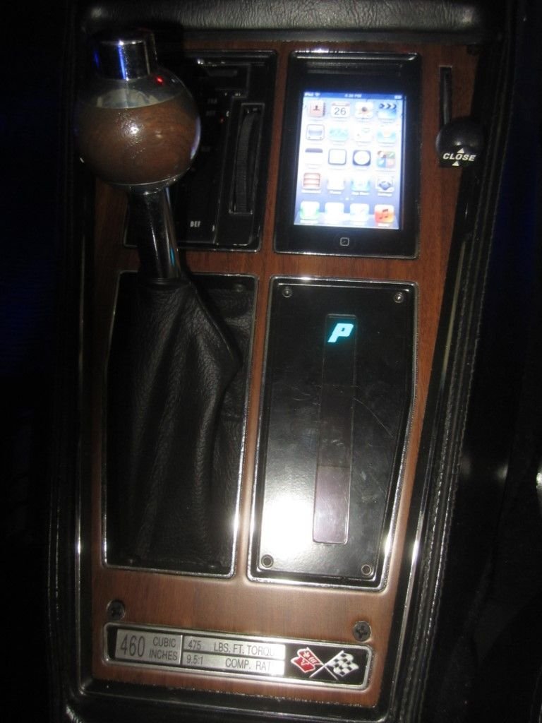

Any good ideas on how to paint "restore" the lower, shifter console? Where the ash tray is. 1968

Clean clean and clean it again. I like to remove all of the old paint, sometimes hard to get in around the "grain" texture
On chrome, use a really good primer. I like a self etching primer and quickly wipe it from the chrome edges that will show (but honestly I'm not sure the etching actually harms the chrome on those small edges enough to be seen)
On the shift console I will mask off the outer edges since they are easy
Paint with several light coats of semi-gloss. Past few years I've been using blitz-black john deere
Once dry or at least set, carefully wipe off the other chrome edges with a cloth wet with lacquer thinner tightly wrapped around a gloved finder or pop-sickle stick
Let it dry completely before handling it anymore
Then go ahead and cover it up with the deluxe wood grain insert
Just kidding

Nice custom spec. plate.
Thanks, took a bit to find the right font and layout but it turned out pretty good for a sticker
M

Mine is a 1968 without wood grain. Does the leather shifter cone come off easy? Also, would pinstriping tape work to cover up the small chrome lines?

I was just joking about the wood piece
The leather boot (at least on the later ones, the 69/69 could be different) has a metal "ring" that holds it to the plate, you should be able to see 4 small screws, 2 at the front, 2 at the rear
I've not had a tonne of luck with the masking of really thin edges, just seems there's not enough surface for the tape to really grab and stay on, next thing is part way through it half falls off and I need to clean the paint off anyway sp....
But that's just me
M

better picture
M
