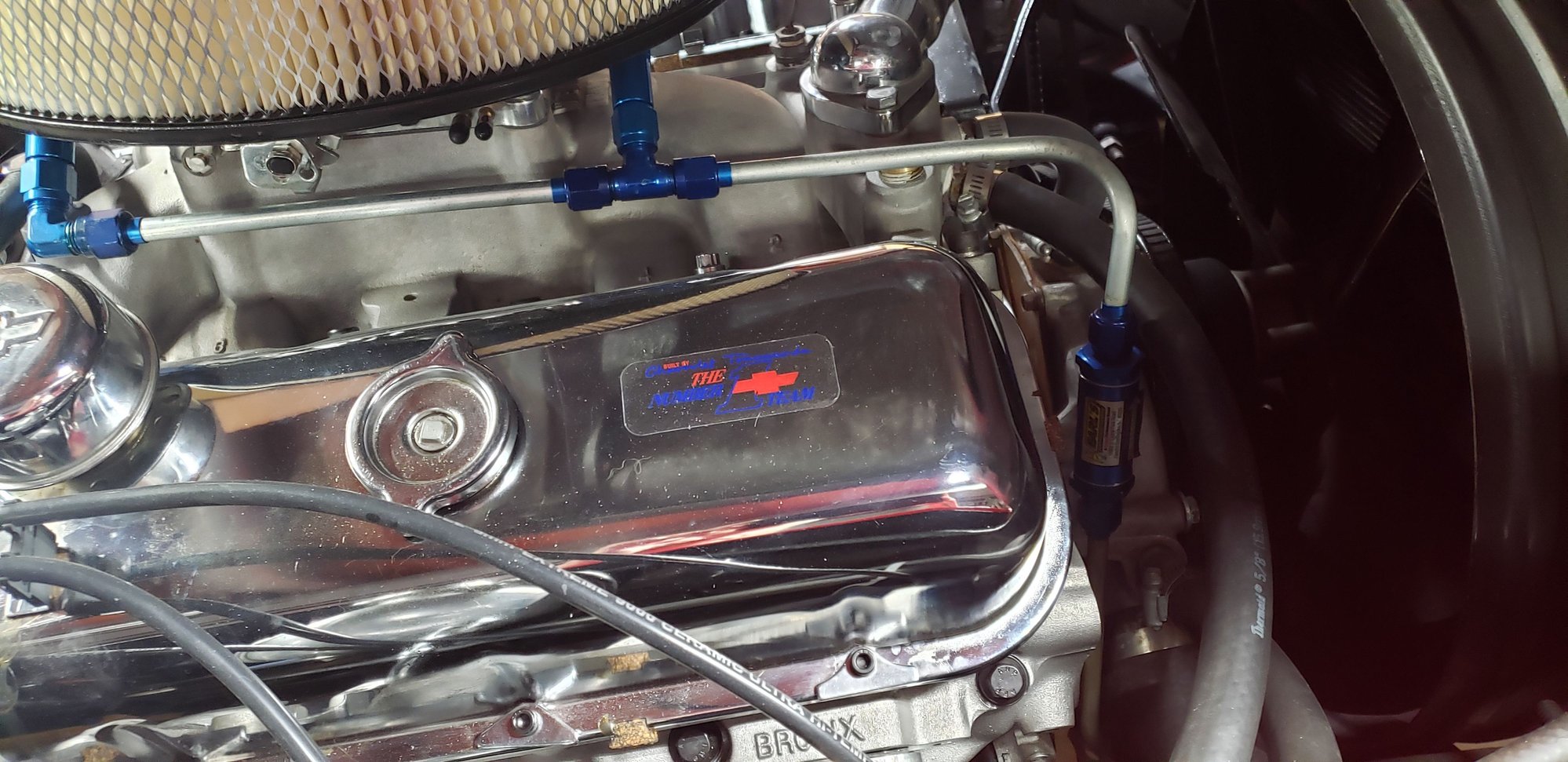

I ran my '73 with a similar setup for 10 years without issue. New engine will have the filter mounted on the frame as I'll be feeding the fuel rails from the back.

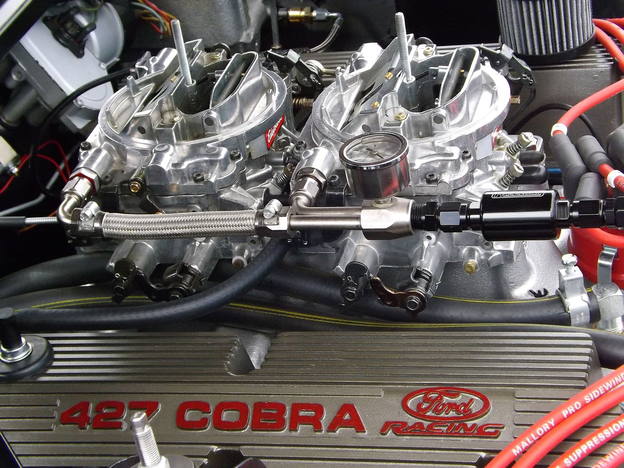

DC3's all solid line setup is super clean and safe. But if you don't want to bend pipe why not just use a braided stainless steel hose with AN fittings? Still super clean, safe AND flexible, like the photo of my Fairlane's fuel line below. And if that is a glass filter canister, I wouldn't. They break too easily.

ok, the big loop of steel line. is the air stream from the fans gonna cool the fuel, or heat it as it has already gone thru the radiator?
I would think insulating the fuel line is the best way-
But I doubt in the real world you'd notice a difference- except maybe solving a vapor lock issue-
Then it really doesn't matter where it is in the fan's air stream.....because there's no stream.

no, i meant DC3's fuel line which is similar to what Big Bird is gonna have. your braided is a pretty good insulator.
Didn't appear to matter in my case. Never had an issue of any kind due to the way I plumbed the filter/fuel line over the 10 years or so I ran it that way.

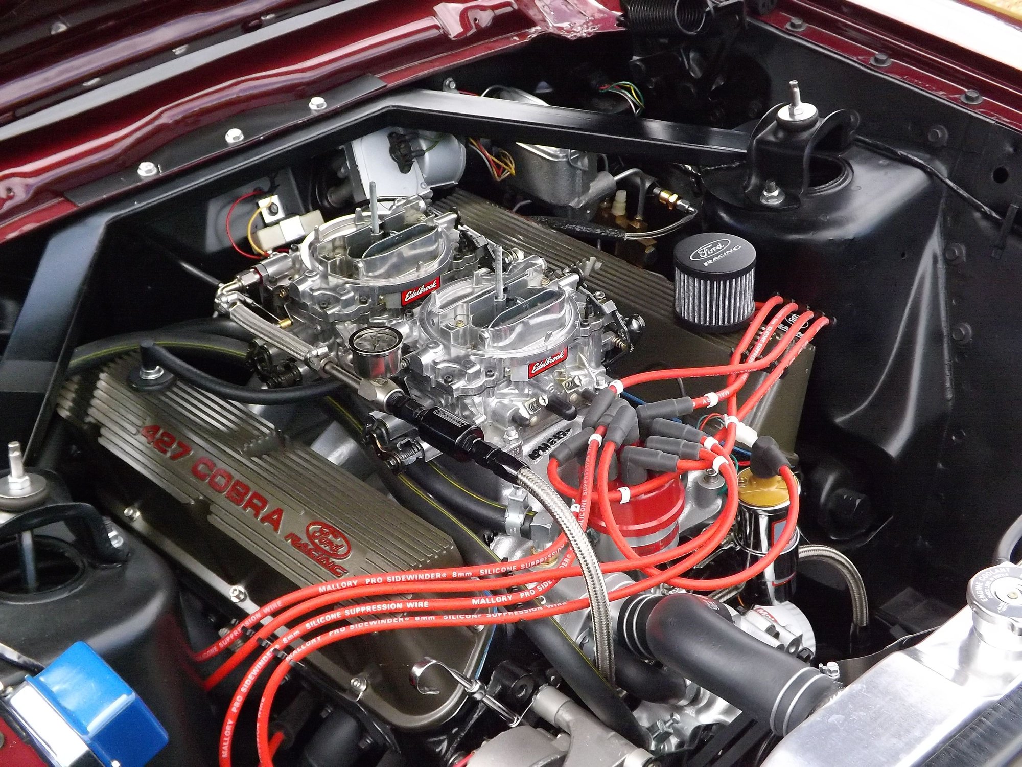

My version of the fuel delivery to the carb. Granted, different carb, and a bunch more cubic inches.
DC
That filter caught my eye. Is that an adapter at the outlet? It looks like you've solved a problem that has puzzled me for a while. Thanks.
