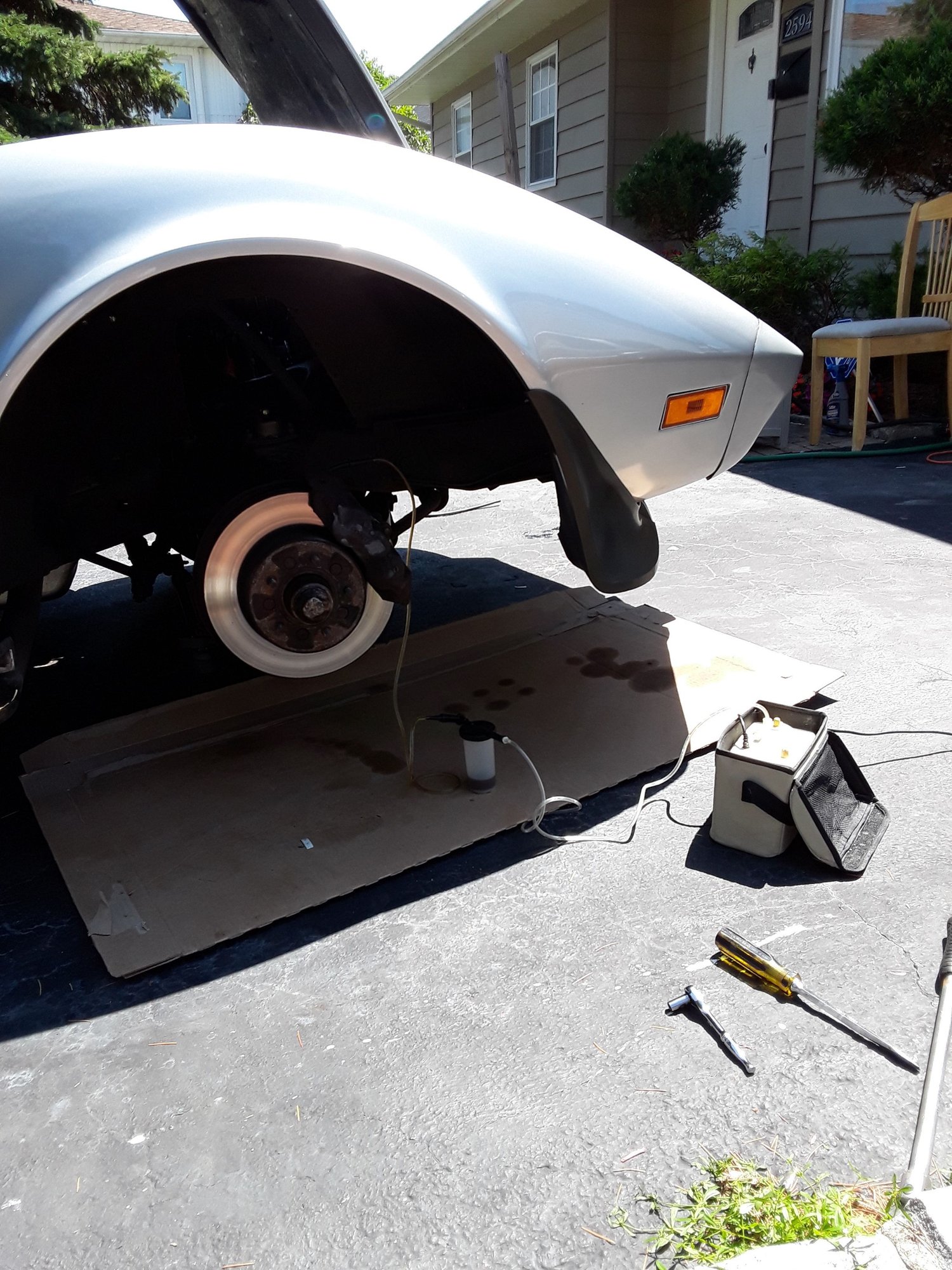

Old Jul 3, 2020 | 08:48 PM

Old Jul 3, 2020 | 09:14 PM
  #35
Big Block Dave's Avatar
Big Block Dave
Joined: Jun 2010
Posts: 1,165
Likes: 93
From: Bellmore NY
And now that I figured out the whole picture thing...
