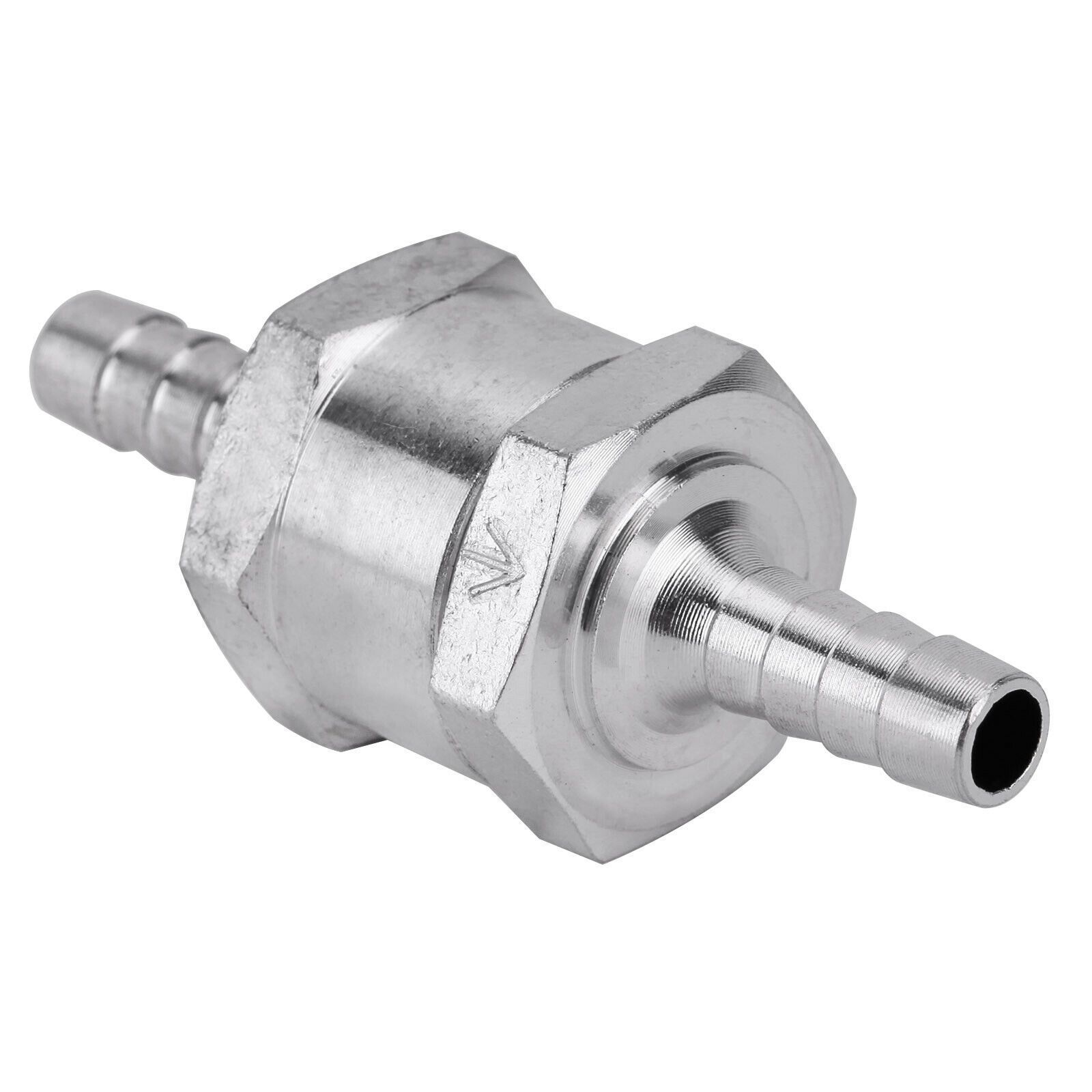

Originally Posted by planet-automobile
I am thinking of installing it too
This may work, but if you obtain one of these, you may get the same result, without the need to compromise your original fuel line too.
You may be able to find it locally, but if not here's a link...
Good luck... GUSTO

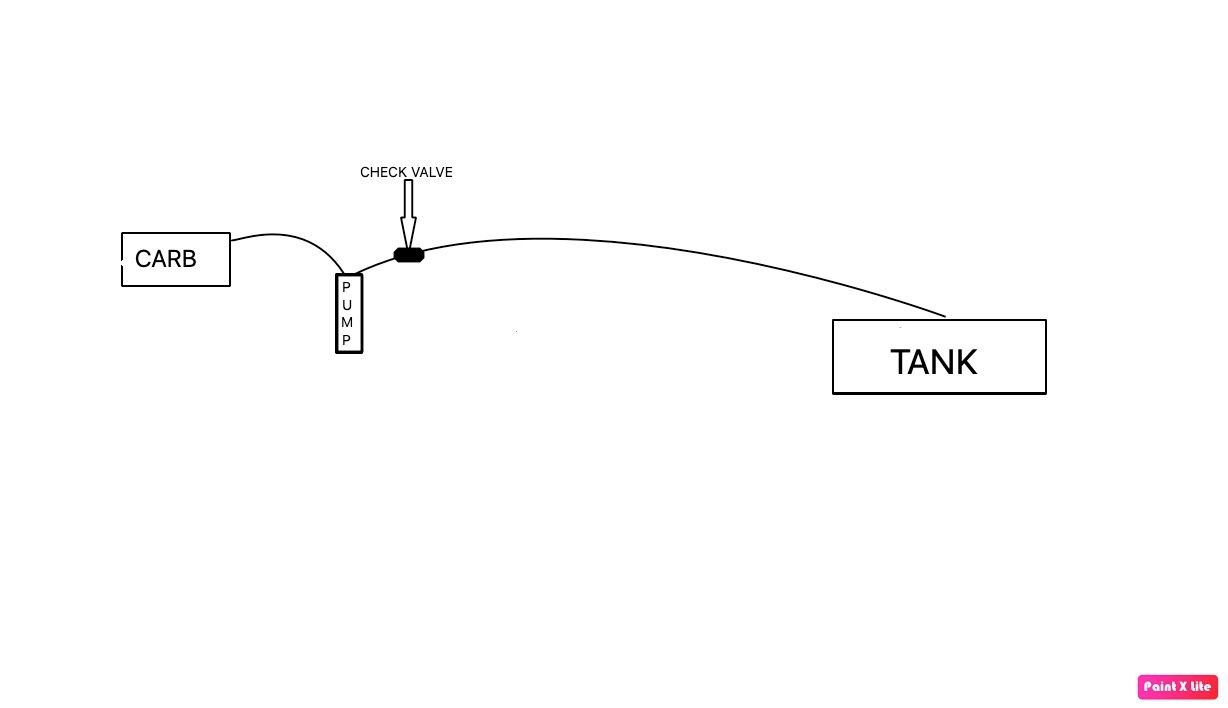

To Start
Old Jul 3, 2020 | 11:01 AM
planet-automobile's Avatar
planet-automobile
Joined: Mar 2018
Posts: 175
Likes: 5
From: France
Old Jul 3, 2020 | 11:43 AM
